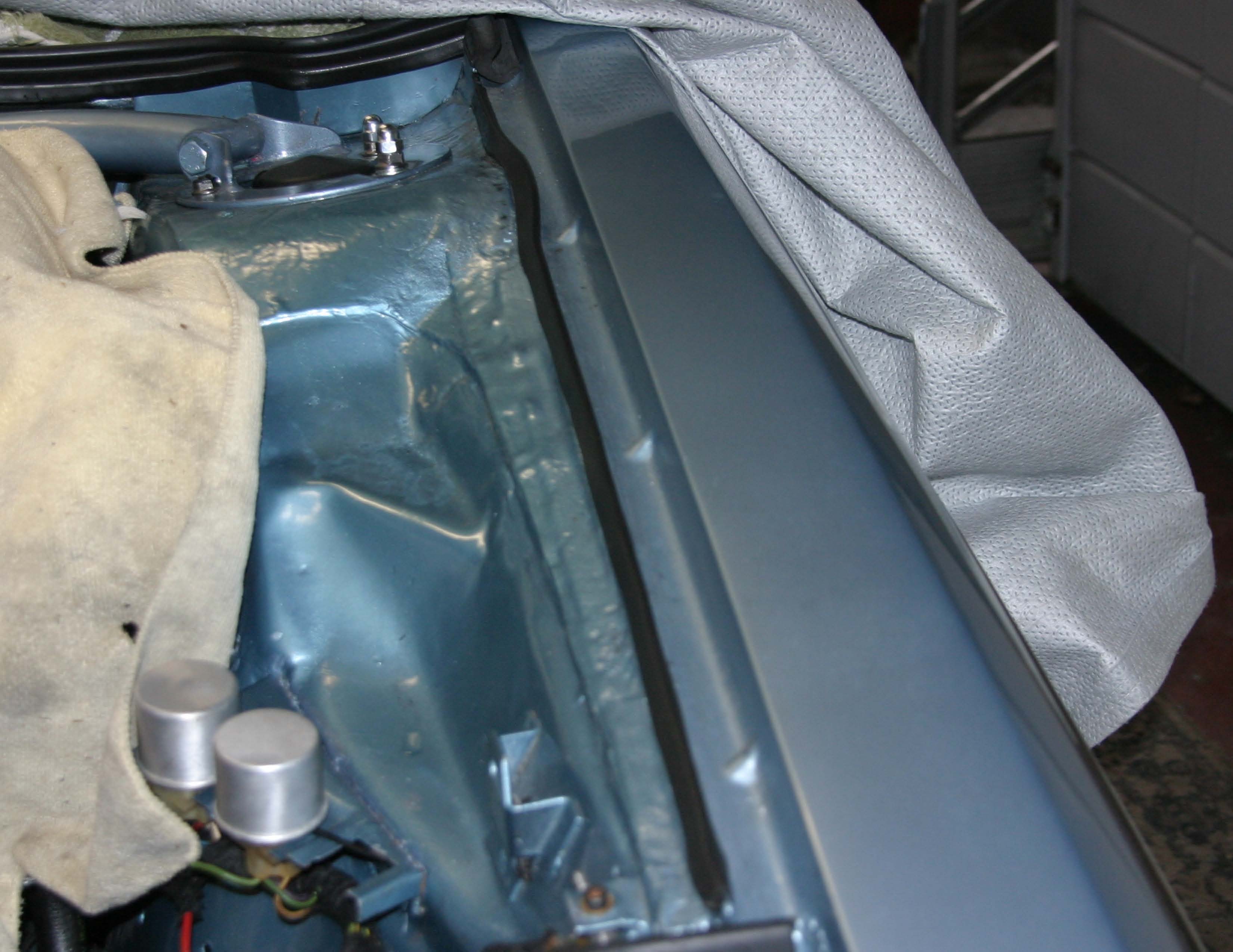

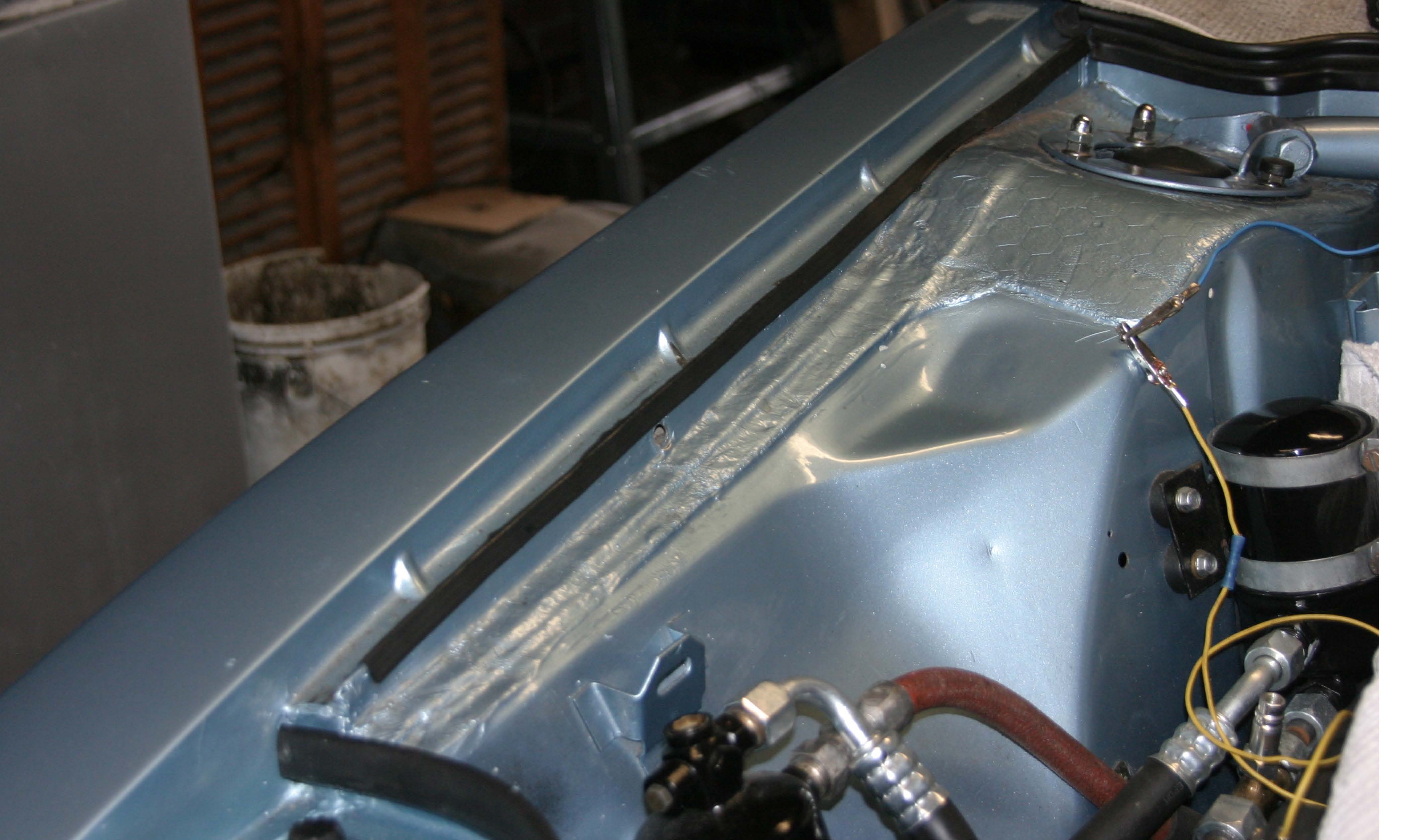

why do you think bmw didnt provide a rubber strip
for the exposed fender /infender top seam.
i added a v piece left over from my orders
it sure looks better there.

Oh, there....Indeed there is another gap.
I've Always found the layout of the fender sheet metal parts quite complex .... So:
Stuck on top of the inner fender, but not het edge of the gutter of the inner fender, in the area where you actually can't see it , even with the hood open? The top of the rubber would then touch the underside of the outer fender.
Is that about the right description for your thoughts, Alan?
I would be fearfull of the rubber getting coated with sand and then abrading the coating of the underside of the outer fender. There is bound to be some vibration.

here.
i think ill paint them the color of the cae
to blend in.
