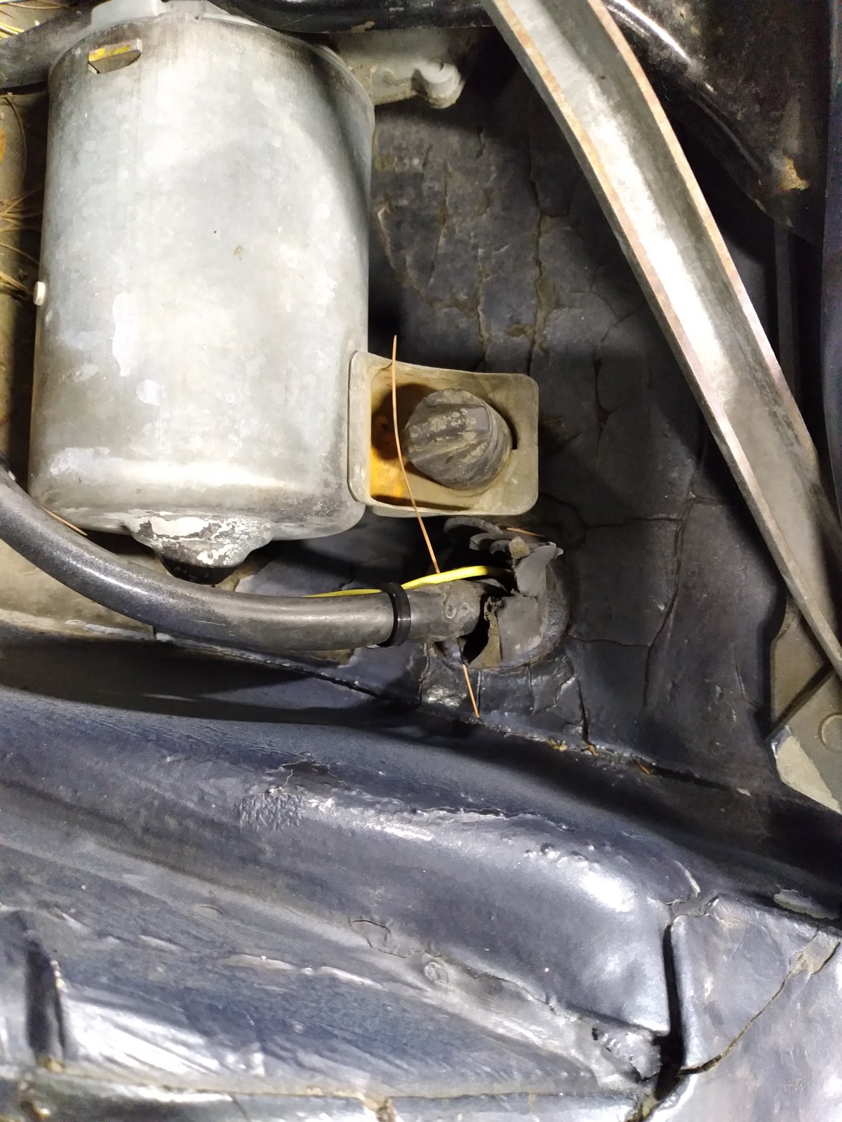

Looking for this part, I cannot seem to find a part number
H houseofdiesel Member Messages 21 Reaction score 0 Location Kemptville, Ontario, Canada Jan 10, 2021 #1 Looking for this part, I cannot seem to find a part number
HB Chris Well-Known Member Site Donor $$ Messages 19,418 Reaction score 8,776 Location Huntington Beach, CA Jan 10, 2021 #2 They were part of the harness so there is no part number available unfortunately.
Cornishman Well-Known Member Site Donor Messages 713 Reaction score 166 Location Essex, UK Jan 11, 2021 #3 Black tape carefully wrapped around it to tidy it up.
S stphers Well-Known Member Messages 1,156 Reaction score 586 Location Port Moody, BC ( near Vancouver, BC ) Jan 11, 2021 #4 One from a 2002 might work from W & N Catalog picture / Position no. 61/08/07 A61131350914 + more details and images series: BMW 1502 - 2002 turbo Rubber ring for headlight-wire protection you need 2 for 1 car Your price:€3.50Incl. VAT + Shipping Thanks, Rick

Stevehose Well-Known Member Site Donor $$ Messages 13,399 Reaction score 6,201 Location Sarasota, FL Jan 11, 2021 #5 If you're desparate you can slice lengthwise an appropriate length of black silicone vacuum tube , then install it on the hole edge, and trim to fit.

m5bb Well-Known Member Site Donor $ Messages 2,086 Reaction score 920 Location Peachtree Corners, GA Jan 11, 2021 #6 You would have to split this but 358 degrees would look good. Raychem Boots You might also look on McMaster Carr. Good luck, a difficult problem with no easy solution.

Krzysztof Well-Known Member Site Donor Messages 1,812 Reaction score 884 Location Poland Jan 11, 2021 #7 There are China-made rubber grommet kits (cheap version). Diking 170Pcs Rubber Grommet Kits Firewall Hole Plug Set Electrical Wire Gasket Set For Wire Plug and Cable Diking 170Pcs Rubber Grommet Kits Firewall Hole Plug Set Electrical Wire Gasket Set For Wire Plug and Cable www.ikinchlaw.com Old wiring from any car typically has few. I would propose genuine BMW one - new or reuse.

m5bb Well-Known Member Site Donor $ Messages 2,086 Reaction score 920 Location Peachtree Corners, GA Jan 12, 2021 #8 Here are some more possibilities. Grommets | Classic Car | Steele Rubber Products Steele Rubber Products has the best quality grommets for your classic car restoration. www.steelerubber.com
