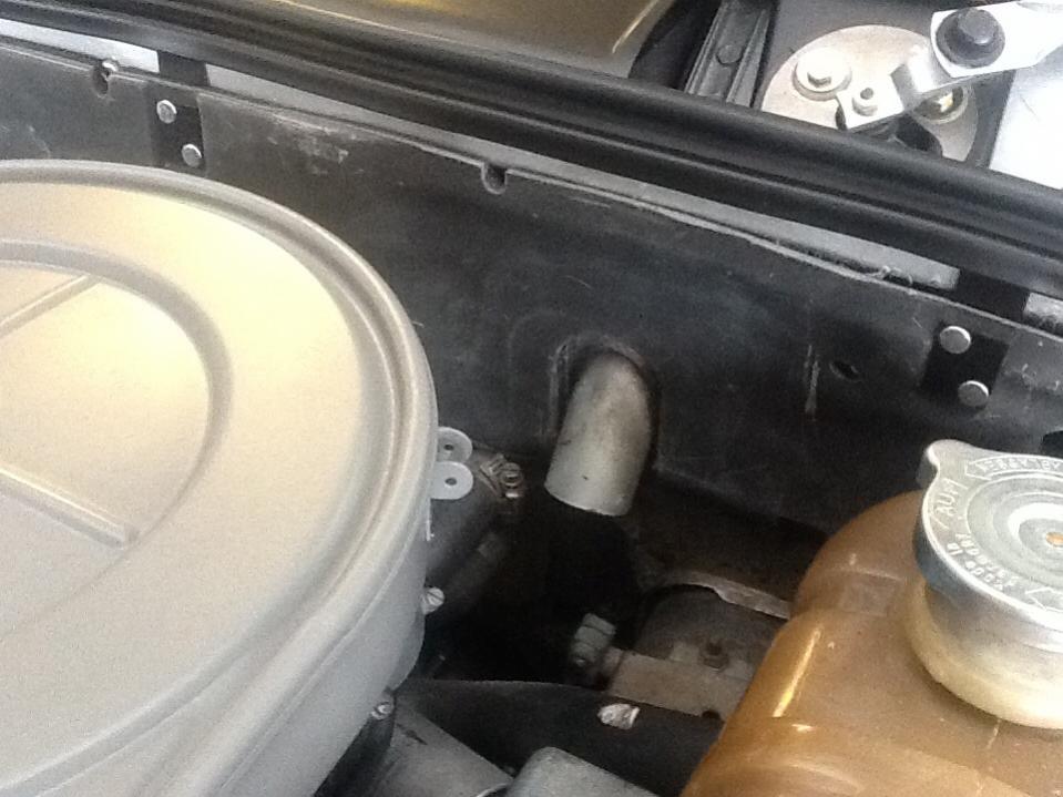

These get discussed frequently so I thought I would post two photos of this part, number 51 48 1 810 724. They are now a dark chalkboard grey color without any texture. I can only upload one photo at a time from my iPad.
Here is the one I bought 7 years ago, it is a black color with a pronounced texture like a very small checkerboard. BMW obviously switches suppliers and that may be why we get different looking parts over time.
I installed all three yesterday.
Like you say the top one is much lighter.

Len,
Just remove the firewall rubber seal, lift up at the clips and gently pry pad away from firewall, it has adhesive on the backside. If you still have the emission dashpots on the firewall remove them first. The new one fits around the overflow tank but removing it makes installation easier. I set it in place and then sprayed adhesive to the driver side of the pad and the firewall, let it stand five minutes, shot some more and then pressed into place. Repeat for passenger side, pretty easy.
Chris
Len,
Follow HB Chris highly correct instruction :-)
If the pad includes self adhesive tape, do not trust that will hold! Use as said some kind of good contact glue and gently press the pad towards firewall, specially at the bendings of the firewall (Note! to strong clamps could cause lasting impacts in the pad)
