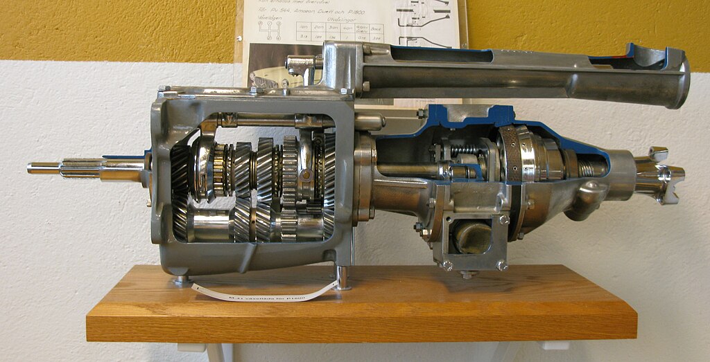

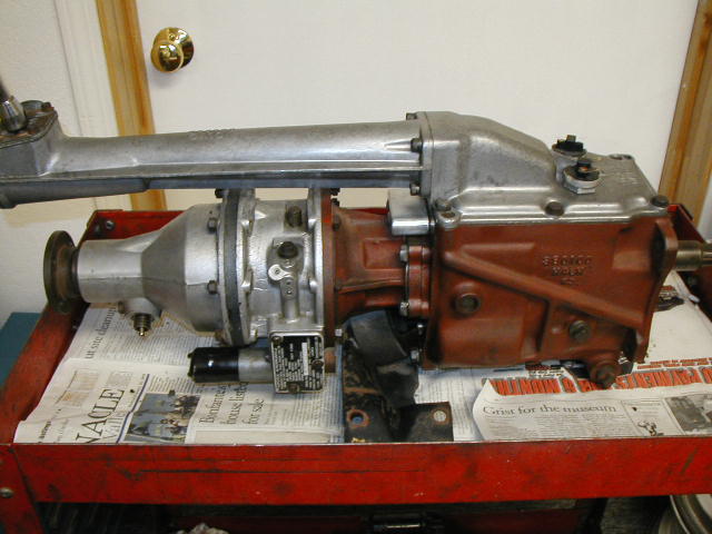

With 5-speed overdrive transmissions available, me thinks you are reinventing the wheel when trying to fit the 4-speed with an extra gear (or two). That said, external overdrives have been fitted to many cars, including the venerable Ford Model A and you could likewise conceivably adapt a Layc_ock overdrive found on Volvos and various British marques to your setup. Mind you, it would most probably involve additional weight and some drive shaft modification, reorientation of the shift lever, minor electrical work and some reshaping of the body's transmission tunnel, but other than that, some might call it a simple "bolt in." :shock::shock::|

Cutaway of trans mated to Layc_ock overdrive.
