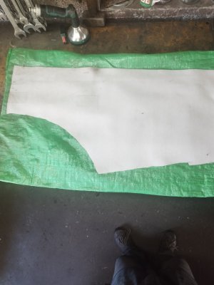

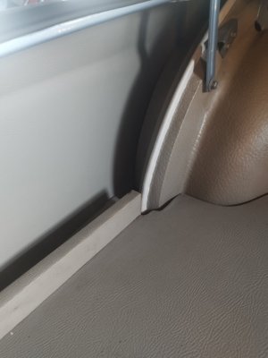

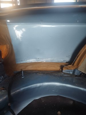

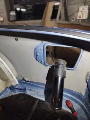

Hi All, Apologies for not responding sooner. Thank you all for your comments and suggestions. I used the 3M supper 77 adhesive spray, it worked very well and was easy to use. I covered the complete panel and material. The photos show the result. Again many thanks. Seán.
