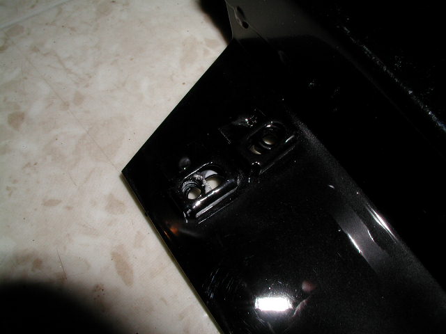

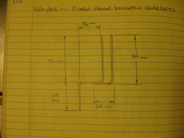

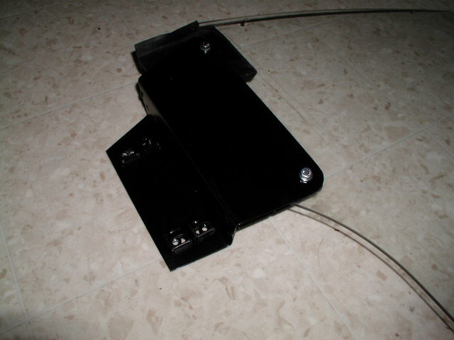

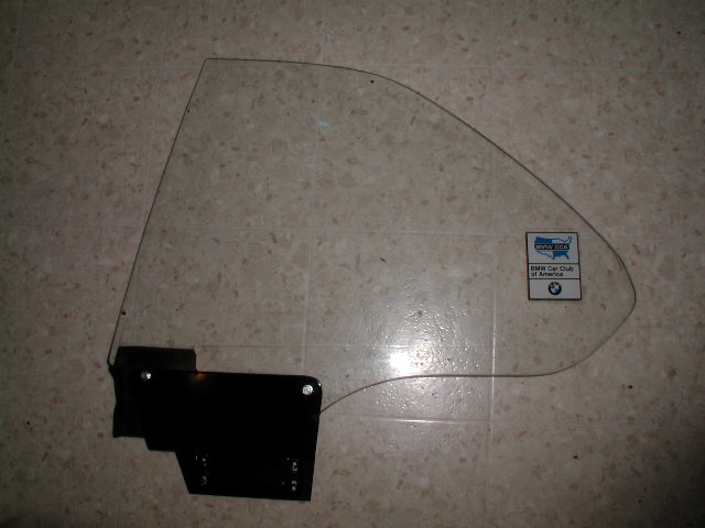

It looks like Gerrit does a first rate job. Those seats are beautiful. I reconstructed the brackets from my 2.5CS, which had almost completely disintegrated. I wish I had documented this a little better, but this was all I could find from my notes:
Making the captures for the nuts was a PITA. You might be able to pick off the relative hole locations from the electric window regulators.
