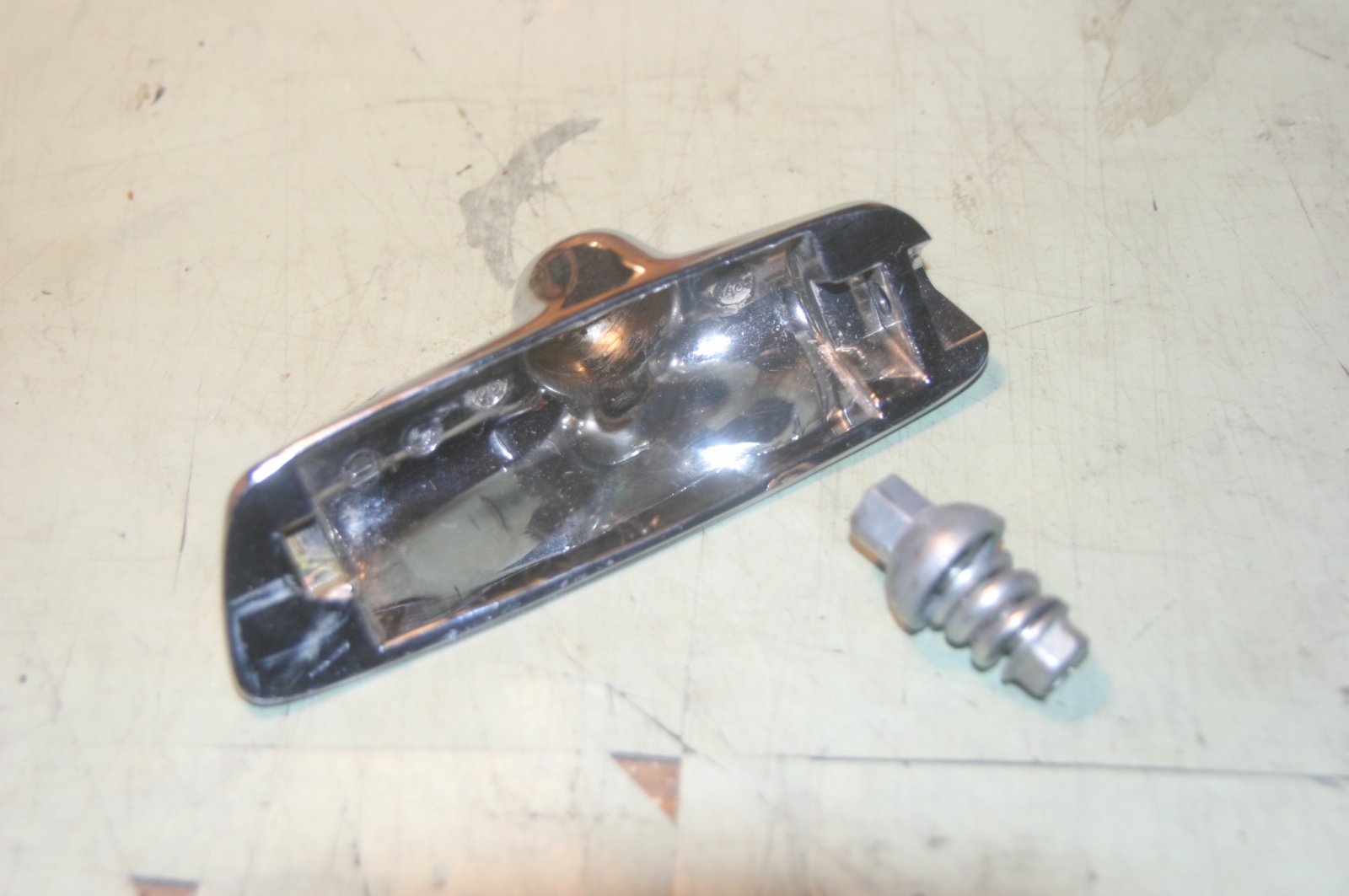

Hi guys; the mirror frame portion of my flag mirror has a little bit of up and down play relative to the stem that supports it. Is there a fastener in there that can be tightened? The mirror would have to come out which likely means a replacement seal which is nowhere to be found although other manufacturers make period mirror seals that may fit.

Yes there is a bolt that I think can be tightened. See pic. Also check the tightness of the 2 screws that hold the mounting bar to the door. Jaymic has seals:

Thanks Steve; So that big bolt I see going into the stem is what holds the “flag” itself to the stem/flagpole? Seem unintuitive that it can do that from that position.
My base is tight and firm against the door sheet metal. Not familiar w those nuts; what wrench do you use?

yes you can bmw actually sells the seal new
also there is a half round donut inside thats sets the mirror from moving around
maybe yours is missing and a spring

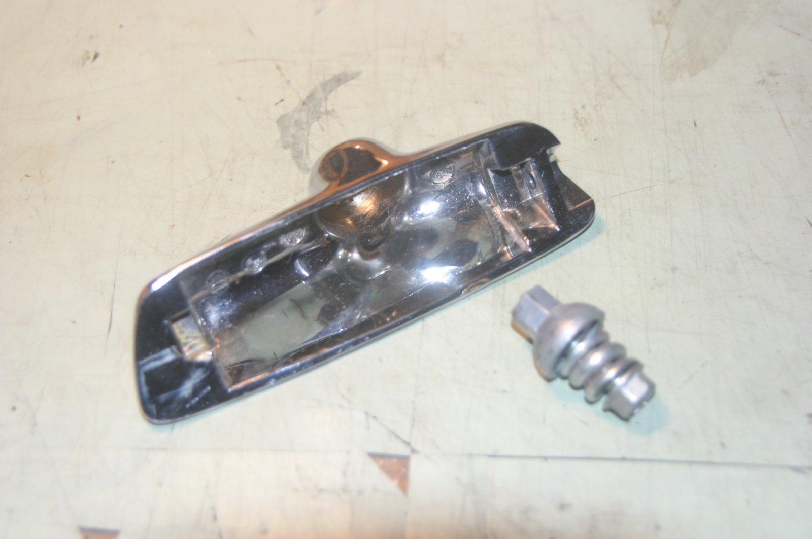

So took off my mirror and found a August 1985 date code within it... So I guess it's not original to the car. That side of the car was repainted in Germany by 2nd owner in 1986 so makes sense she wanted to replace the 'old, out of style mirrors with the latest and greatest.
A few details of the munting and the hidden setscrew if it helps others. Also a video of the motion on the 'flag' part of the mirror. I may leave it alone for now or spring for a couple of correct flag mirrors wich seem plenty available on the interwebs.
