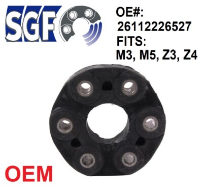

the m5 guibo is the way to go. Confirm country of origin as DE.

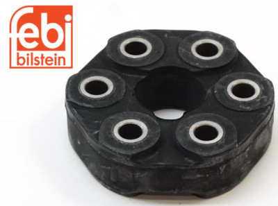

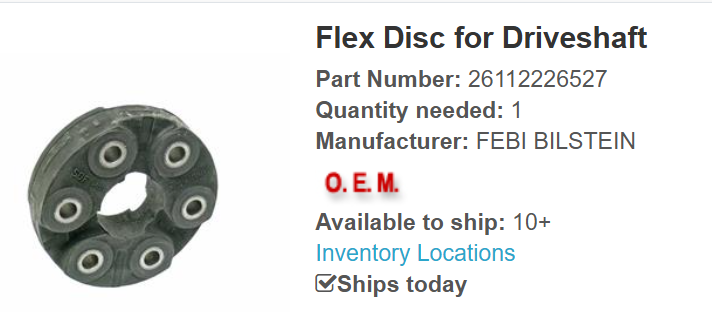

I found 2 SGF/Febi on EBay. Is this first one the M5 part? If it is 35 mm thick and the Meyle now installed is 45mm thick, how is the 10 mm taken up?
Here is another guibo for 3 series BMW made by the same mfg'r.

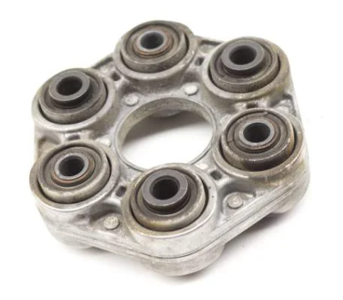

I'd seen an ad for a "race only" solid aluminum disc with PU inserts around bolt holes. Seems BMW has experimented with (and apparently decided against) an aluminum cage with coupling inserts
Attention!
An aluminium flexible disc (EGG flexible constant velocity joint) (1) can also be installed instead of the conventional rubber part flexible disc (2).
The aluminium flexible disc (1) must be replaced with a rubber part flexible disc (2)!
In-laws had one put in as part of a recall, then removed and replaced with rubber after the cage fell apart.
