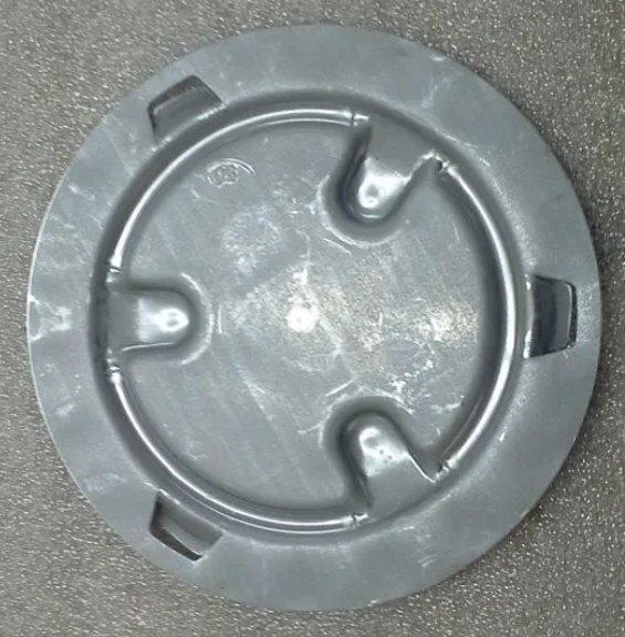

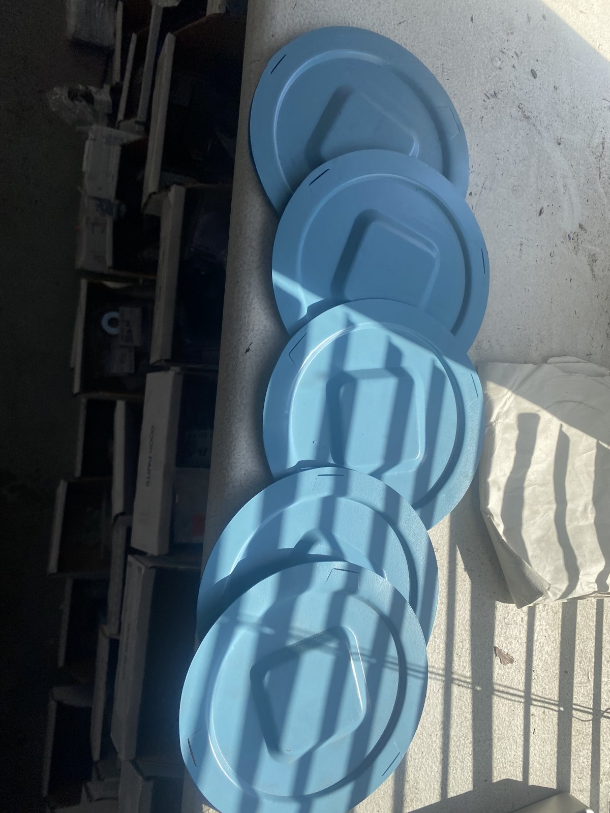

I feel we may have a thread on this somewhere, but can't find it. What/who does the most accurate floor pan repair panels for the E9? I look at W&N and their panels for the front floors don't have the swages that run back under the box section that mounts the front seats. I also hear their panel swages don't accurately align with the OEM swages and that they also don't have the removable drain plug.
