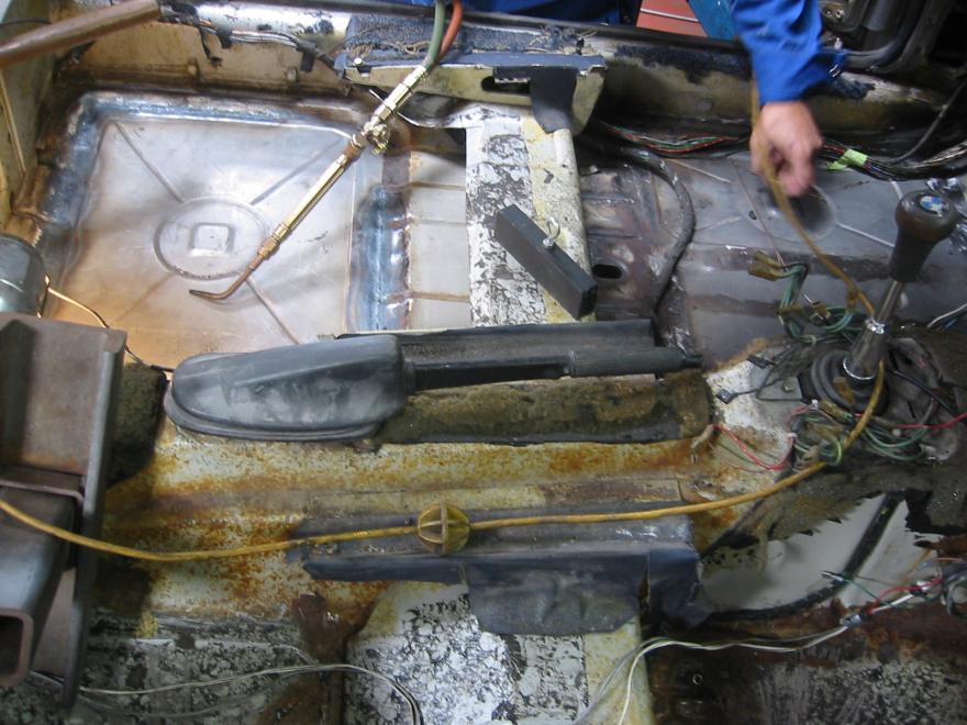

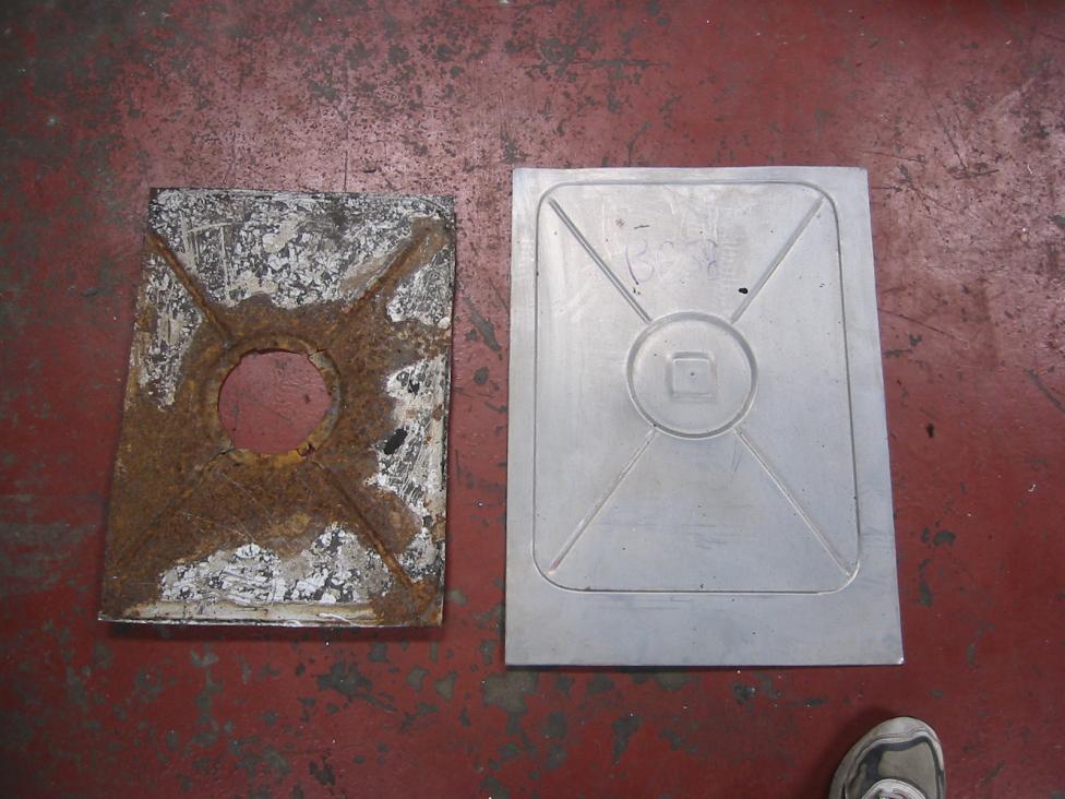

I used Mike's floor sections when I restored my e9, and they worked great. Here are a couple of photos:
