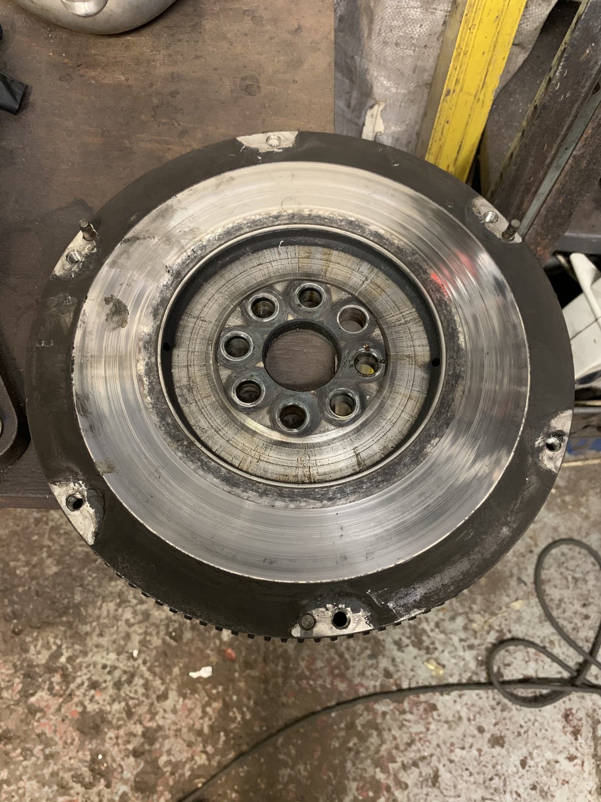

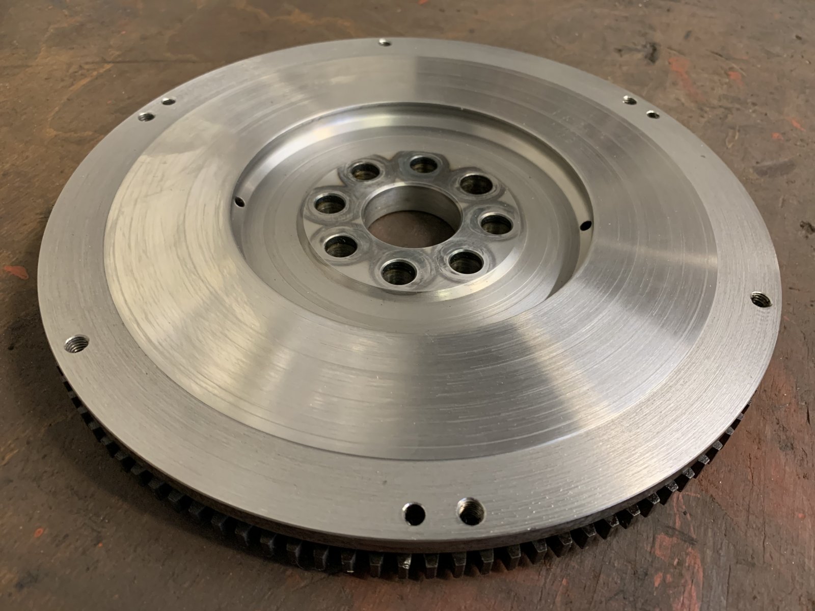

I know this thread is old but it was incredible helpful.
My flywheel looked pretty much like @Stevehose one.
just been resurfaced. Machinist also suggested only stepping down the mounting area by 0.5 mm.
before and after pictures.
That looks like it was done on a lathe instead of the usual milling machine I hope that the area that contacts the disc was machine very very smooth without any lathe marks The reason for that is that sometimes the lathe marks act like a screw and will in a manner act like a thread and will pull the contact surface one way or another depending on the lathe cuts. Only will last for a bit until the grooves are worn away Have experienced this a couple of times with frt brake rotors and too quick a machining job It caused the pads to thread themselves away from the rotor, then would bag back into place whenever you hit the brakes. Had to drive it and brake hard a bunch of times over 2 days to get rid of it but eventually did go away.
Look at the 2 pictures and you can see the difference in the machining job
Thanks, Rick
Thanks, Rick
My mechanic seems happy with it...I have to go with his advice but I’ll ask the question.
