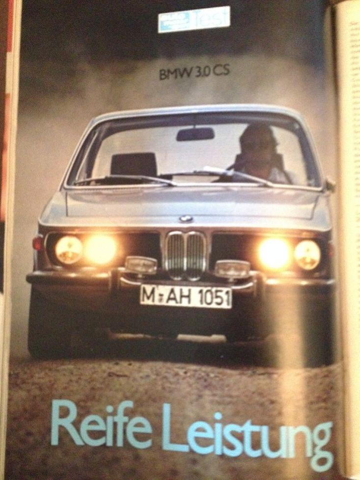

Also on the following pages there is more info on how and where to install them.
Apparently fastening supports were used. I remember the one for the top mount were still present on my Csi. Nothing however on the Cs.
Based upon the pictures I'm confident it will be a piece of cake for you to manufacture such a contraption yourself. Another project to keep you Buzzy.
thank you philippe,
apparently fog lights were supposed to be fitted on top of bumper for coupes and under them for e3´s
i would appreciate more photos from real cars if possible

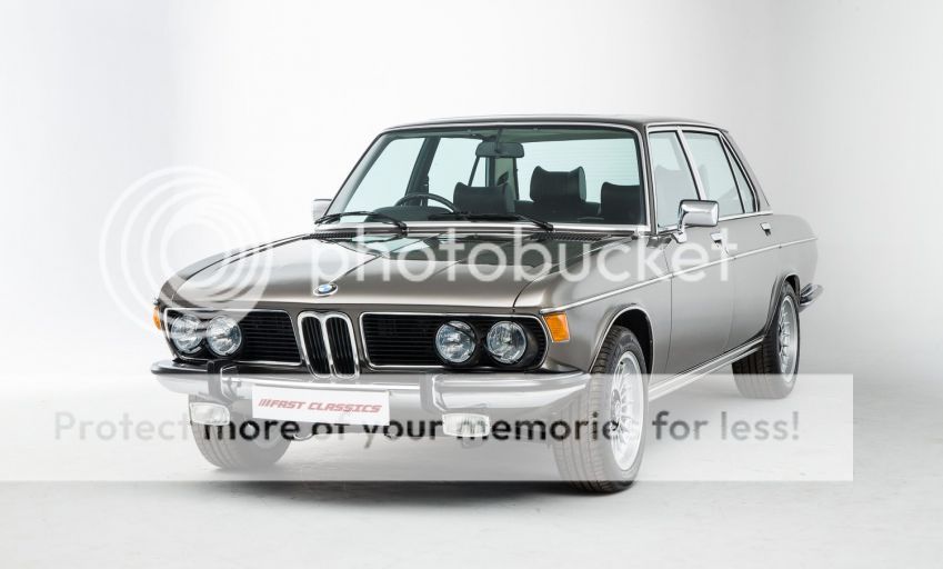

I posted a request for pics of fog lighs last year to help me decide on round or oblong and below of above. My personal choice after the straw pole was small round above.
Just doing the fitting ATM .

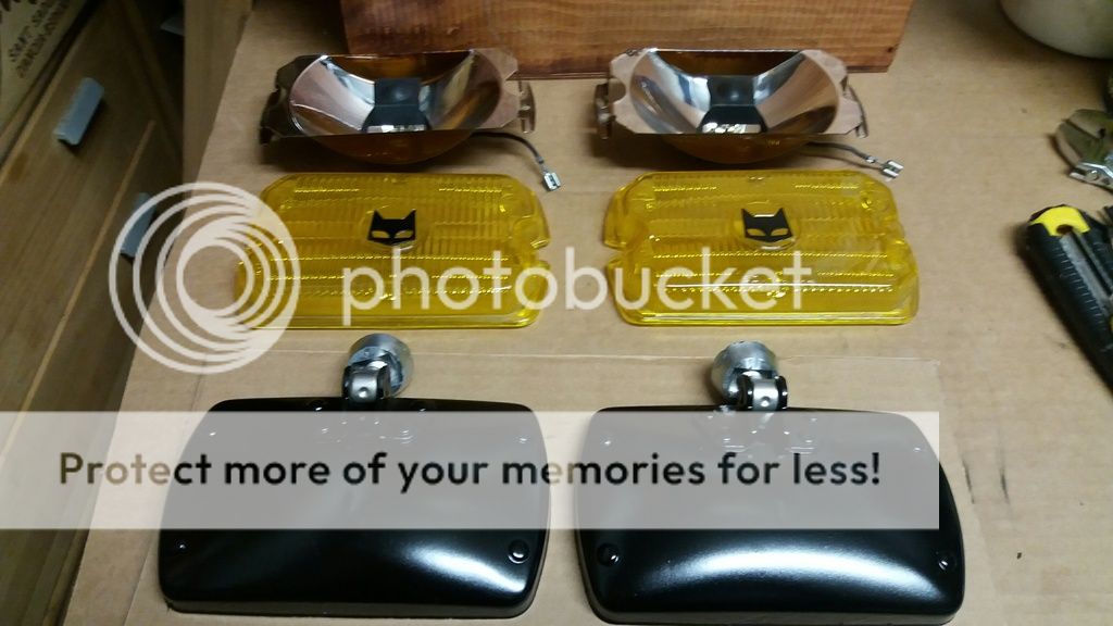

i have the oem bosch setup that came with the car
the holes were factory drilled
see if you can find the bosch option
