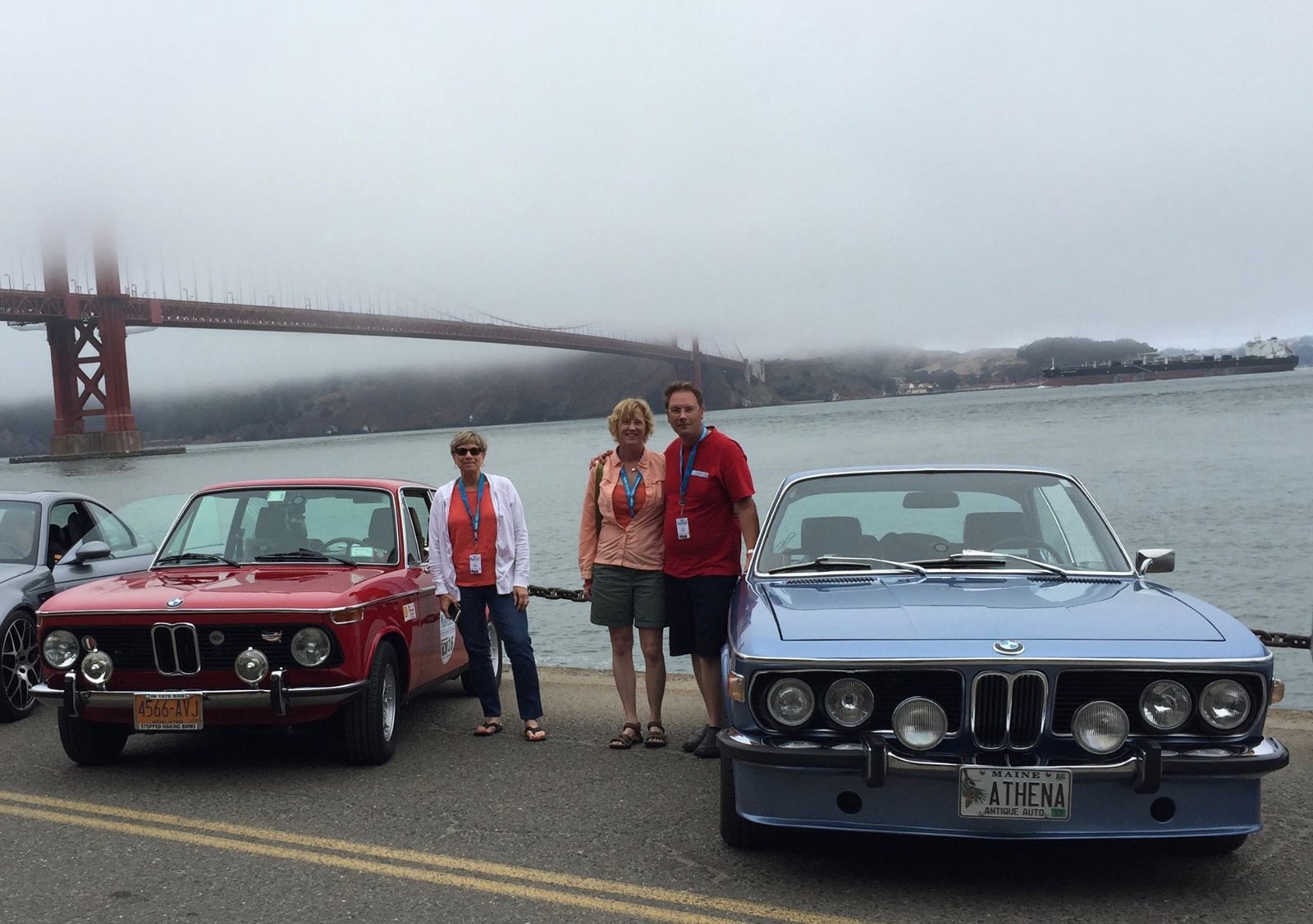

Having nice chrome bumper I wouldn't drill them but there are some holes already, right?
For sure driving lights are more useful.
Bert, the only fogs used in Ma are by the SUV owners, the ones who have no idea what's on when and zero depth perception. I actually never see anyone with a "car" that uses them here. I won't be putting them on my E9, standard on the E24 as you know (did you get the amber ones?)

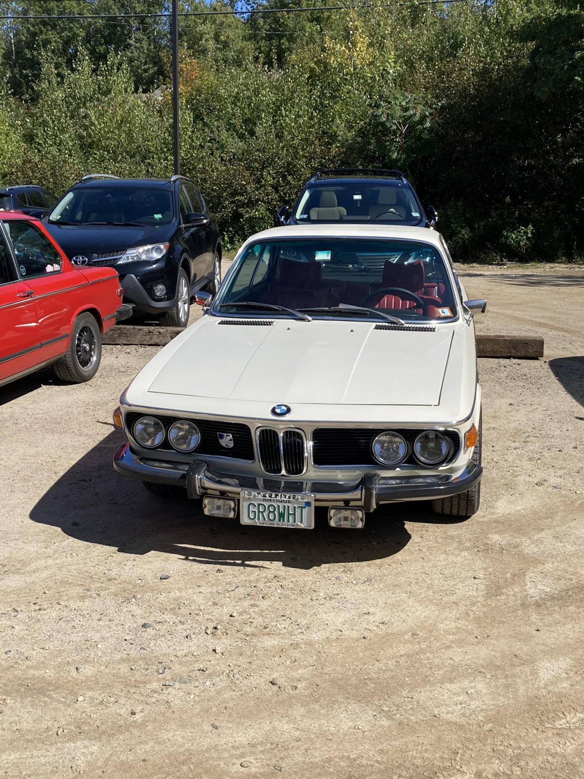

driving lights. You can never have too much light! Bumper already had holes

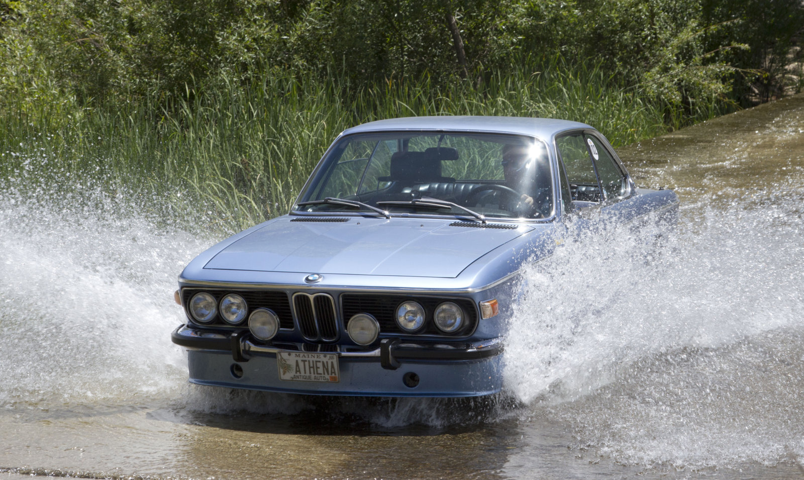

I will use under the bumper lights. I have a new pair of rectangular amber Cibies that I am not sure of using and will probably just go with original e24 under bumper lights as you picture as there is no provision in the airdam for them and that is what was on the car to begin with.. In either case, on the early euros, they mount by clamping under the bumper rather than by drilling a hole through. I am inclined to go with as original Hella clear driving lights which are still available new. I had a set of box new round Marchal driving lights that looked totally neat that I was going to mount over the bumper and figured a way to bracket them without any bumper holes but decided to not go that way and passed them on to a tii owner.

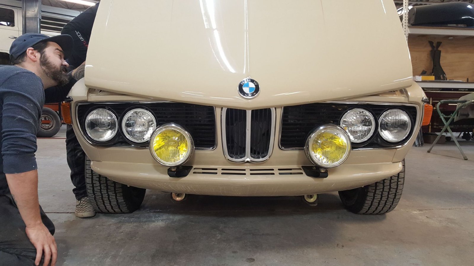

Under bumper is typically fog lights with fluted lenses, above bumper is driving lights with clear lenses, for obvious reasons. Yellow was supposed to allow the light to penetrate further into fog but that has been debunked, but it is pleasing on the eye. I have driving lights and have used them often on long trips at night, they also will get left lane idiot drifters to move over quite quickly when you flash them along with the high beams.
