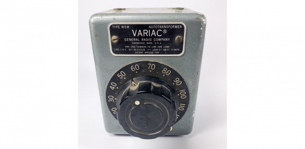

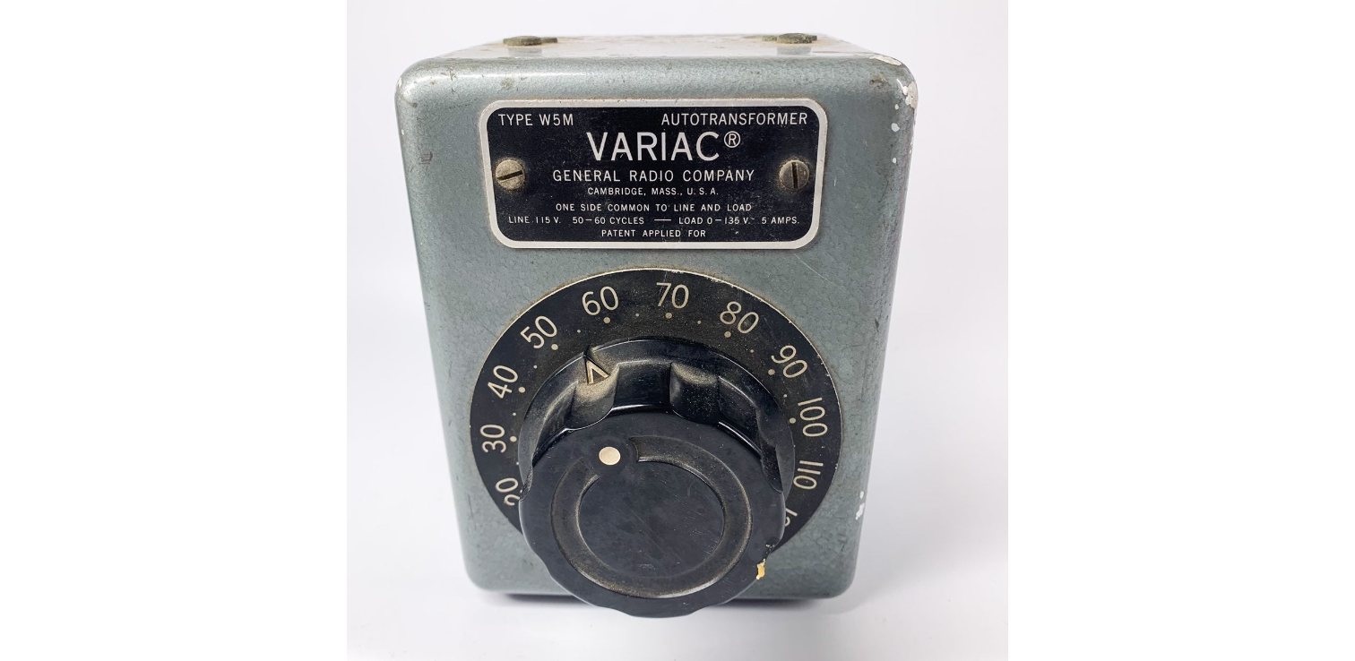

i beg your pardon, what is a variac ?
Nice fish !
It's a variable transformer. I only know the basics:
These old amplifiers have electrolitic capacitors, if the amp isn't turned on for an extended period of time they become fragile. The variac has a 110 wall socket on it, you plug the amp into the variac and you slowly (over many days) run current through the amp. Starting at a very low voltage (I start at about 10 volts) and progressively over many days bring it up to 110 (I do 10 volt increments).

oooohhh
that is super sexy
i heard about dead capacitors, never heard about the cure
question is , once you do the variac "cure", are the capacitors good enough for normal use ?
is there any turn-off time lapse known for capacitors to say that they have become dead ? or even fragile ?

Since I haven't ever replaced the caps on an amp/preamp/tuner I'm extra careful (wouldn't know how to do it). If it was my amp and I hadn't used it for say 2 years I'd bring it up. Maybe someone else can comment. If I brought something up over 4 days I'd treat it as it was good enough for normal use. If the caps failed I'd assume they were too far gone.
If anyone else can correct any of my responses, feel free. I'm not an expert, I've replaced tubes and brought them up - that's all :)
