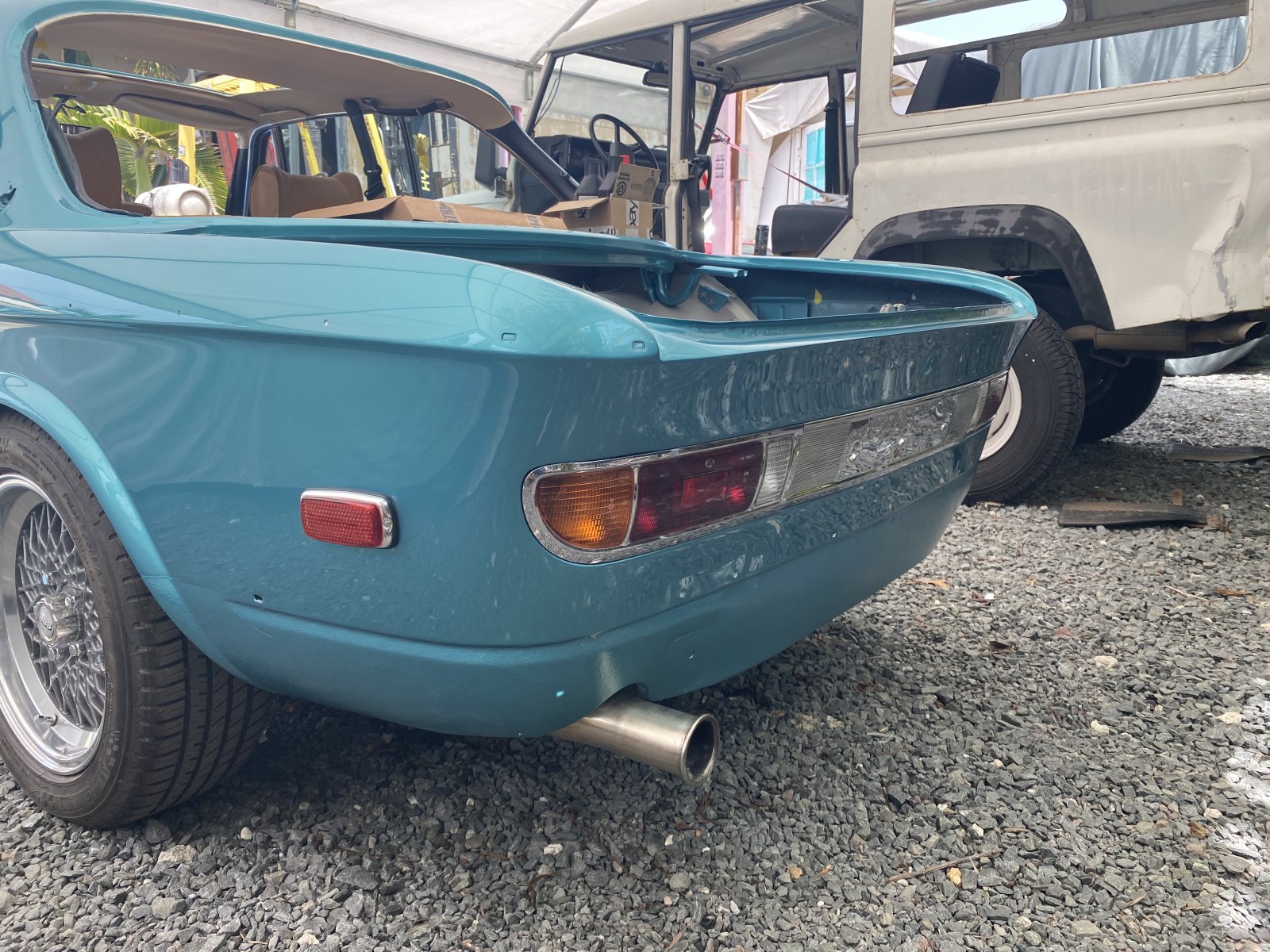

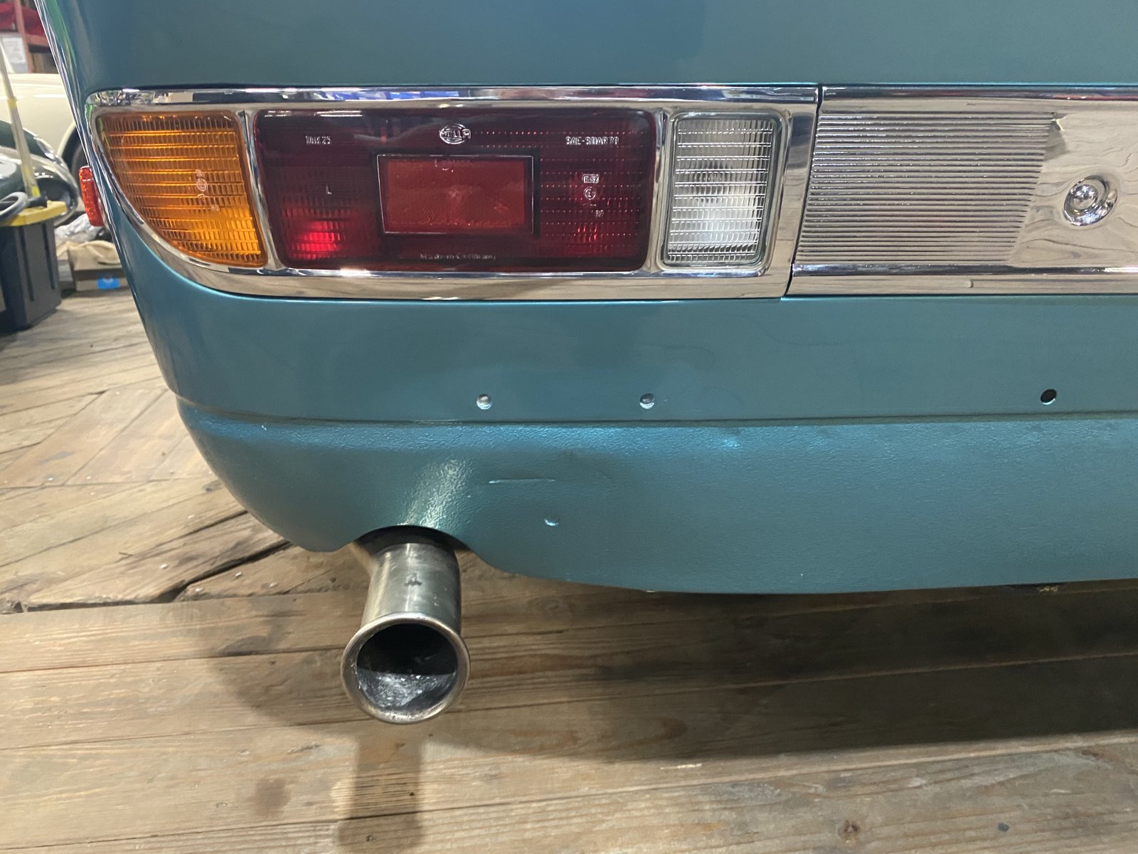

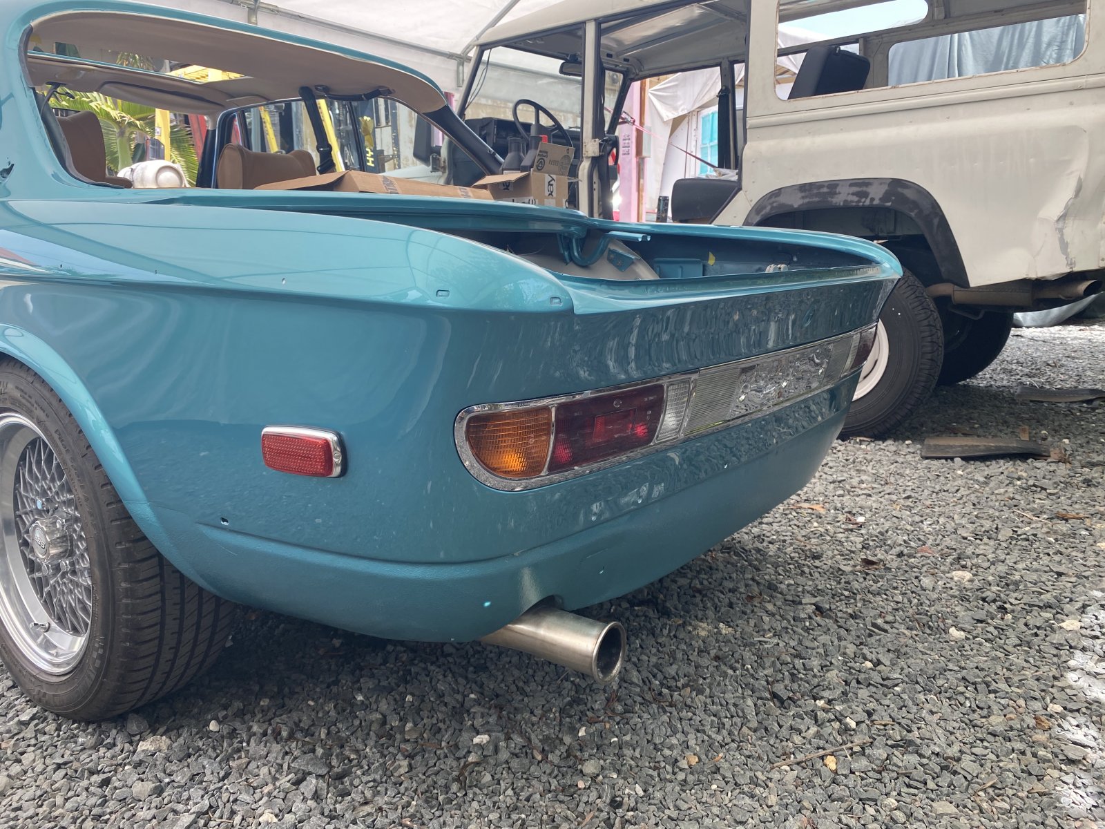

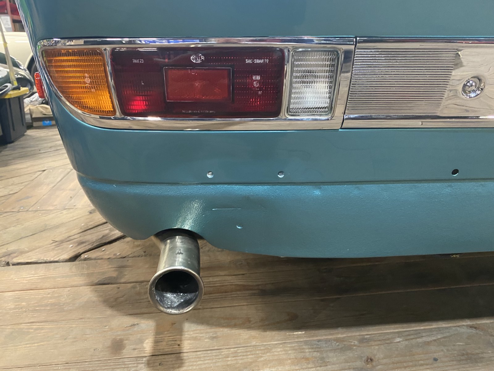

I have the ceramic-coated Stahl headers on my engine. The Stainless Coupe King exhaust system had to be cut and welded to fit a few years ago by a professional exhaust shop. All came out well and the CK tailpipe has a rolled end that looks like the OEM tip. I think it looks better than the cut sharp tailpipe I see on the W&N and Fritz systems. The hangers were all made by the shop. The tailpipe is centered in the rear cutout and sounds great. The shop polished the tip after these pic were taken.

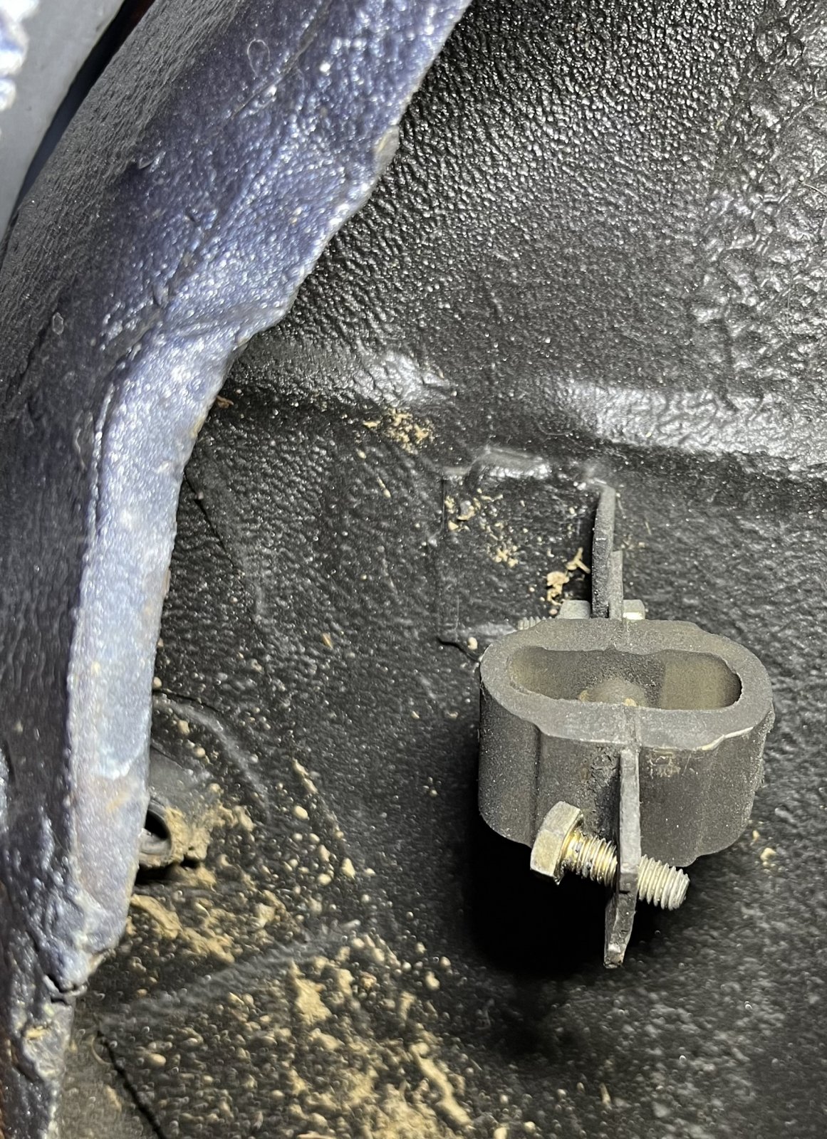

remember, the new bmw exhaust hangers are shite and need to be reinforced. I put a small metal backing on the inside of the loop on each side, with each held together by a small bolt and locknut. Otherwise they will fail sooner rather than later.

I've used those and had them fail also! I don't know why but my rear exhaust seems to eat hangers for lunch. I've modified/reinforced the stock ones so hopefully they will last. Of course I pack a spare and some wire...
