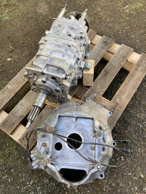

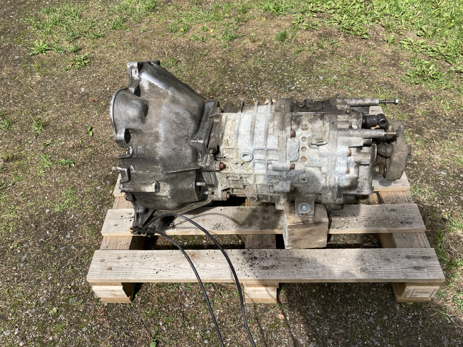

So also I have planned and even started the project to change the 4 speed gearbox to 5 speed one in my E9. The project has truly started as I've not only read several write ups in this great forum but I've also managed to source the 5 speed gearbox. The targeted selection is the 265/6 i.e the OD one. That is what I bought on last Saturday. The gearbox is from E23 728i 1981. The gearbox came with the bell housing and shifter platform, but not with the speedometer drive.
Even if I've read about the gearbox swap from experts such as Carl Nelson, Gransin and sfdon there are still some unknown areas to me. But I will learn when the project proceeds. Though the actual swap part will take till the cold and especially dark winter months.
By my knowledge I'm not able to utilize the shifter platform. It might be too wide as it is from 728i. On the other hand I'm hoping I'm able to utilize the speedometer drive from current 4 speed gearbox. Which bell housing should I use, is not known. In the bell housing that came with 5 speed gearbox, there seem to be rotation speed sensors. For which engine management system, I do not know. My car has M90 engine with L-Jetronic, not with Motronic.
Any advices and guidance is more than welcome.

Keep the bellhousing
Throw away the sensors
You can reuse the speedometer drive from your 4 spd. Shifterplatform from E12 (528i) should fit or a custom made one.

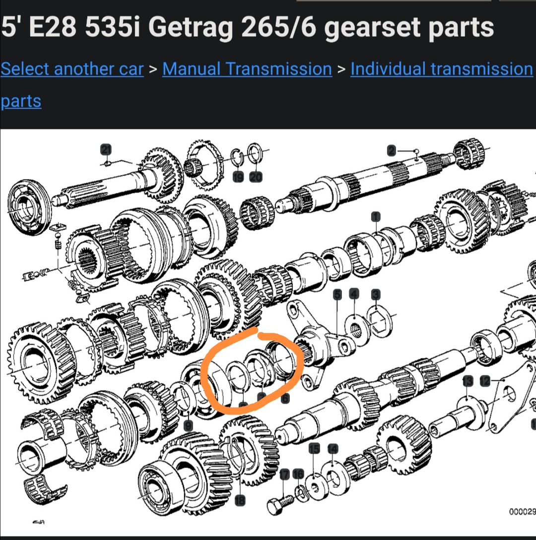

Sami, you need to check inside the 265/6 if it has the worm gear that spins the speedo drive. You can see it through the hole for the speedo drive.

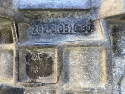

That appears to be a Getrag 265/6 from a Motronic Euro car.
I also was able to use my original Getrag 4 speed cable and gear drive with a 265 OD. The bellhousing gives you some options if you ever need a flywheel pickup, but I prefer using the Motronic 1.3 system that gets the same info from the crank pulley personally.
I take it you will also replace the clutch, throw out bearing, pilot bearing, clutch secondary cylinder, front and rear seals, and the shift selector end? Those are all annoying parts to change later.
I do not remember right now if you can re-use the external throw out arm or not with the new bellhousing, but I don't think so.
