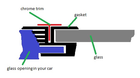

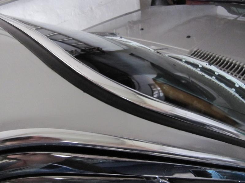

A simpler question might be, after install, where the gasket meets the glass around the perimeter of the windshield, does it lay flat as it does against the body of the car or is it rounded? If somebody has a close up picture of the installed gasket, trim and windshield handy that they can post that would probably answer my question.
Thanks !
Does this help? It is fairly flat both sides.

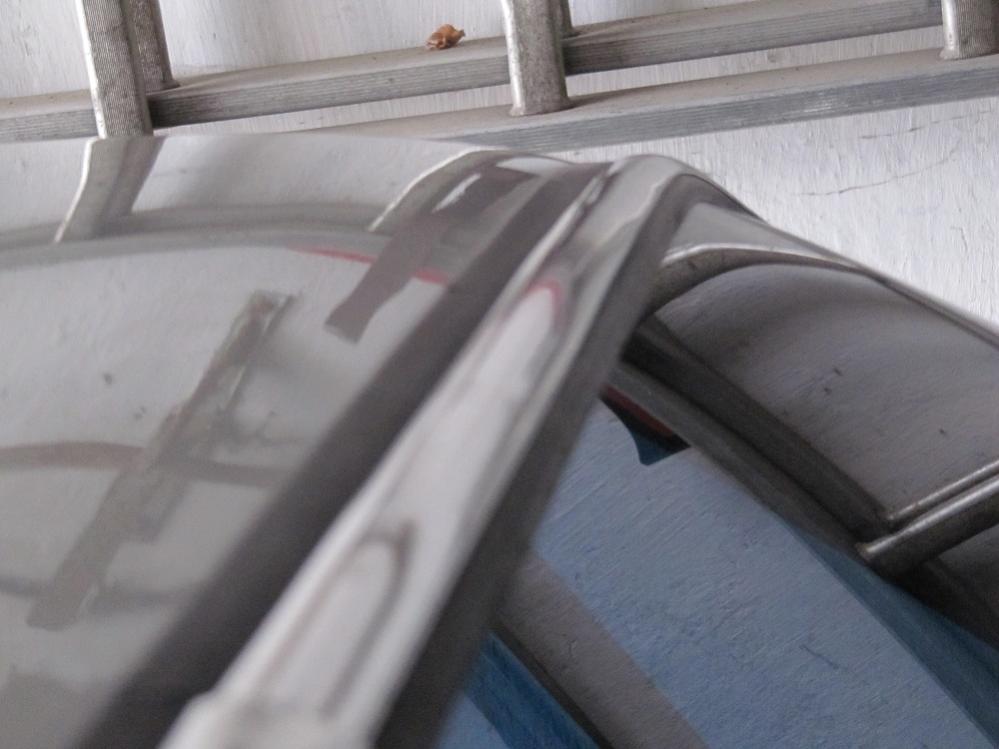

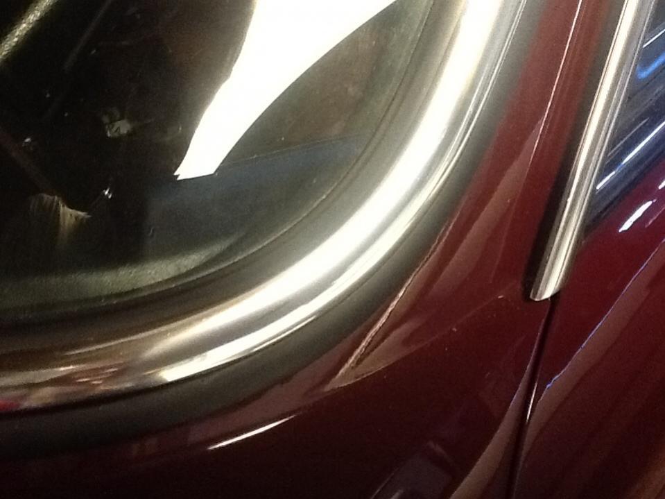

OK,
attached some pictures and a simple drawing for the principle of the gasket.
hope that helps.
cheers
Ingo

gaskets and chrome trim are installed and ready to go. embarrassed to say that i was envisioning the glass mounting into a different slot on the gasket- that was the problem. the diagrams and photos (and actually taking time to think about it) helped a great deal. Will try to document the process for future DIY'ers
