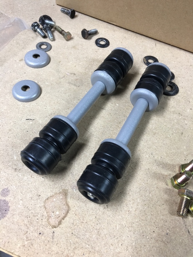

Stabilizer bolt part #07119912595 is listed at 160mm length. But when I put the following parts on according to the diagram:
http://www.realoem.com/bmw/showparts.do?model=7023&mospid=47811&btnr=31_0452&hg=31&fg=05
... it doesn't seem long enough. From the TOP:
plate - 31351114570 - approximately 2mm deep
rubber ring - 31351125712 - 20mm
stabilizer bar - approx 5mm
ring - 20mm
plate - 2mm
sleeve - 31352654108 - 60mm
plate - 2mm
ring - 20mm
suspension member - approx 10mm
ring - 20mm
plate - 2mm
2x m8 nuts - approx 20mm
for a total of 183mm or so, which is far greater than 160mm. Can anyone see what I'm missing? Maybe my sleeve is too long or the order of my parts is incorrect?
As always, any advice appreciated!
