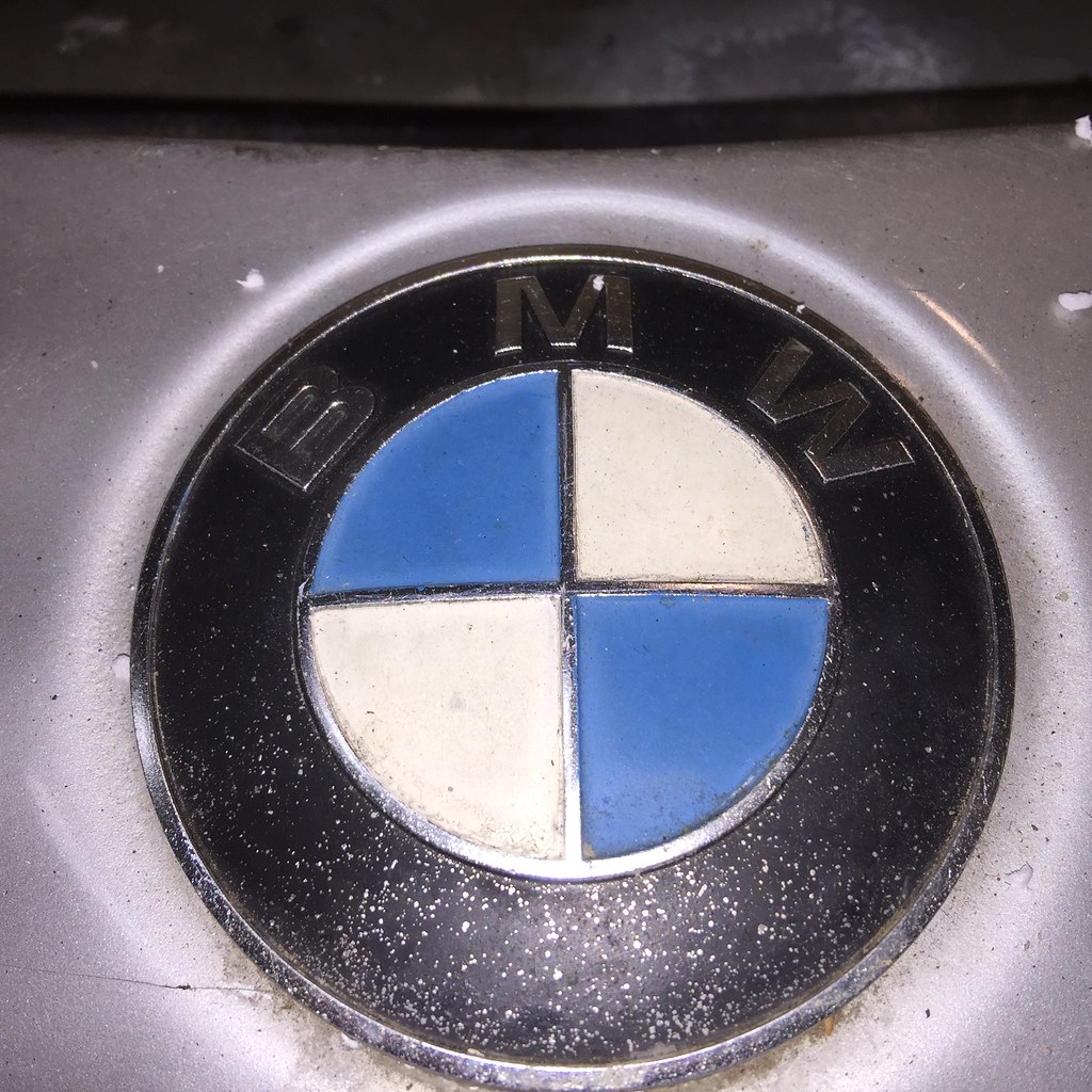

Want to replace my faded front BMW Roundel. Is this a dealer item? And also, what's a safe way to remove the old one without damaging paint?

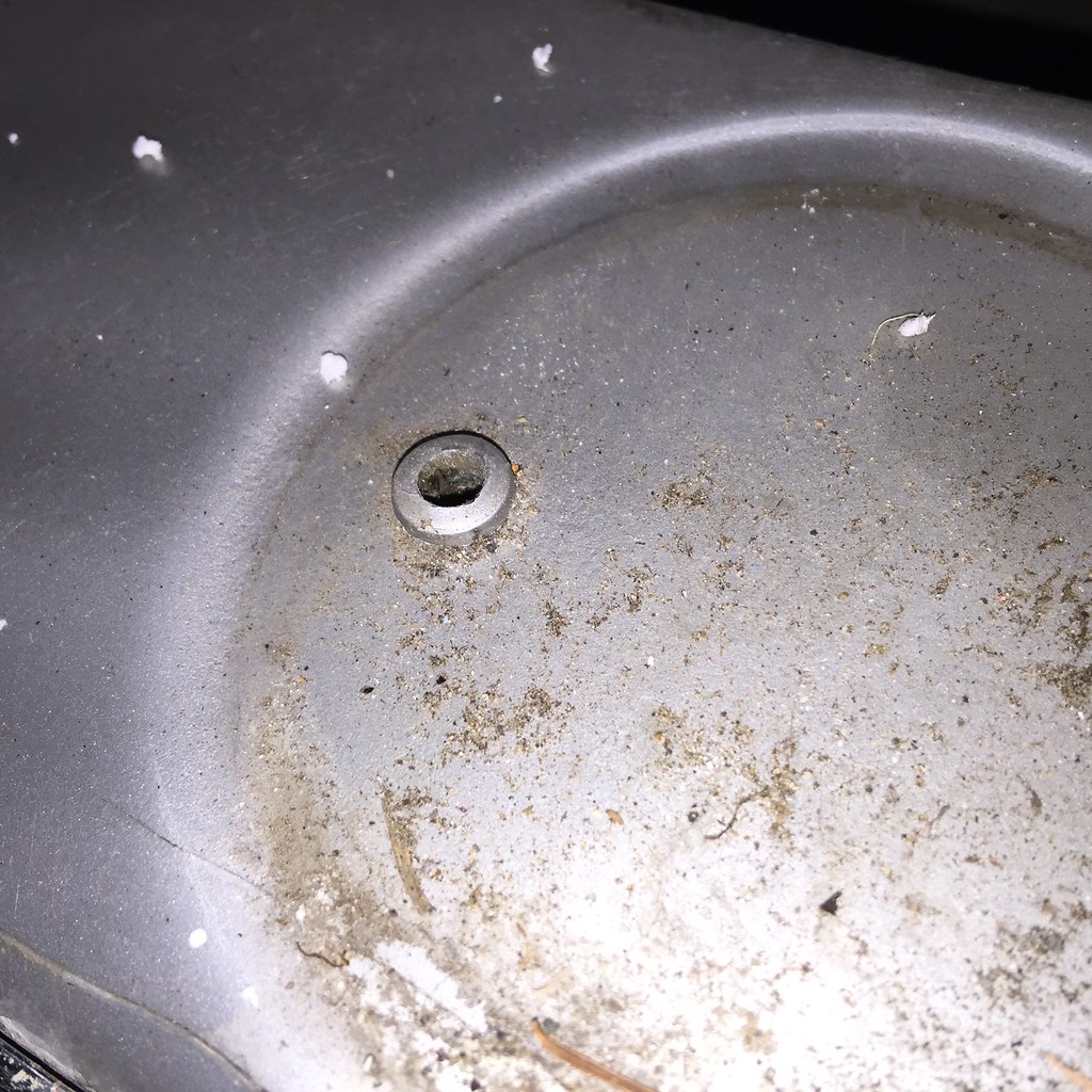

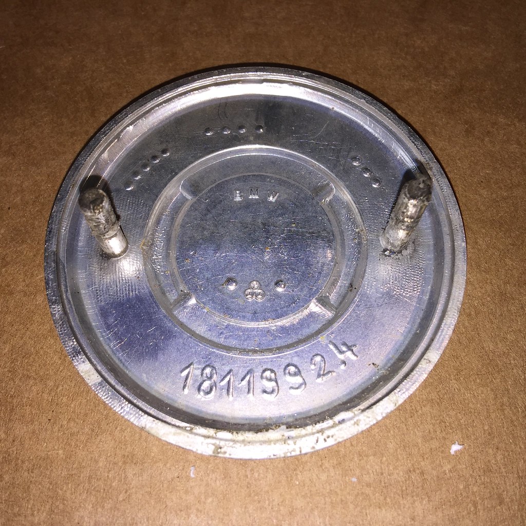

For your pleasure Mike. Simply pull up on it. If you are worried about damaging your paint you can remove your grille and press on the exposed pins from the underside. Try wrapping a small screwdriver in electrical tape.
FYI - Since the badge is aluminum, you can polish it prior to painting to make it look good as new.
Pull!

Thanks everyone. Now I think I can get that front badge off without damage. But can you help me with the part number? I ordered and received the one identified on RealOEM (I know, but I trusted it) which is 51141828851. This one is actually about 1 inch smaller in diameter than the faded one in place on my car now, so this is clearly the wrong number. Does anyone know the correct p/n? Thanks, Mike
