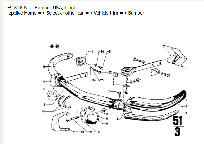

The coupe is in the body shop with the front bumper removed. It has a couple of small rubber isolation mounts that dont appear to be correct. With that in mind I am searching for # 19 left and right.
the 1973 USA model has the solid rubber ends (#19). 51/3 is for a USA 1973 only ... you can tell by the 2.5 mph bumper brackets (crushable diamond shapes at the bumper mount rather than the 'L' shaped mounts. the pieces that @TomHom is showing is for all euro cars and USA cars before 1973.
I believe that the rubber parts above are not for the front bumper but for each corner of the nose of the car, Part no. 51111811180
