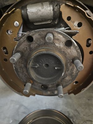

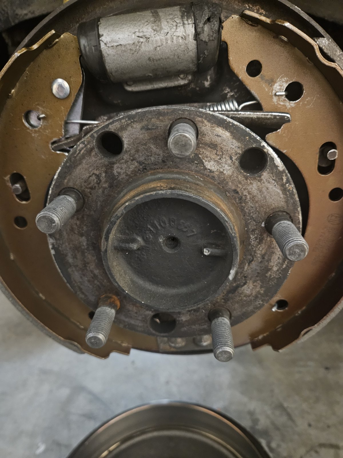

I did the 6 and 12, seem s fine. What I did find was the rear drum on the passenger side was dragging. I had my better half with her head out the window determining where the noise was coming from. we think it might be the the drum. it was discolored due to the heat. So now I am working on the drum issue.
as for the drums, I replaced the drums, shoes, wheel cylinders, springs, and rubber fluid hoses..(back only).
The weird part is that the Driver side is fine!
Thank you for the support!
The issue with the rear dragging might be emergency brake. Did you redo the ebrake when you did the rear brakes?
No, although I loosened it at the front and at the drum area. I had the cylinders rebuilt too. I tried turning them to reduce the diameter of the shoes, but it looks like these are no adjustable?

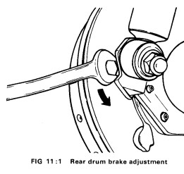

First check to see that the drum brakes are properly adjusted. I don't have drums on my car, but according to the autobooks manual there is an adjuster on the back of the backing plate. The procedure to do this is on page 114:
And the ebrake procedure is on page 115. You didn't mention making this adjustment, and if you loosened the cables at the front this adjustment is required, but do the drum brake procedure first.

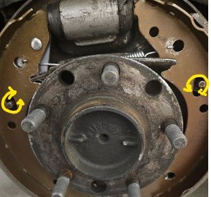

As mentioned by Chris Ohmes - there is supposed to be adjustment for the "rest" position of the shoes. Can you turn the adjusters with a 17mm wrench or are they seized?

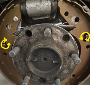

Brake shoes (in the rear) are adjustable but it's often the case that the adjustment bolt is very tight. Prepare the bolt with some of your favorite penetrating lube. Only an open end wrench will fit on the bolt head b/c the clearance to the shock mount is too small for (most) box wrenches. MAYBE a flare nut wrench will fit, if you have one in the correct size (might be 17 mm).
Note that as shown in the pic (not the drawing) immediately above that the adjusters must be rotated in opposite directions to move the shoes closer to the drum.
I used to adjust the shoes on all my 2002s, first thing. It snugged up very nicely and improved both the foot pedal and handbrake application feel.

Your right! I was able to turn the nut at the backing plate. No more dragging! Tomorrow is test drive time. I will let you know how it goes! Thanks so much!
Drove it today, works great!
