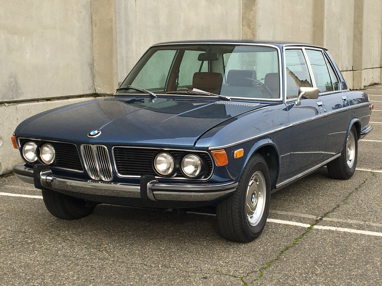

What have people used? I have tried two and they are not wide enough to meet up with the front bumper holes. I am stuck as Ma requires a front plate.

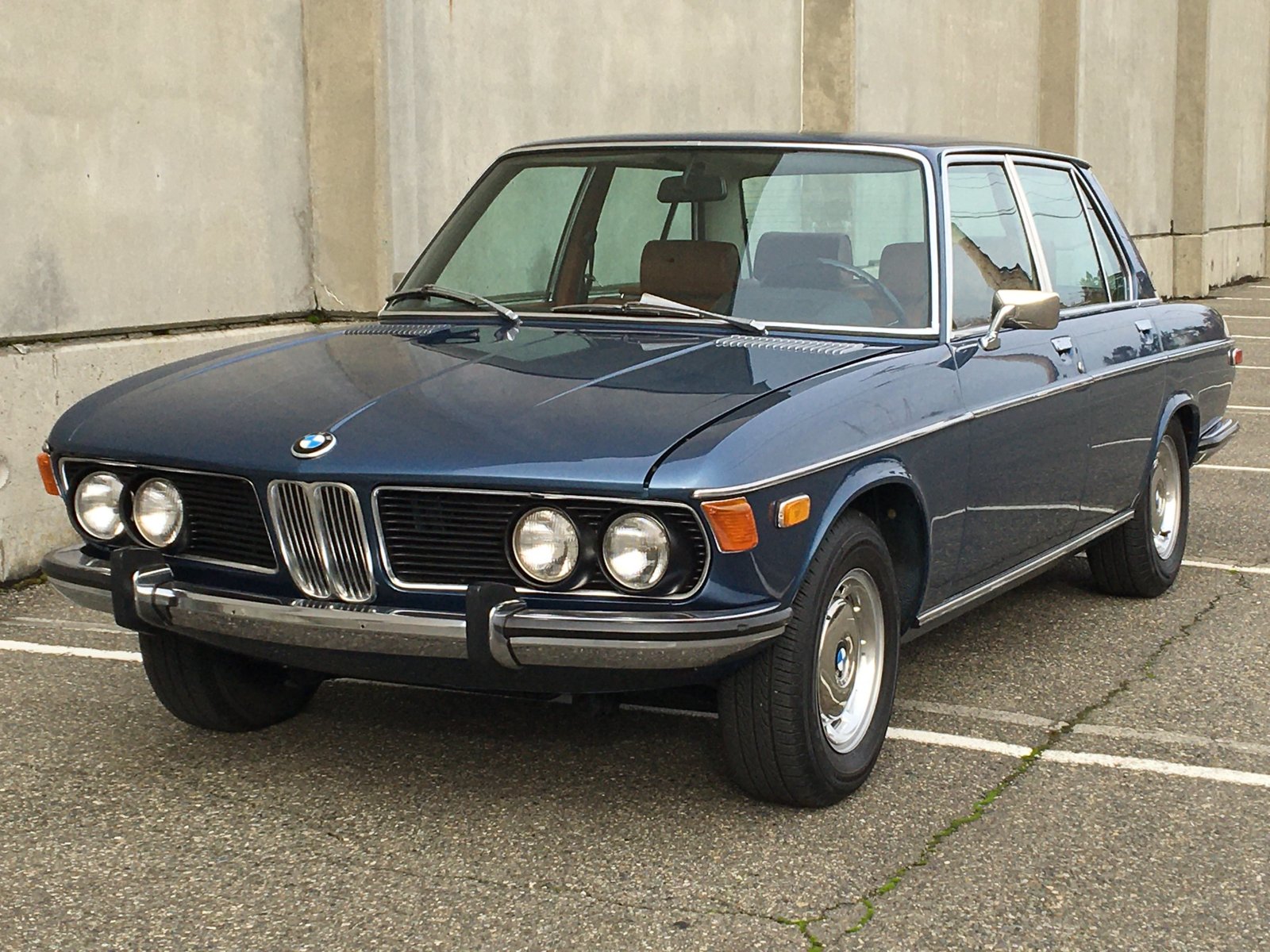

In Washington State, you don't have to run a front license plate IF you have a collector car plate or a Year of Manufacture plate. Maybe the same in Massachusetts?
Any car that looks good with a front license plate....looks better without one. :cool:

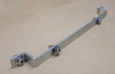

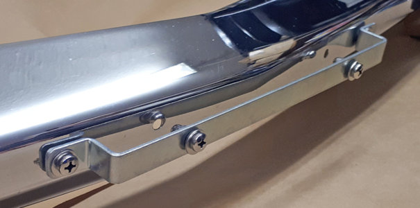

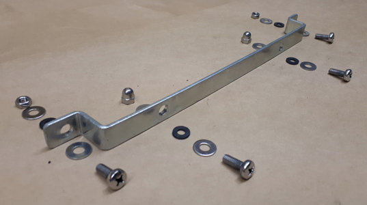

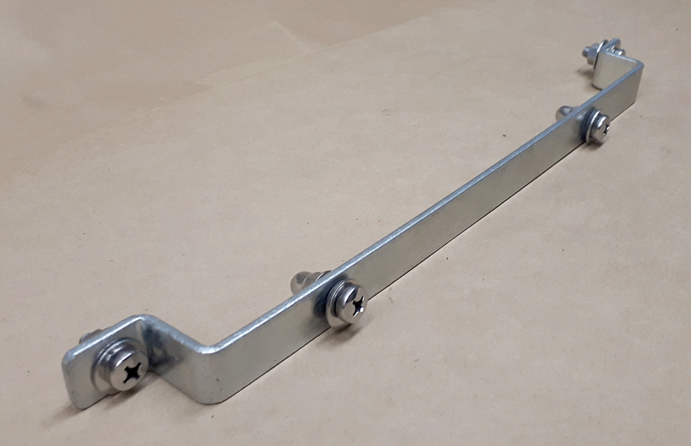

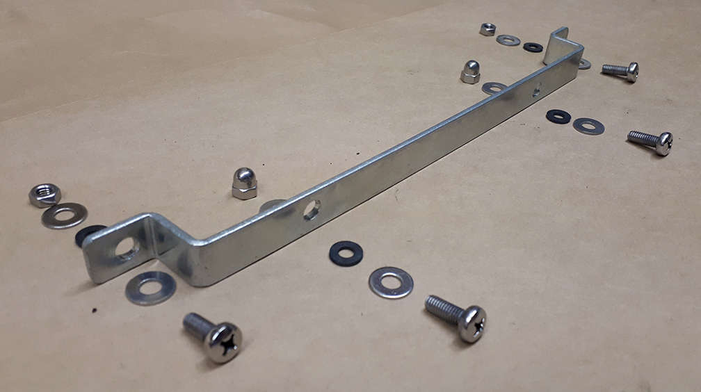

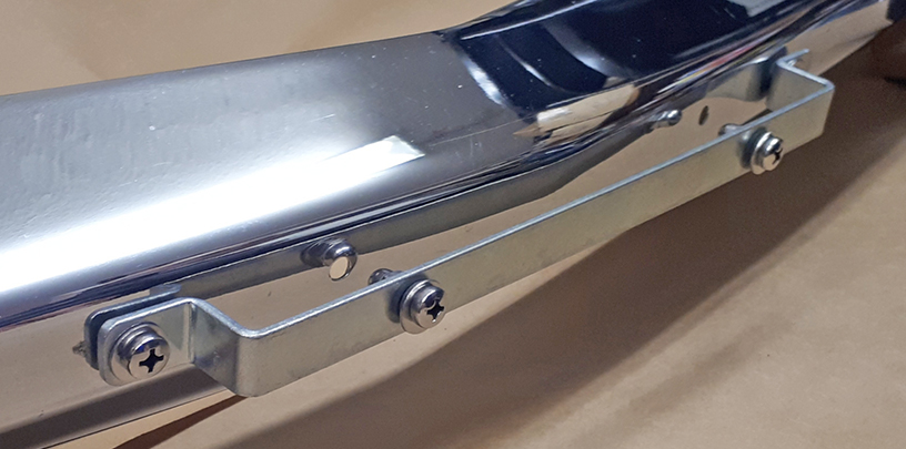

Just bend one up from some 3/4 " X 1/8th " drill some holes and get some stainless hardware I made up a bunch for 2002's awhile ago and had them plted as well but you could just paint it Here is a picture of the ones that I made up
Thanks, Rick

His mount is nice but also buy the two T shaped rear mounts so your plate doesn’t hang below the bumper which just looks wrong.

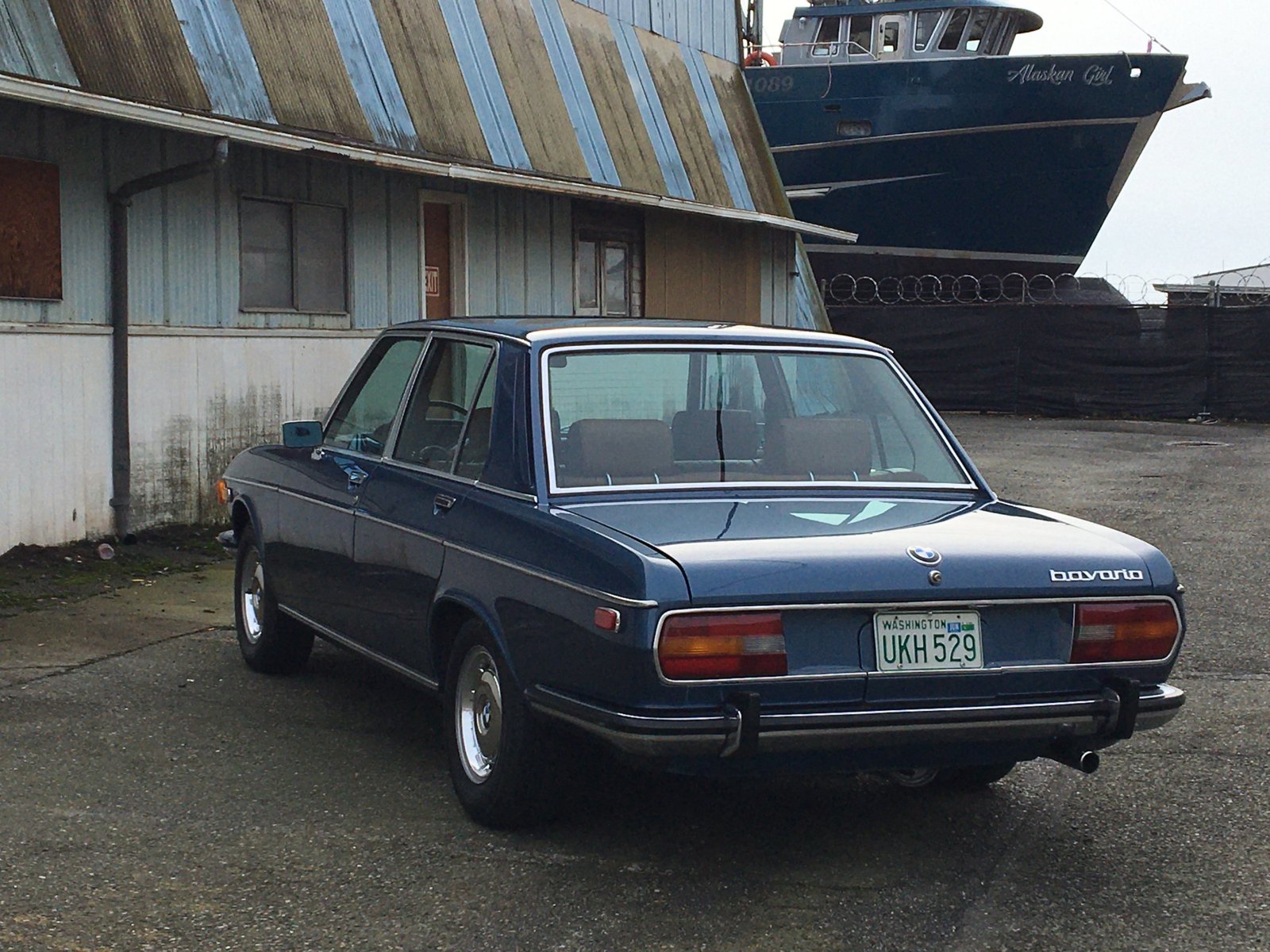

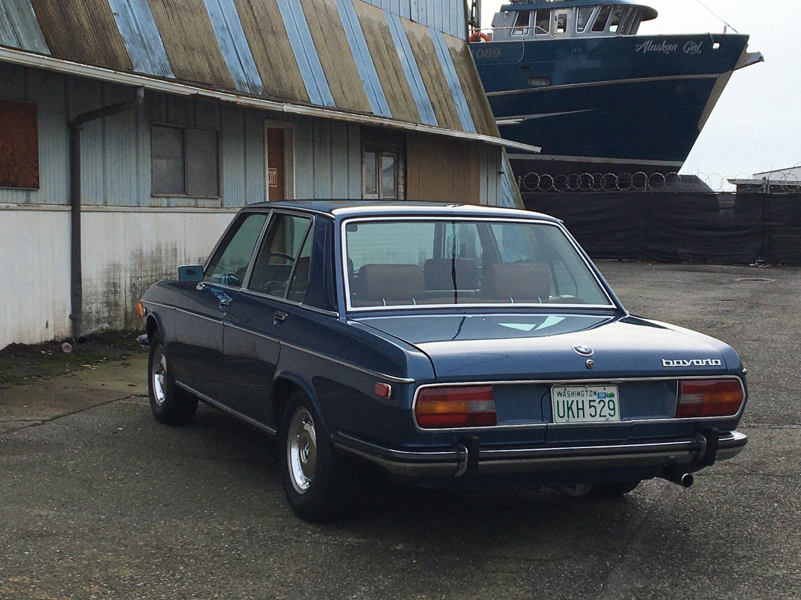

Same here in Oregon. Before I got collector plates two or three years ago, I irresponsibly just ran with a rear plate. I figure if a cop pulled me over, he'd probably just want to check out my car anyway. I did keep the other plate under the front seat passenger just in case.
I'm still not in compliance because my collector plate has a '72 tag on it. I have the correct sticker in the glove box.
