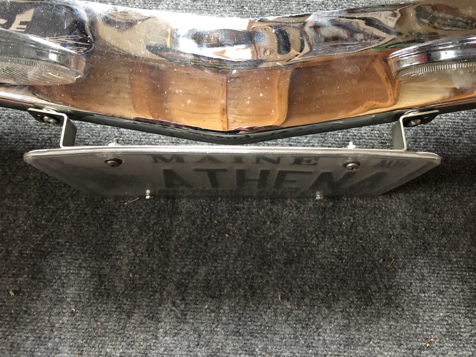

My CSi came with the center bumper drilled. Can add an air dam and secure it to that.

Do you. Have the stock holes on the underside of the center section? If yes, you can make a bracket that holds the plate BELOW the bumper and attaches via those holes.
