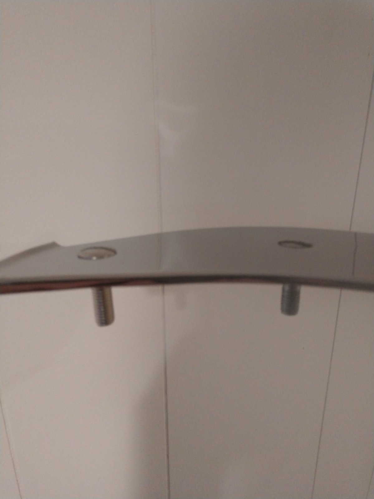

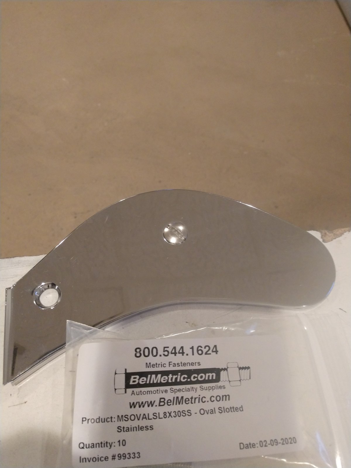

I had a difficult time sourcing something exact, but found these to be close. They are stainless not chrome but the head is curved like original with slots.
It was tough to find this smaller diameter head as well, seems the standard countersink is noticably bigger and flat, not domed.

I also sourced the same screws in SS. The large inner one that the cover covers, I could only find one that took a torx bit. If ever I show the car, I trust they will not remove the chrome plate.

yes, difficult to find, i made them out from a bigger size and then chromed them
yours seem a good solution
