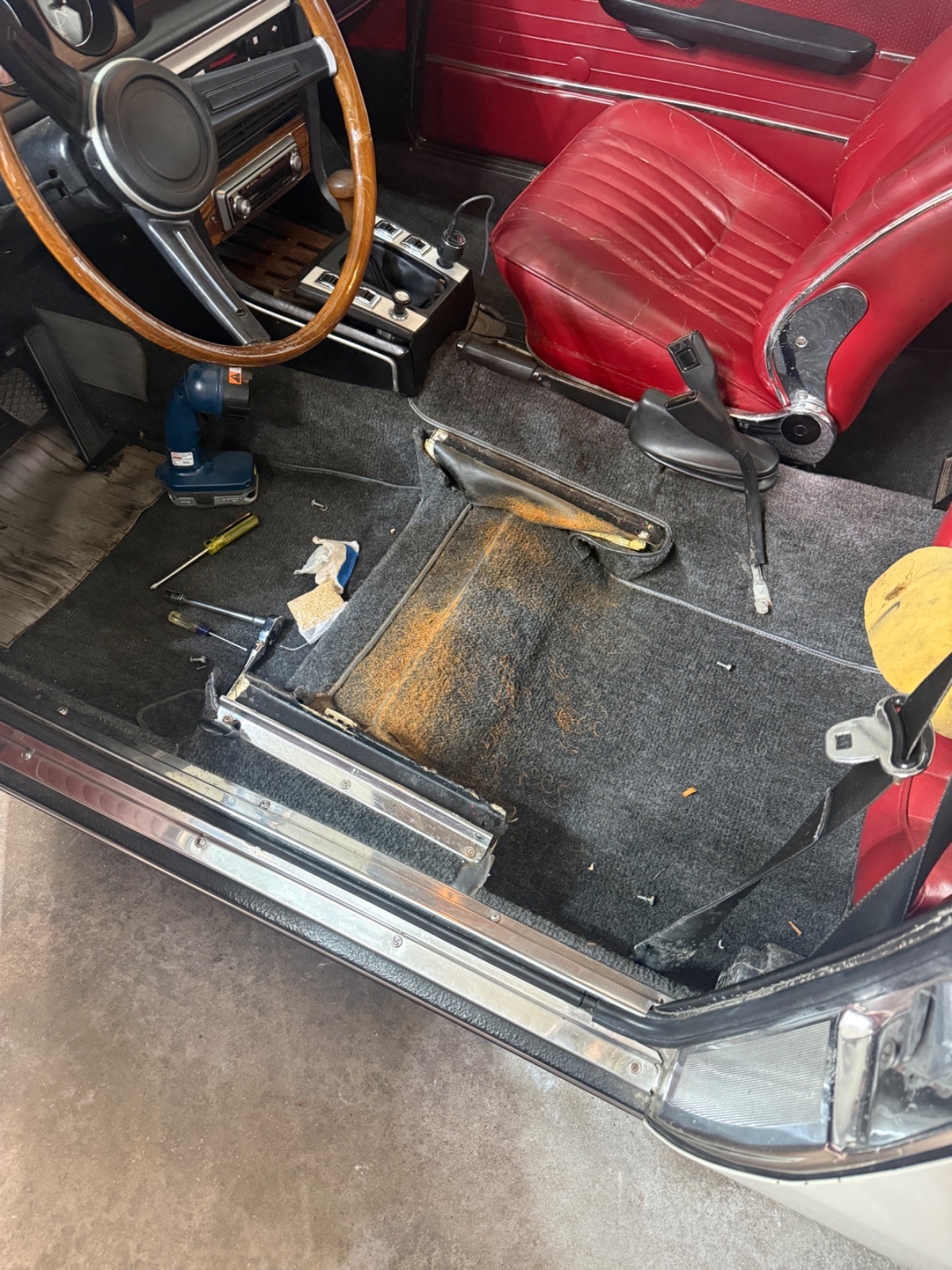

Hi I forget how to remove front seats.
Slide to dash and undo front bolts or
Slide to rear and undo rear bolts first
Any other steps missing?

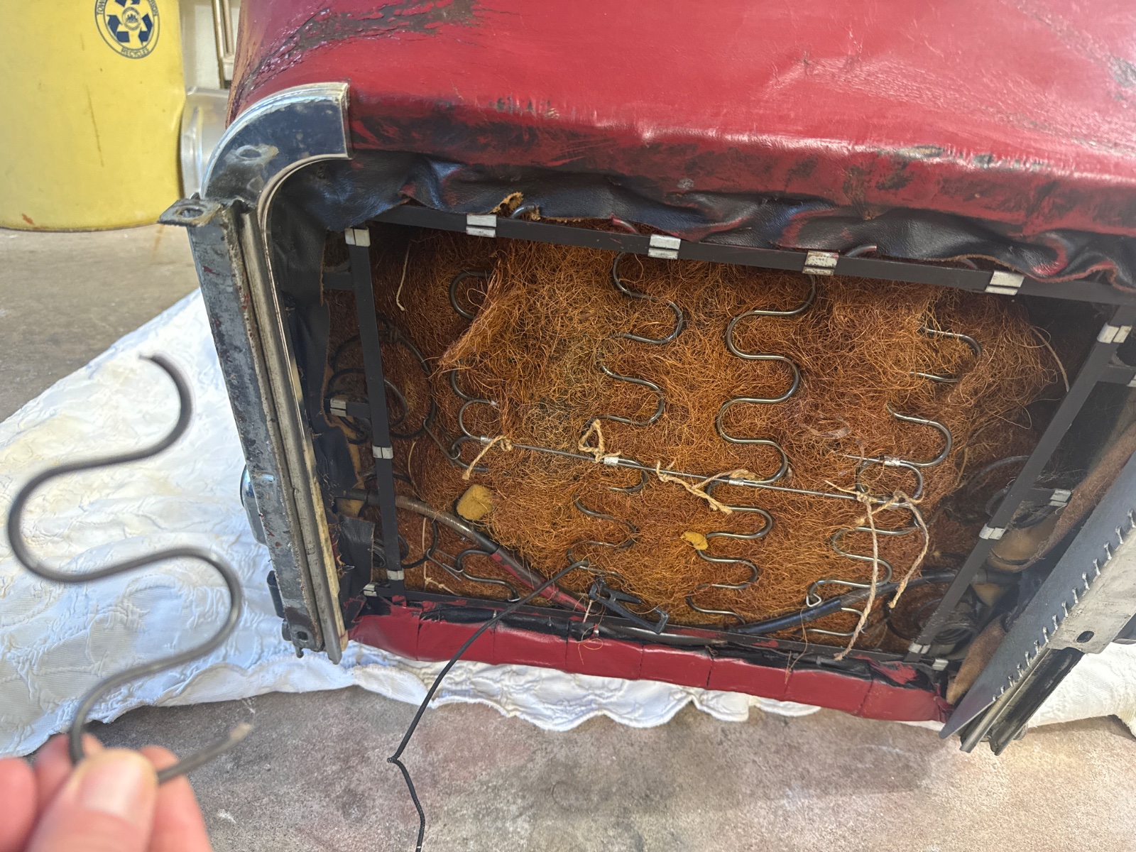

My bottom cushion needs re-foaming and cage repaired

i found it better to slide to front and remove the rear bolts 1st - there is more weight on the back and if the fronts are undone its difficult to then undo the rears. i guess you could put a weight on the seat bottom or something to keep the front down ...
  • Like
Reactions: Dlc
Wait I'm confused. aren't the rear bolts only exposed to removal with seat all the way back? Thx
oh really? I thought 4 bolts then done. I have done several times in my current '02 and previous ones. Also in other Bimmers...
yes of course, I had a brain fart. I removed all prior with seat rails intact.
Thanks all...
I agree
I didn't realize I was thinking no seat rails
I would never take them off unnecessarily
Well not sure why I over thought that one
Had never removed a seat from a CS before that I recall.
This took about 3 minutes
Seat is overall in poor shape. One issue is that the seat and full interior had been dyed prior to me buying the car in 2005.
I got back from a reputable upholster who educated me a bit. He said, disassembly of the seat and removal of the bottom cover would virtually destroy what’s left of it. All 4 springs are broken. He mentioned GAHH as somewhere that could possibly source another cover. However, it will never match the top of my seat and the rest of the interior. He also mentioned sourcing another seat bottom that had better guts. Both of these options would be very expensive. I tried to steer him toward another fix which involves some “old school techniques” he mentioned to get it on better supportive condition than it’s in now. I opted for this solution until I can figure out something better. Not what the purists want to hear I’m sure ..

Seat cores are available as used parts, I think they were shared parts with e3 so not as scarce as other interior parts.
Just put a 'wanttobuy' add in the parts section for the metal and spring parts.
The cushion (foam) bits are typically made by hand to fit by the upholstery shop.
I have one or two driver seat bottom steel frames with springs and can offer you one. Although i do not see, in your picture, that the four serpentine springs are broken - I have stripped down four seats and not found any broken but they do splay out which can be fixed. Review the DIY PDF I have attached. Additionally, it reviews how to purchase three upholstery foams of different density and to make a foam bottom cushion - your horsehair bottom will be useless. About 2 yrs ago I searched for replacement seatpads but nothing for the E9. You or your upholsterer might do this and you will have a good seat core to work with - but you will need him to fix your leather.

When mine were rebuilt we used burlap on the springs, then the horsehair, then new foam and finally new covers. Burlap helps seal the horsehair from dropping on the floor.
