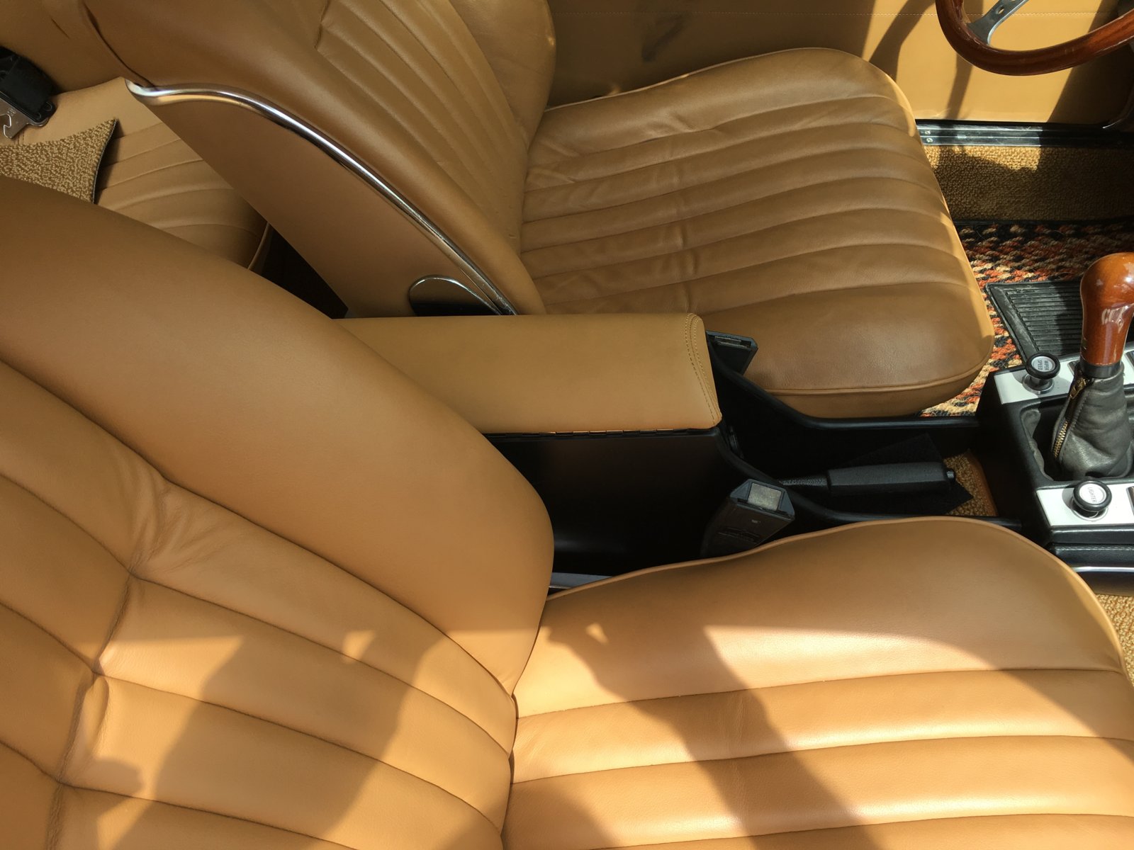

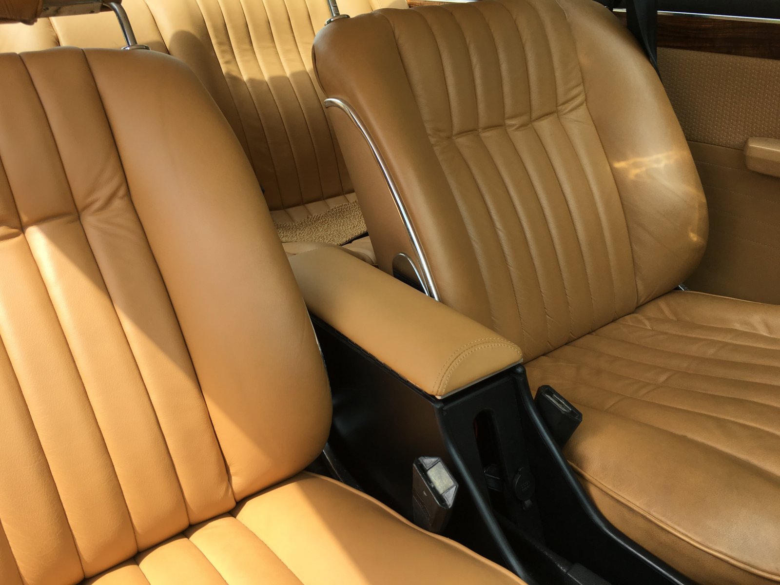

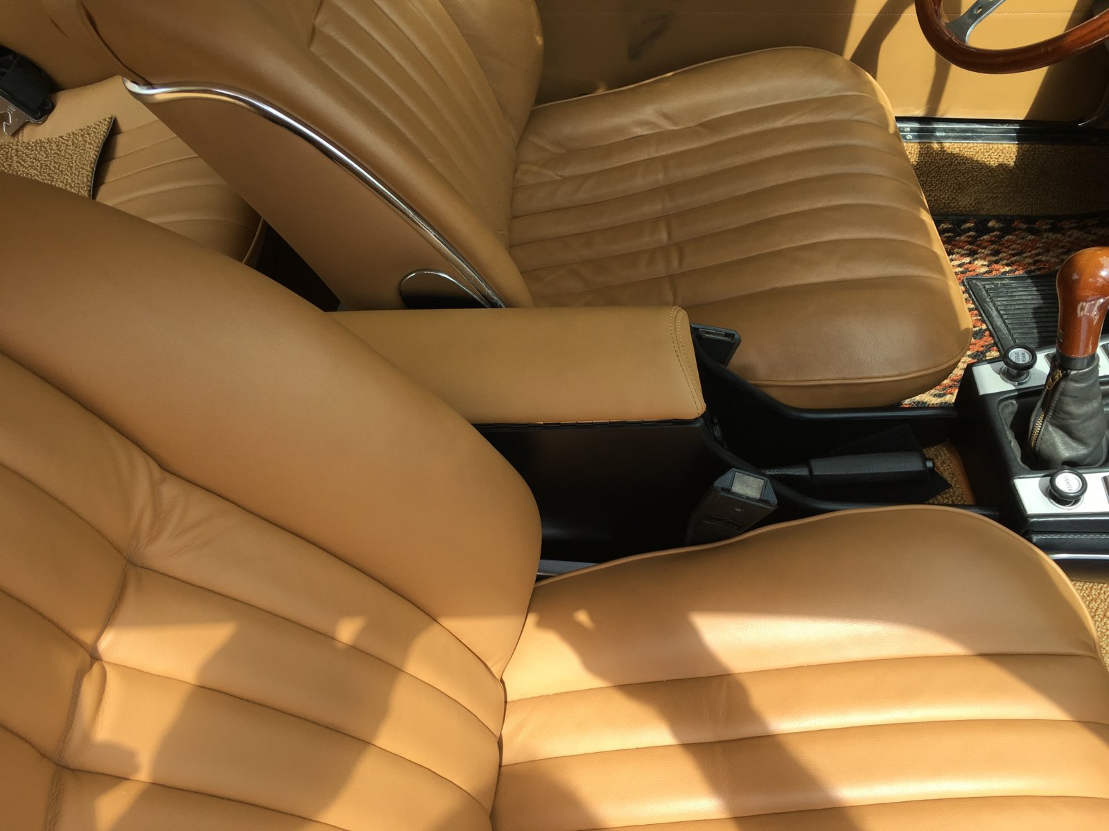

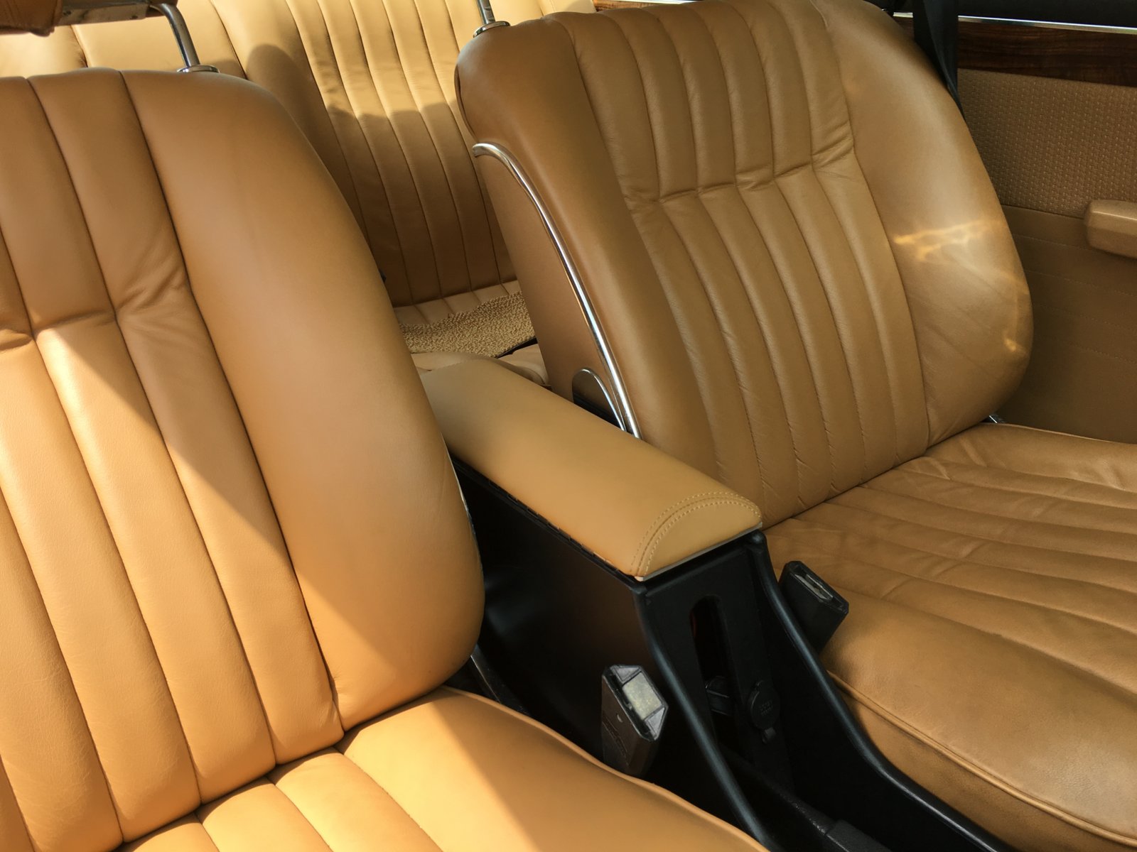

My '73 seats were upholstered with World Upholstery kit by the PO in 2006. His shop didn't do anything to the seat bottoms. They were like sitting on the floor. I had a first-class upholsterer fix them just like Chris described. I can now see over the steering wheel.

View attachment 99612View attachment 99613
