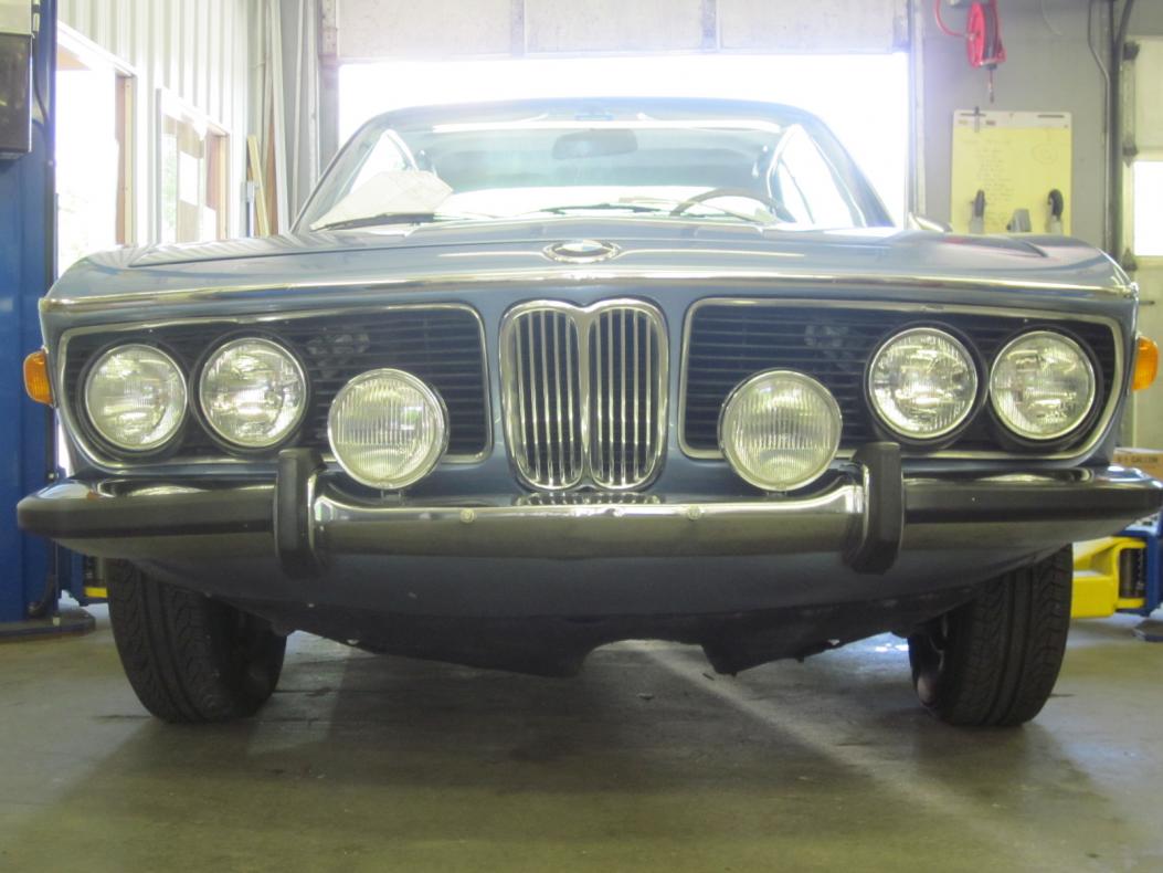

Our coupe prices are all over the planet. But no matter the condition or price I have not seen a single one with the front splash guard, except the one BMW did for a guy a while back and converted it to automatic.
They are available from BMW and mine came with the original clips/screws. I remember paying about $125. about a year ago. It could have been $225. the money came from the sale of our '75 CSi Barn Find parts and I was spending freely.
It gives the front end a cleaner, more streamlined look, when you can see it.

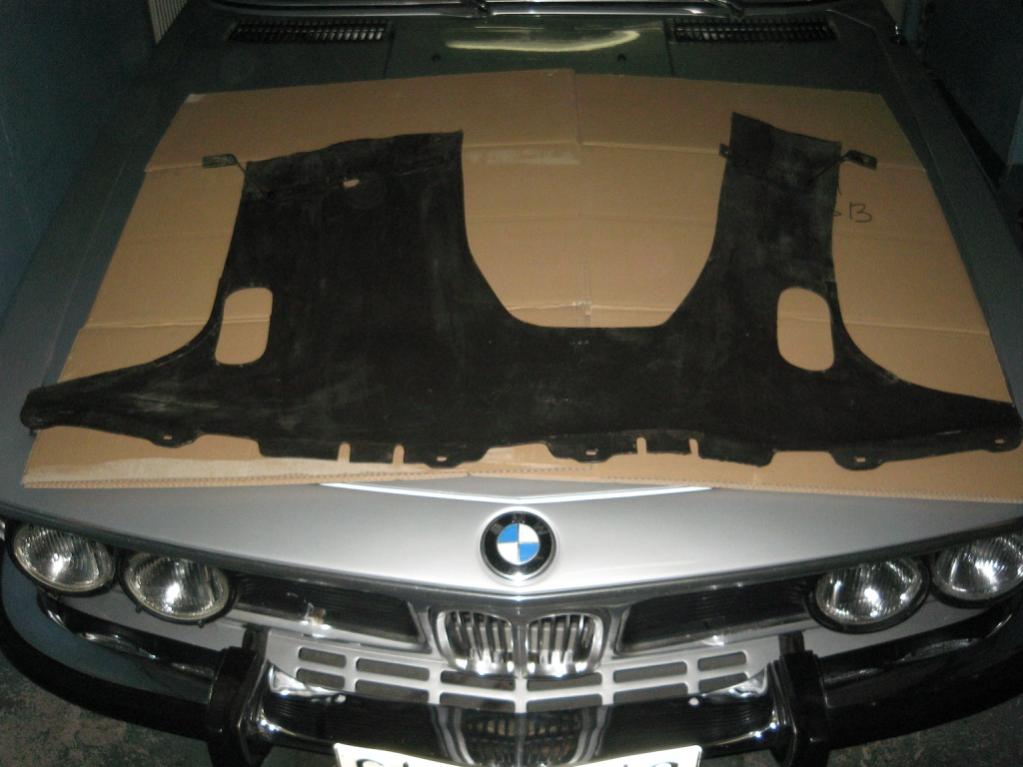

My car had that piece on it when I bought it this past July. It was made of fiberboard style material similar to the under dash covers. It had become pretty deformed, so it was removed.

Underbody pan--was pressed paper--
and was a single piece original part and fitment to all E-9's. Most were discarded folowing the 3rd or 4th service performed by mechanics as they became a nuisance to R 'n R especially when cooling system problems arose--which became very common to both E-9 and E-3's here in warm climates due largely to the poorly designed fan clutch and marginal original radiators limited heat transfer capability.
John A--the part you have laid out on you hood appears to be the correct part being discussed, a single large piece of pressed and coated paper with openings for the oil pan and smaller openings for the suspension tow hooks.
Your reference to 3 pieces would seem to me that you may be confusing underhood pads in the conversation as they are a 3 piece part set made of gray foam--and include a large single piece for the underside center and flanked on either side by the small pieces.
