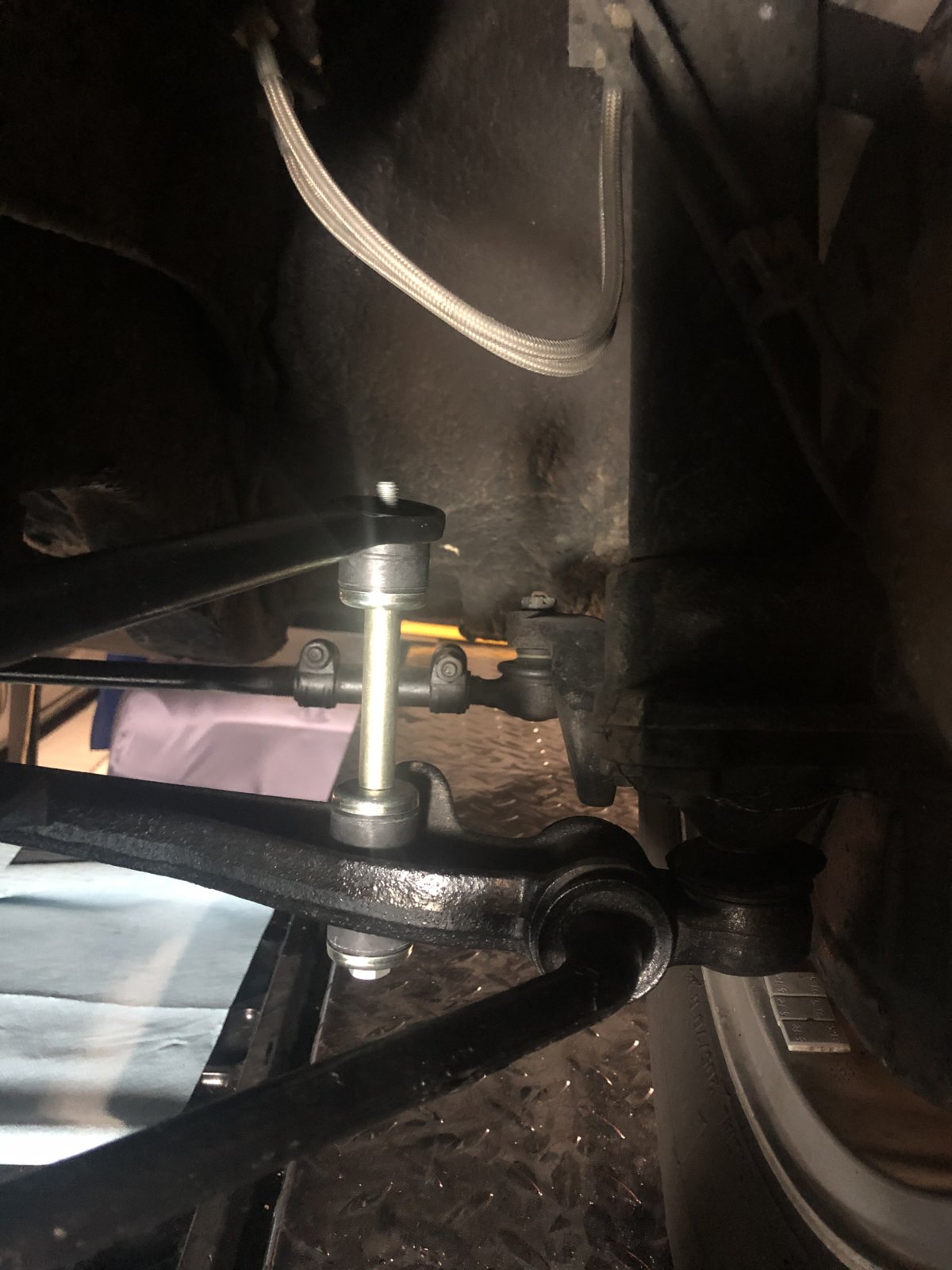

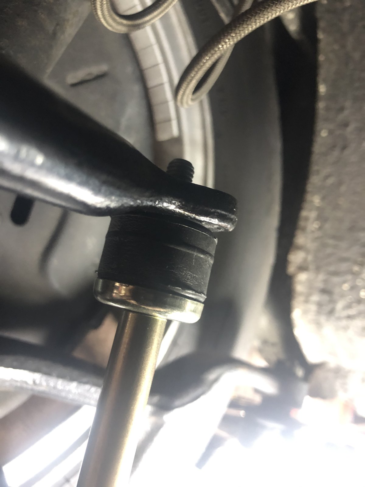

I’m trying to install a new set of stabilizer bushings at the ends of the bar but the bushings are so new that I don’t have room on the bolt. Do I need to compress this somehow or? My old setup had hard squashed rubber so it went on no problem. Thanks.

Cup washers make no difference as to the overall length (not sure why they go the other way, it's counter-intuitive to me), I cut 10mm off the center piece, just enough to compress by hand to get the nut on, I'd rather have all the rubber in tact and not mess up my newly painted components getting a clamp on. Worked great. I clear coated the pieces so as to hopefully keep corrosion at bay for a while.
