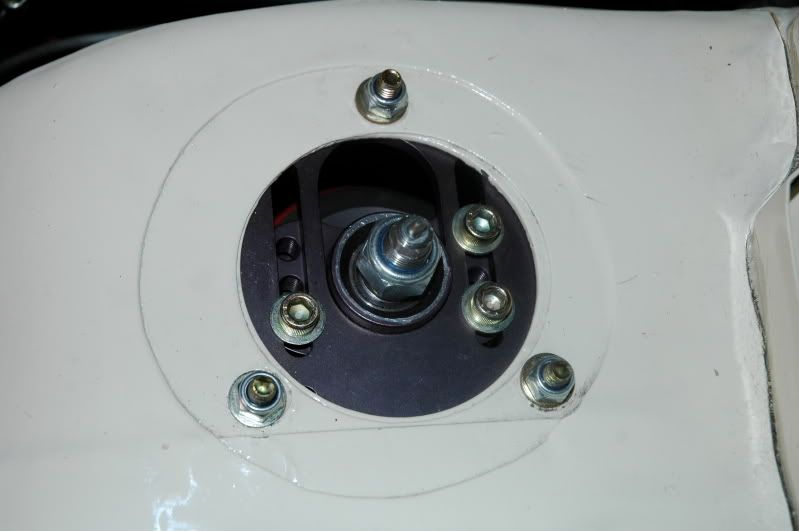

This may be an ignorant question, but after looking at the excellent detail of some of the members cars, engine compartment, and admiring Andi's strut brace, and as I am about to go into engine detail and researching possible suspension upgrades...I have yet to see this upper strut (camber?) plate on other cars. Would this be specific to the '74?

That's the spacer that should be underneath. My book on the cars doesn't show the spacer and I'm looking at removing mine and fitting longer (stronger springs) to get more travel. Have growm tired of it bottoming out but still want the lower stance!!!
I can't understand how the bonnet can close with the spacer at the top.
I've just removed mine and the front bolt hits before the bonnet is closed.
Looks like I might have to cut the bolts off!!!

This topic comes up frequently. Check the archives. Short story: the spacers were necessary to meet DOT bumper height specifications. Chuck them. You can cut the U.S. length bolts, but the shorter EUR bolts are still available from the usual sources. I've seen a bunch of cars where the hood clears with the spacers on top, but it isn't surprising to hear that some don't.
To begin with the stance of the e9 is nose high. Get Carl's spring set to bring it down and then get the off camber plate to improve traction in front. The camber plate that he sell cann't be seen once installed and actually raises the front 1/4 in or so. But overall stace is good. Hope this helps explain.

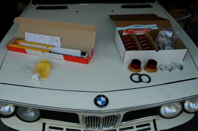

Thanks to all, that solves the mystery. I have no issues with bonnet closure but I see now it is real close on the forward most bolts. Barry, I did do an Eibach spring job some years back on a Jetta my daughter brought home (no prior inspection by Dad) that had been "Lincoln lowered" The springs had been cut and stuff was so loose un-loaded that I was afraid the suspension would fail at the first good whoopty-do. The Eibach kit did the trick for a safe lowering of the car and was reasonably priced if memory serves me correctly. Where did you source your kit, what is the shock brand, and did you do the rear as well?

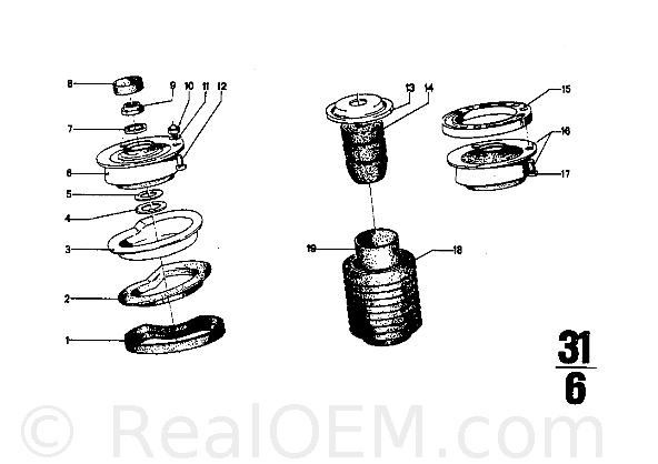

Realoem for the E9 clearly depicts the spacers, but does not provide a BMW part number - even for the Dot compliant vehicles. Notice the part identified as "15" below. In fact, nos. 15, 16 and 17 do not appear to be listed on any of the models - including the later big bumpered ones. ("guide support" 31331101663 is listed). Having explored this issue a long time ago, I believe the spacer is listed by some sources as a "Flat Washer" (part number 31331106059). In some instances, realoem indicates next to the part: "If necessary." This does not account for the different thicknesses I have seen. Compliance with bumper height regulations (if really an issue) or headlamp height (more regulations) could have been less expensively accomplished (for the manufacturer) by reducing front tire pressure. :wink:
In any case, realoem's lack of a specific listing or notation for the spacers on the E9 could be an oversight or more likely something that was considered a superseded - nonessential part.
pamp... I got my set up from Ground Control.
Shocks are Koni - 1198spgc..
Eibach 440 lbs 8" with the adj you can set the height.
Realoem was cobbled together years ago and has not been updated since. At that time, information for parts no longer available was omitted. It is of questionable value for determining authenticity since it is missing a lot of original information and yet is not current for the situation now.
In the orange parts books, part number 15 is listed as a "scheibe fur Stutzlager" (sorry about missing umlauts!) or "washer for support bearing" and is coded for application for right-hand drive cars(!) but the applications are for:
2800CS/USA 2270244 on
2800CSA/USA 2280266 on
The part number for part 15 is 31 33 1 106 059.
If anyone needs it, the part number for the short studs for the strut bearing is 31 33 2 624 109.
