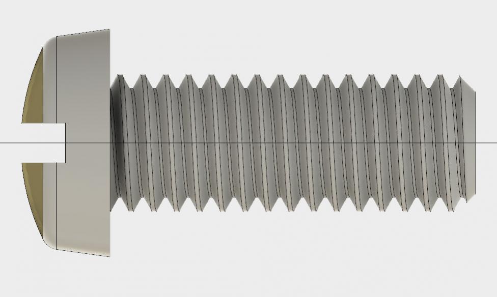

Leaving the end of the bolt square, even after running off a nut, will make it hard to get another nut threaded on. Properly configured ends should have a bit of taper to allow ease of starting the nut. Here's a screen shot of a CAD drawn screw showing the ideal profile.
I'll take a flat file and take down the corners a bit before running off the nut, or nuts you have put on the shaft before shortening.
