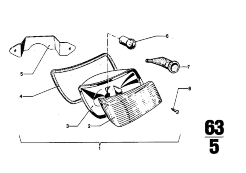

So in the schematic for the front turn signals, there is no turn signal lenses gasket shown. There are definitely, small, shaped gaskets (in my car) designed to cushion and seal the turn signal lenses to the light housing. They would go in between number two and three in the schematic below.
Does anyone know if these are available anywhere? Mine are very dry.
To clarify, I'm not talking about the larger body gasket( #4) that is shown below, and that seals the housing to the body.

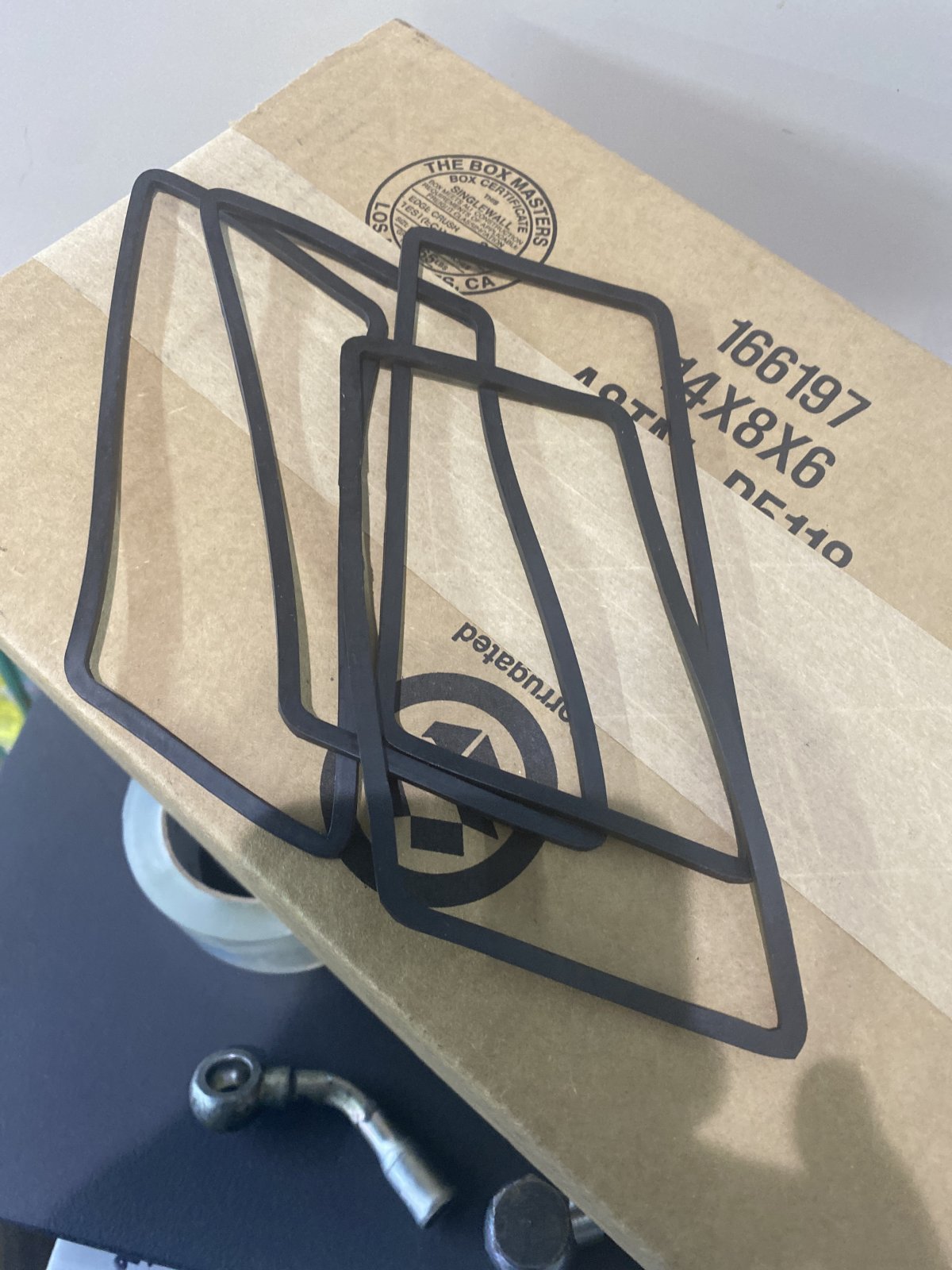

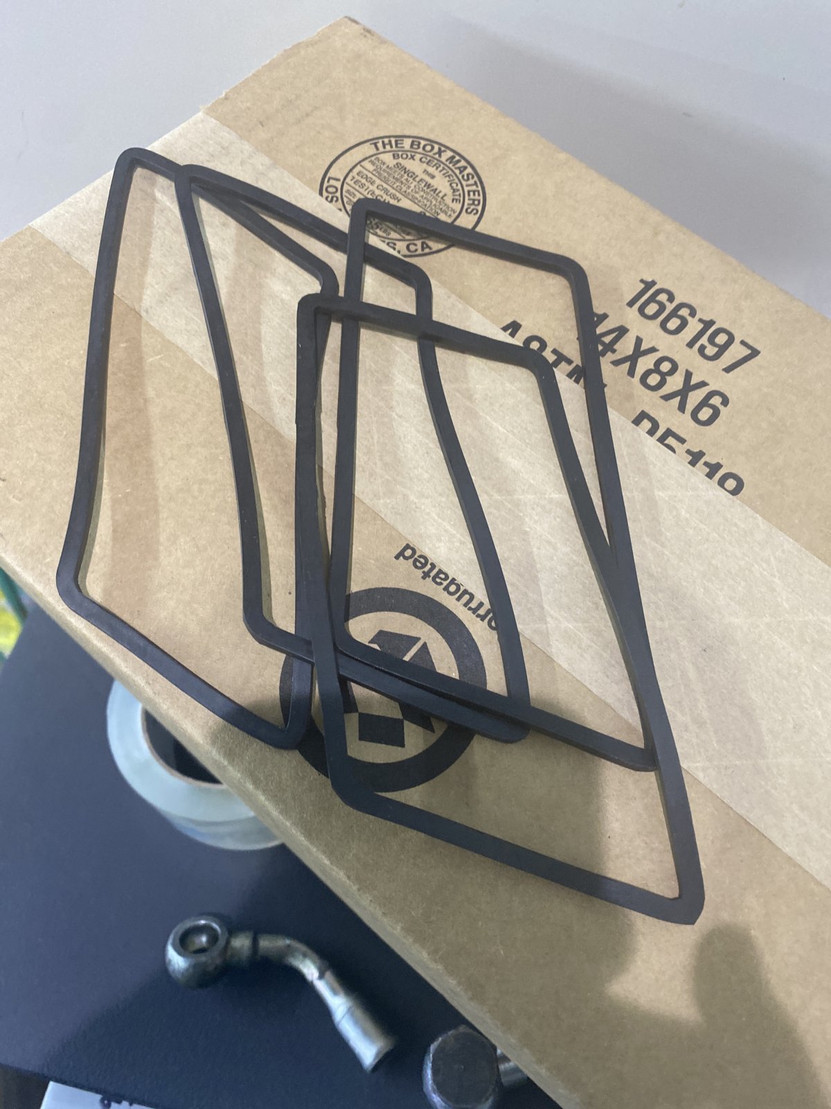

I couldn't find them new oem last year, those are always first choice for fitment. I found a square gasket that is close, but it takes some fussing to fit in the grove.
I bought a dozen of them, and can send ya a couple for shipping cost if interested.

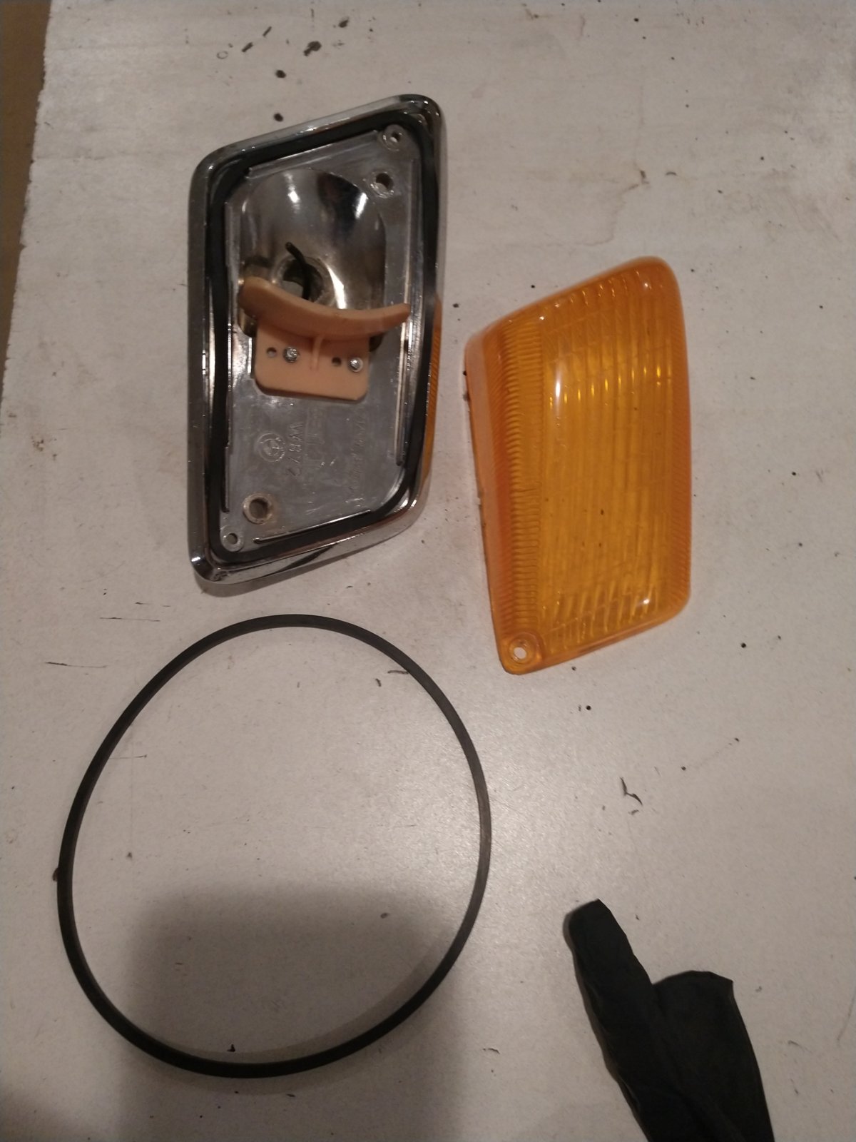

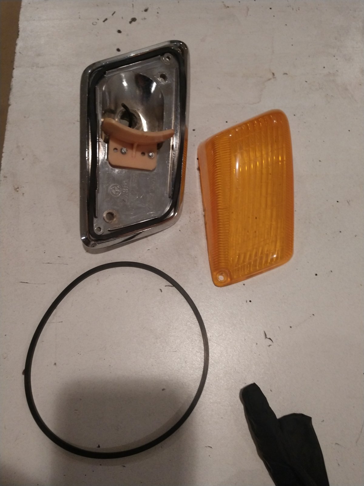

635s use a small round rubber gasket that is for the tail light lens. It may be 1/4"round or less It comes as a strip and just pushes into the groove. They are readily available. At the same time, the rubber spline used to hold window screen into the frame could work. These ideas are based on the size of your channel. Looking st the picture in the above Ebay ad, the round stuff is pretty much like the thinner gasket they show only it would have a seam where it is cut to fit Just a shot from the hip

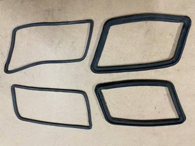

I carry his seals- good product.
Pick up a set when you come by next.
I buy quantities so price is same
