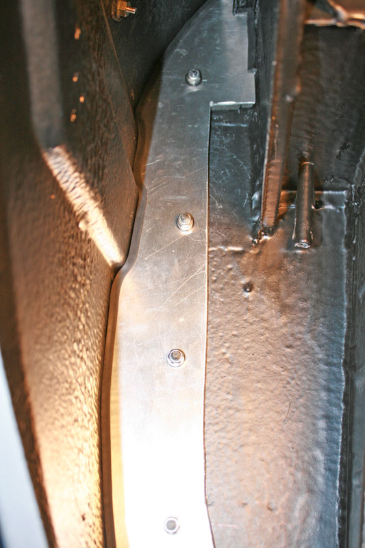

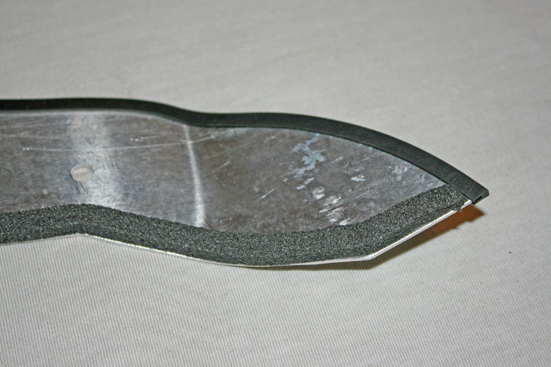

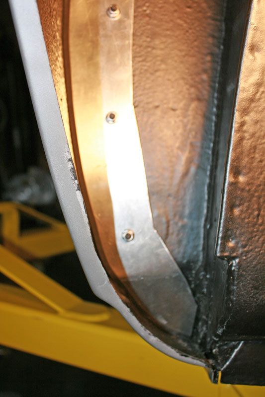

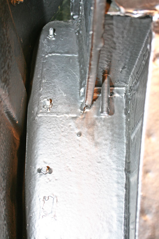

The W&N panels are the sames (or similar) to the stock panels originally installed by BMW. The upper one was tack welded in place. The lower (longer piece) was held on by two screws into speed nuts fit into the rectangular holes in the front of the 'A' pillar. I was going to refit new ones into my car, but, they don't fit well and there is not good way to attach the upper one. The contours of the long piece also does not match the inner fender panel very well - leaving some big gaps. The panel is also tight against the 'A' pillar.
So instead, I fabricated a single piece out of aluminum that I scribed to the inner fender (wing) wall. I left room for a rubber 'U' shaped gasket along the edge against the fender. This required tack welding short 6 mm studs along the front of the 'A' pillar. The aluminum piece is held off of the front of the 'A' pillar by 1/4" rubber washers at each stud and a gasket along the back edge to help seal off the inside edge.
The volvo fender liners I have installed provide the first line of protection, the alum. strip, the second.
Both are easy to remove should I need access, or to clean out.

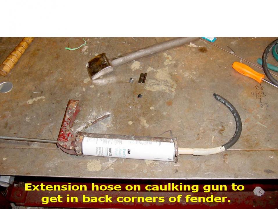

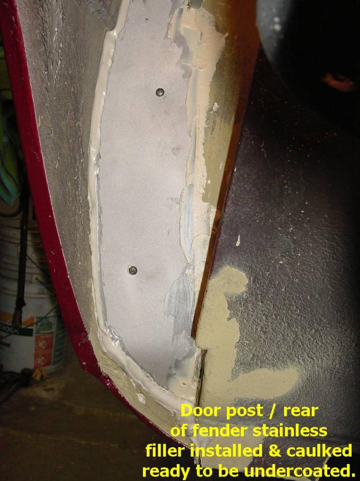

I personally wouldn’t use silicon for sealing auto body panels. Paint and undercoating have a hard time sticking to silicone and after a few years I have seen the bond at the edges start failing. 3M makes many different sealers designed for auto body panels that can be painted or undercoated. I like their “fast & firm” sealer for bigger gaps and if you let set up for a few days before top coating with paint or undercoating I think you will have good success with the bond to the top coats.
The 3M strip caulking (also called dumdum & ribbon caulking in the trade) is a good product to seal panels that have to be removable because it takes decades to dry out & set up. Strip caulking also works excellent for holding nuts in sockets or wrenches or even on finger tips to get them started, I can’t be without it. 3M stuff is pricey but in most cases it does seem to work better than the lesser known brands. ~ John Buchtenkirch
This is also what I used in my restoration for the inner fender parts (and in many other rust-prone areas of the car).
