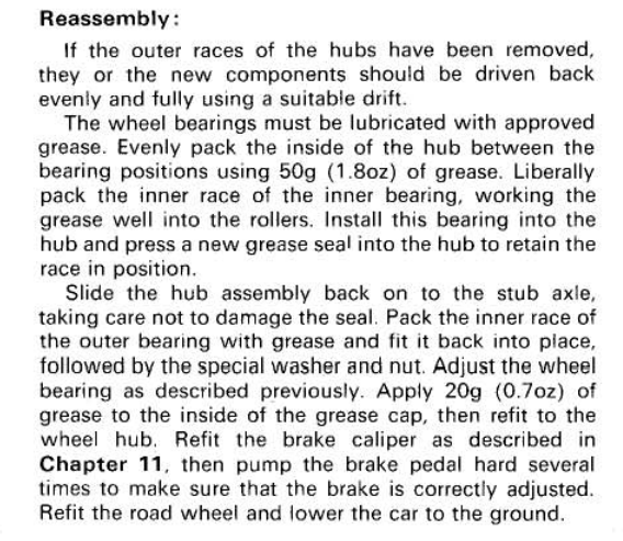

Ok so I came upon this in the Autobooks manual, it says to use the seal to retain the inner bearing, does it matter?
"Retain" just means not fall on the ground. It is not held tightly against the race by the seal. If it did, the rubbing would wreck the seal.
