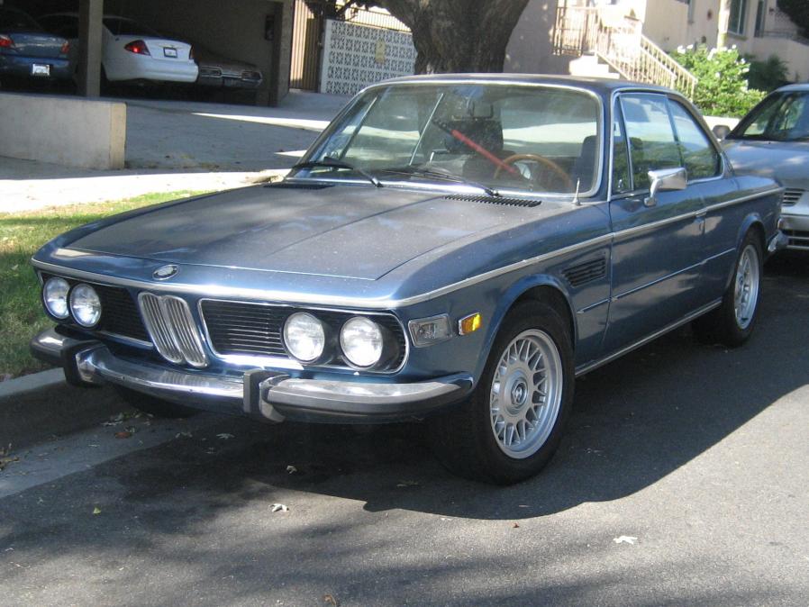

I finally had the time to test fit the wheels. The rears fit without issue although I would love to have had them out a bit more. The wheels I have now are from the 840ci and the fit is perfect where these E38 wheels don't sit out far enough. The 840ci wheels are 16x7.5 with +15 offset. Maybe a +18 offset with a 5mm spacer rather than the +23 would look better. The fronts without spacers rub the tires on the struts. I bought a cheap 8mm spacer from Pep Boys to test fit and the tire cleared the strut but was still too close for comfort. With a 10mm spacer it should fit perfectly. The studs were definitly too short for comfort. They are 25mm in length. If I can find 35mm it would be perfect. Are all the press in studs universal or vehicle specific? Can anyone lead me to a supplier for them with the correct width, thread and pitch or give me the specs. so I can search for them?
my old 840ci Wheels
