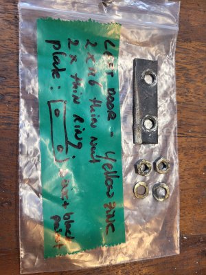

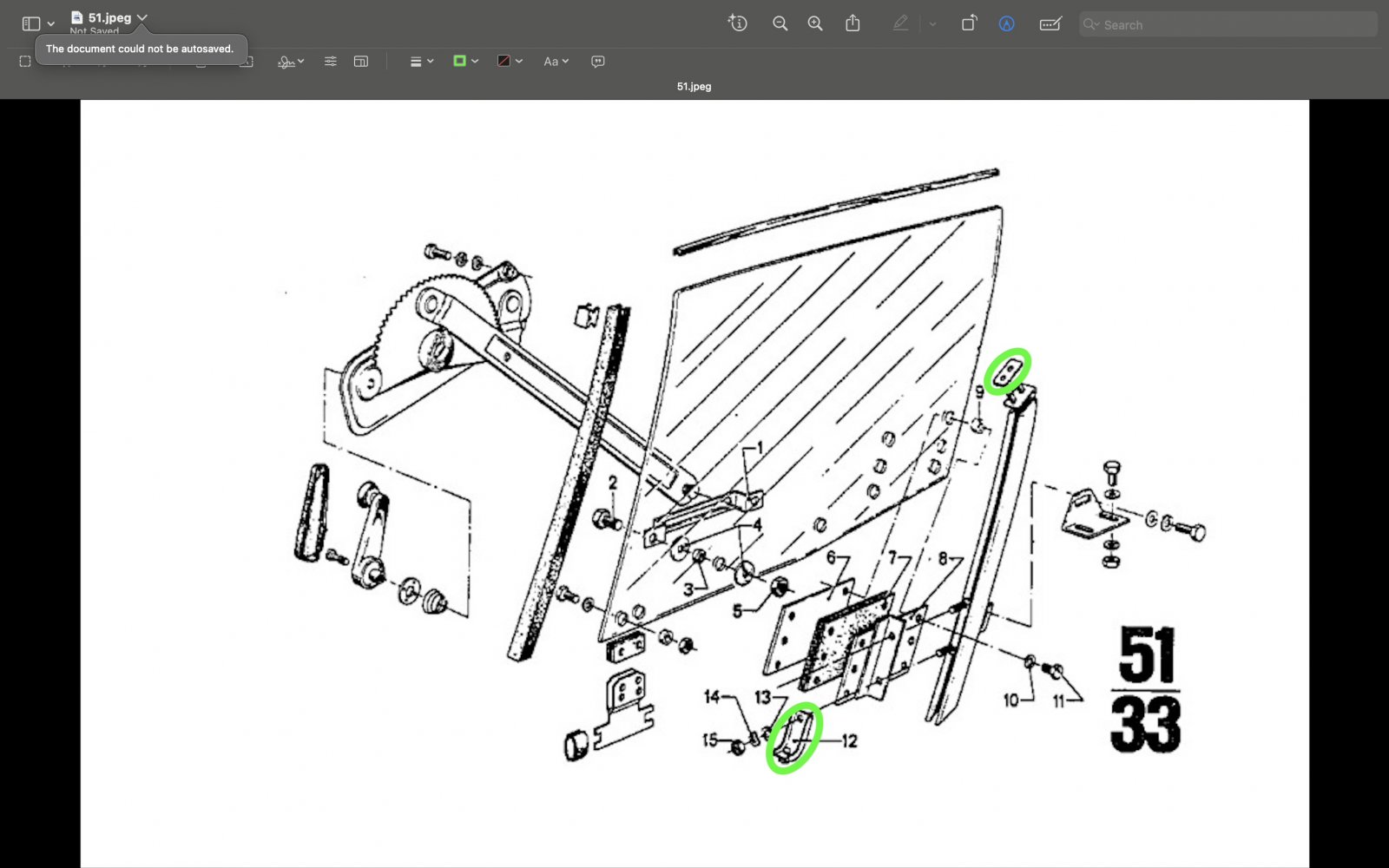

Hello,
Looking for a missing bits (marked green)
part numbers:
51 32 6 746 102 / 51 32 6 746 103 - stop lower
51 32 6 754 267 - spacer (where it should be installed? Underneath the door panel or on top to work like a washer for rail nuts?)
Maybe anybody have them?

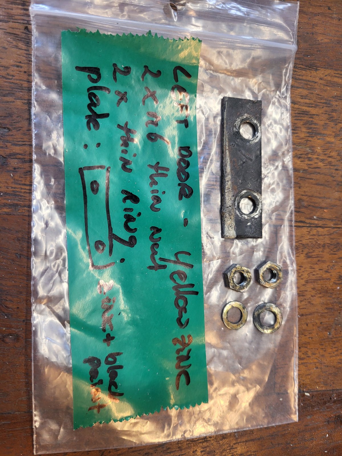

bavbob is right - upper one is just 1mm sqaure washer, you can make it by your own even from scrap metal or stainless.
Lower one is hokey style bumper & is more complicated
I can measure the top part for you - easier made by yourself then purchased somewhere.
Even just an extra washer will work.

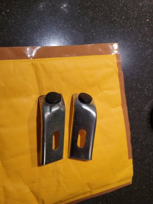

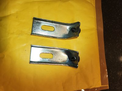

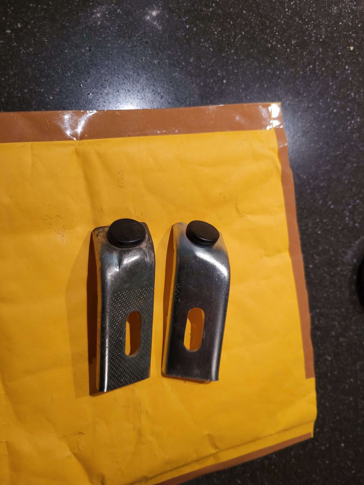

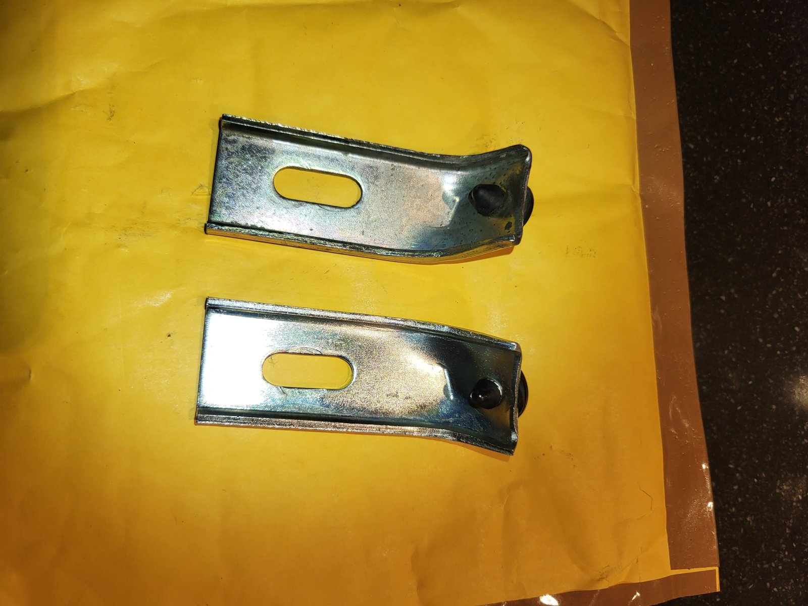

The bottom parts are unique L and R. I only have a picture for you for reference, as I have also just sourced these parts through the forum.

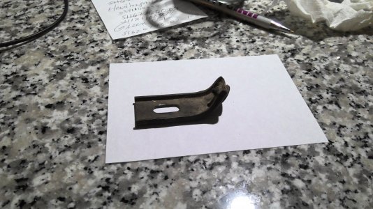

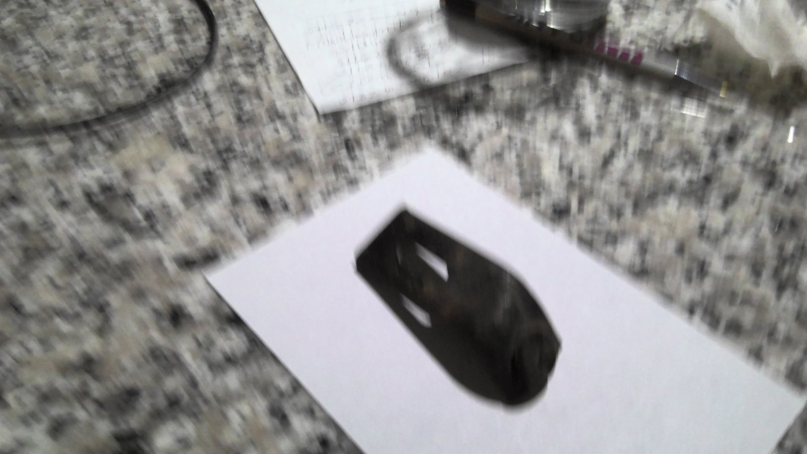

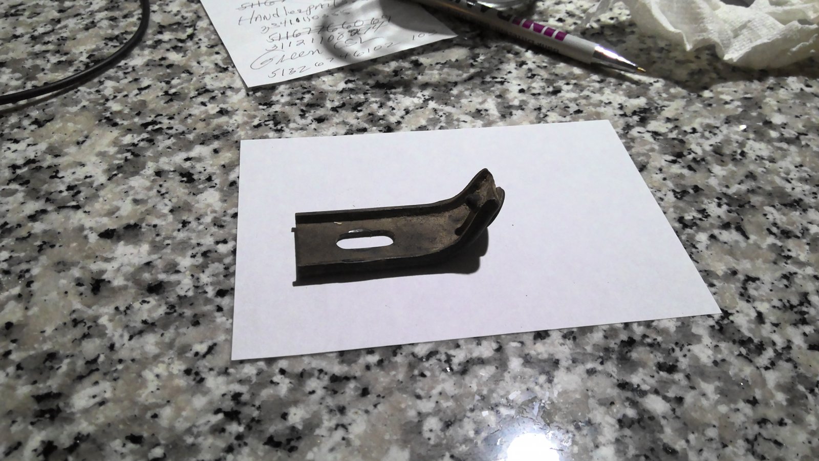

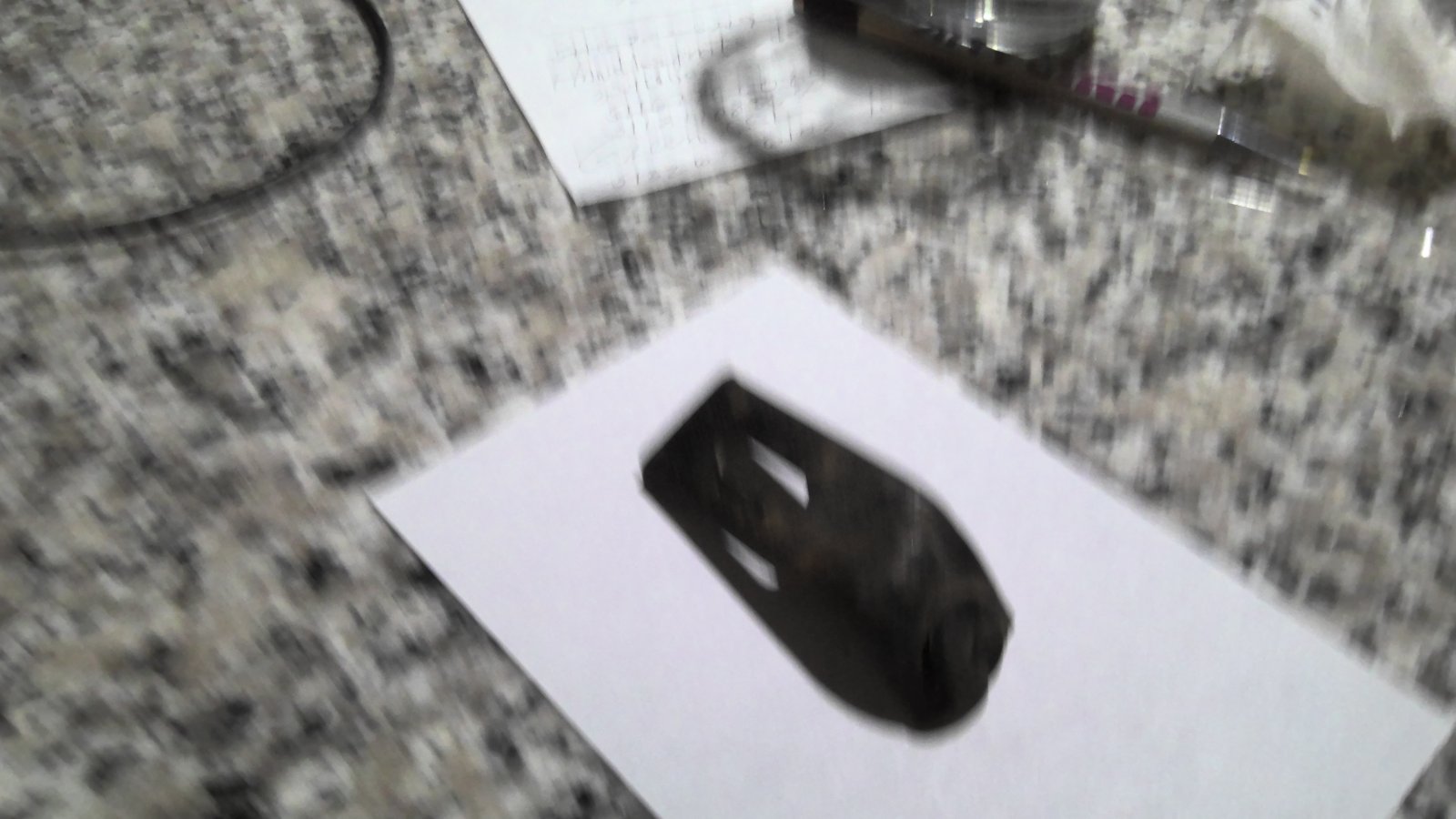

I’m looking this weekend
I think this is the part you need but not positive. I only have one and not sure what side it is for.

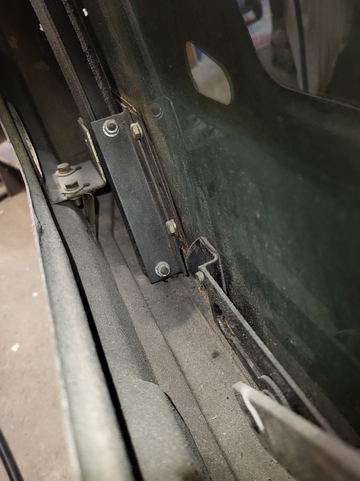

It think the part that Koopman shown is correct for you. The bracket has an angle at the bottom, so that it follows the door bottom guiding the water to the drainholes in the outer skin edge.
Meaning that Koopman's part is a left hand side, driver's door in LHD countries.
Below a picture of where it should be mounted; this is the left, driver's door on my car. It's supposed to be on the bottom of the black bracket, under the M6 nut.
