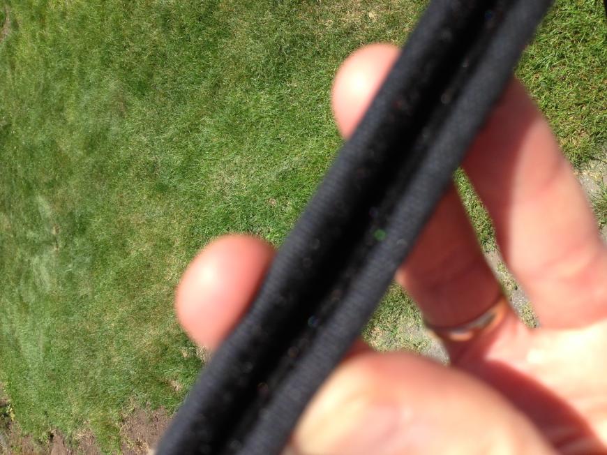

Ordered from BMW about a month ago. $42 per meter IIRC
Just for reference if anyone is buying this.
