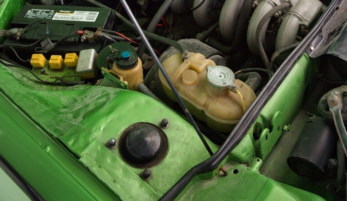

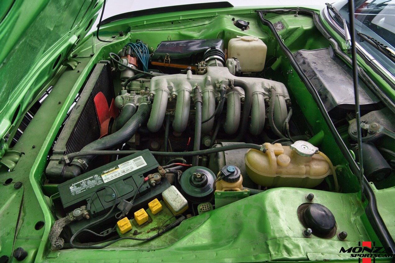

overall a decent looking car, but the drivers side inner fender ??

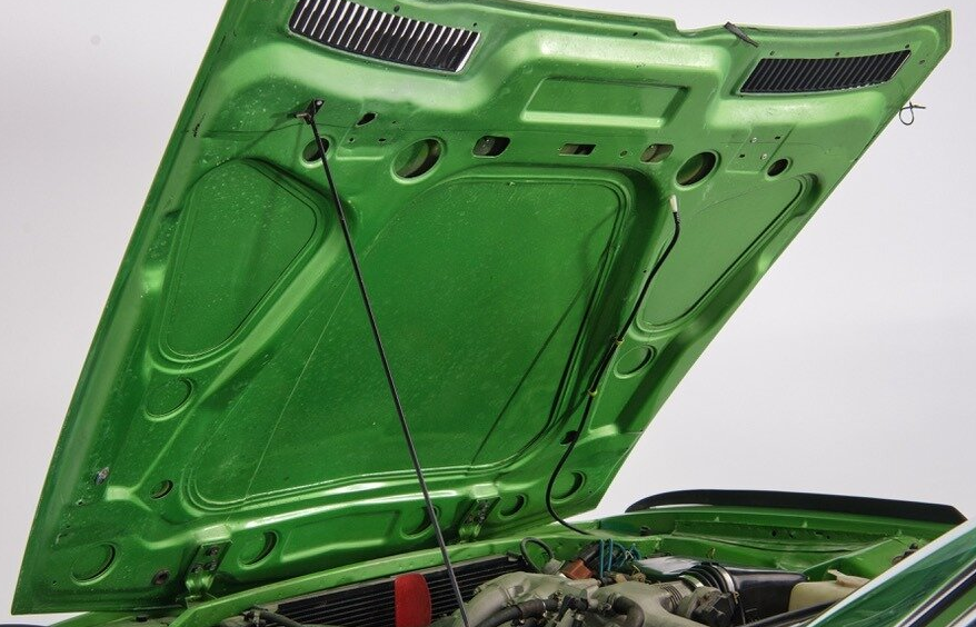

its another created lightweight with the hood latch brackets and the prop rod and the hood latch mount locations on the back of the hood.

Love the “Factory Air Conditioning “

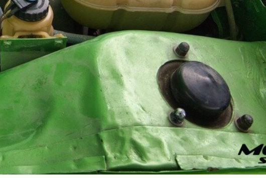

Did they smack the left strut tower with a hammer to lower the top leading edge to avoid it coming into conflict with a closed hood?
Especially the largest bump ( with the darkest green shadow, on the bottom edge of the pic ) shows it bulging out towards the left (outside) of the vehicle. Meaning the blow must have come from the top.
I just can't make up any other mechanism that could have produced these funny bumps, while still showing original spotwelds on the inner fenders.
It doesn't look to me as if it's been hit from the side to create those bumps.
