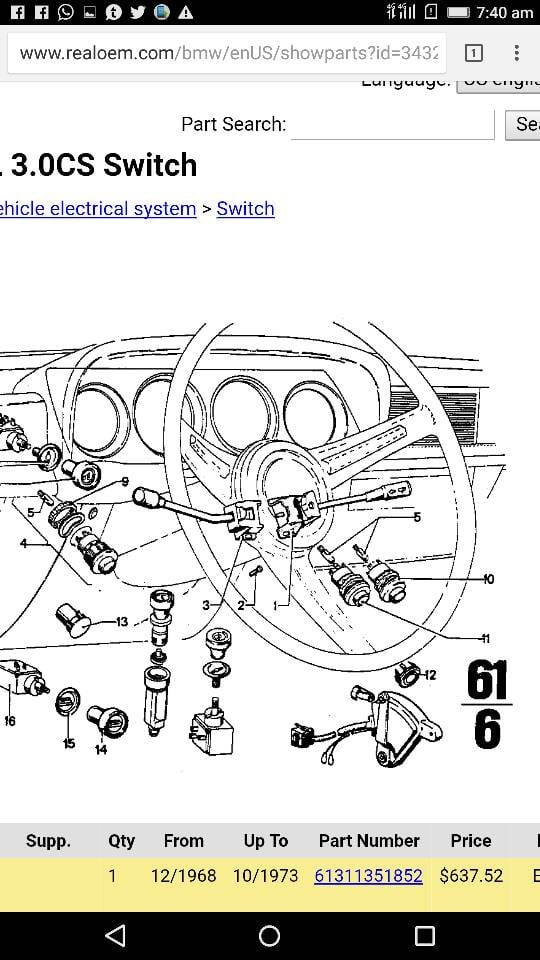

No Chris, it's 100% new and never used, the original plastic broken for its ageDicky,

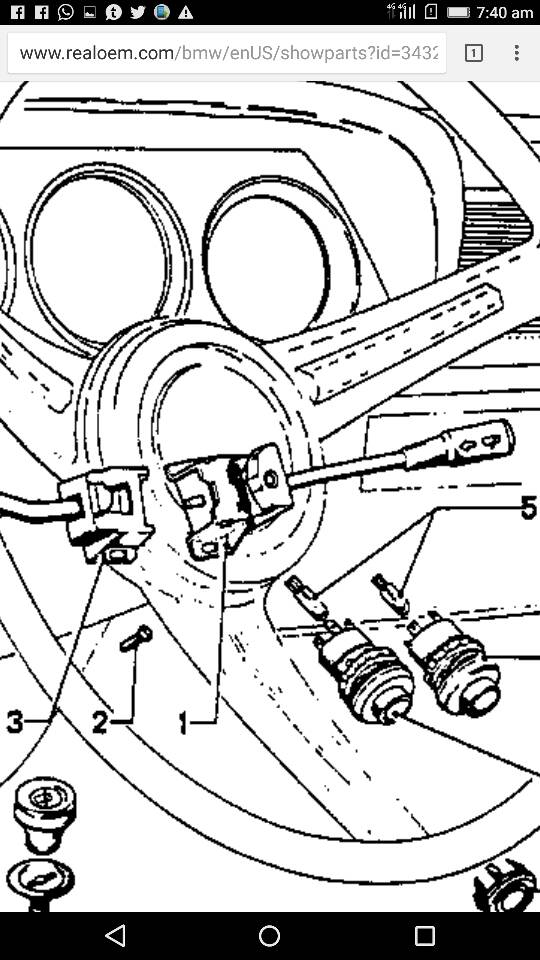

Every e9 column switch I have ever seen has a larger knob with a flat end, this one is like a slender bullet. You have posted the e9 part number however. I assume this is used?
Chris, you right, I think mine is for early 2002, based on realoem, they have different button (bullet style) each other with e9.Anyone with a pic of a 74 lever left side turn/dip lever? That bullet style knob is early 2002/NK style which is strange to me.
I just checked my 69US NK wiring diagram, it has a six pin plug with a separate grey wire just like yours, also two grey wires in the plug. The e9 has an 8 pin connector with a separate grey wire, 9 in total. This one is not e9.
I think I am wrong.'74 lever does NOT have that type of knob. as i remember, the pre '74 turn signal switch has a much different plug on the wiring harness. the '74 has that type of plug ... but i thought it had 8 or 10 wires. i will confess, its been a few months since i have looked at the plugs. i have a vague recollection that the pre '74 has a 9 pin in one connector (similar to one of the gauge cluster plugs)
