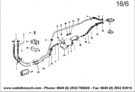

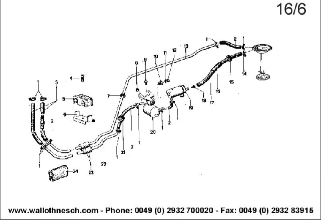

I only know about my e9 lhd, so Indeed yours may be different.
But the diagram that bmw made of it it seems to indicate a similar route:

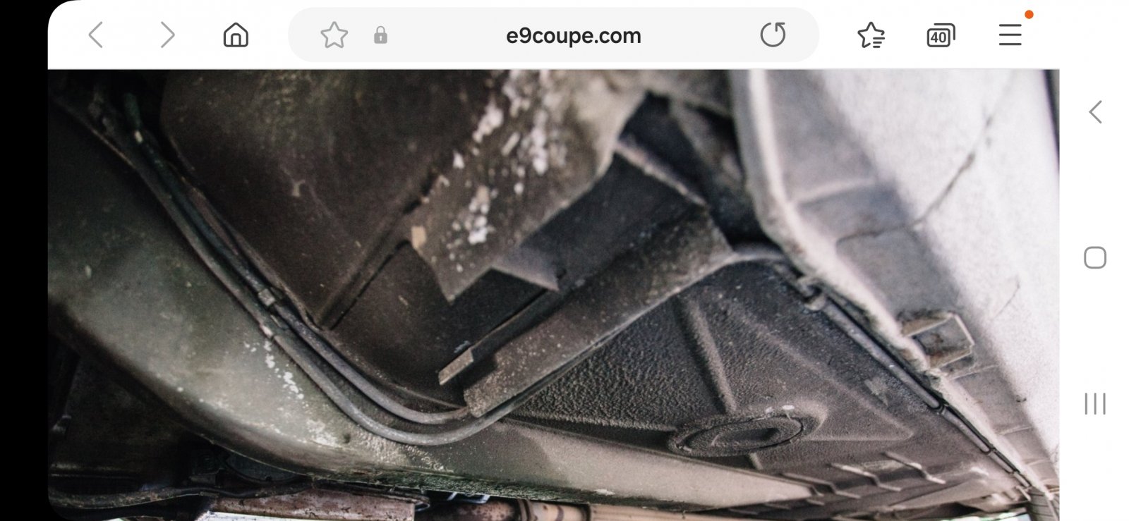

In my car there is a steel pipe that , on the engine side dives into the corner of firewall/inner fender/frame rails. It then reappears in the wheel well where it bends down, past the side of the frame rails and then again it bends under the floor.
Here's a pic of an e3 that i could find on the forum:

And it's thread with some moreninfo and partnumbers: https://e9coupe.com/forum/threads/fuel-return-line.28501/
Does this help?

Thanks but it is just getting to the connection between the flexible and steel line that I'm struggling with, I can't even see where they connect to even have a go at disconnecting and replacing the hose. Presumably it's connected at the factory before anything else is in the engine bay. Also with RHD there are two brake servos making it even more difficult to see what's going on.
