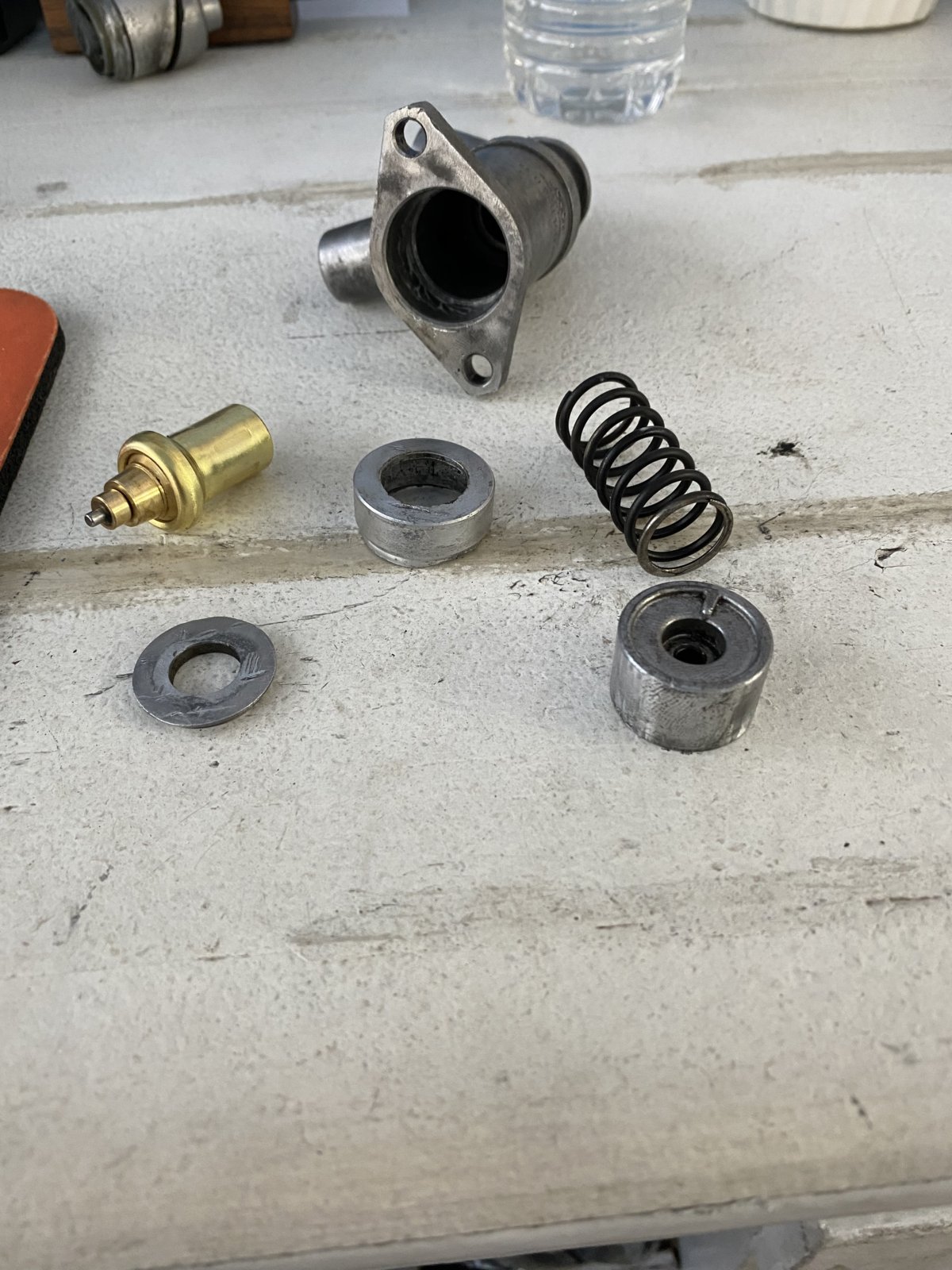

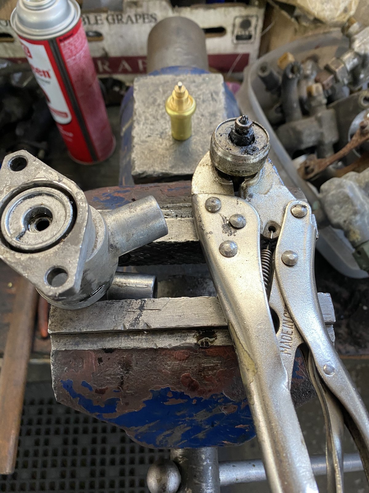

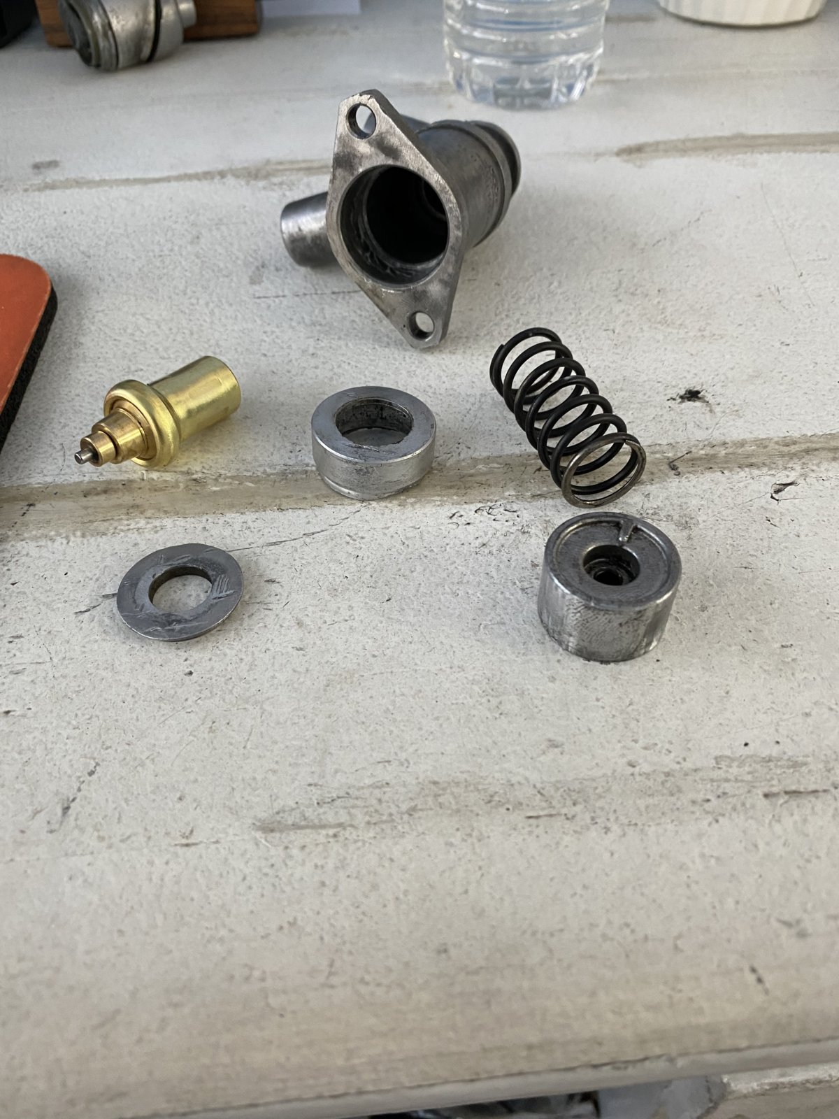

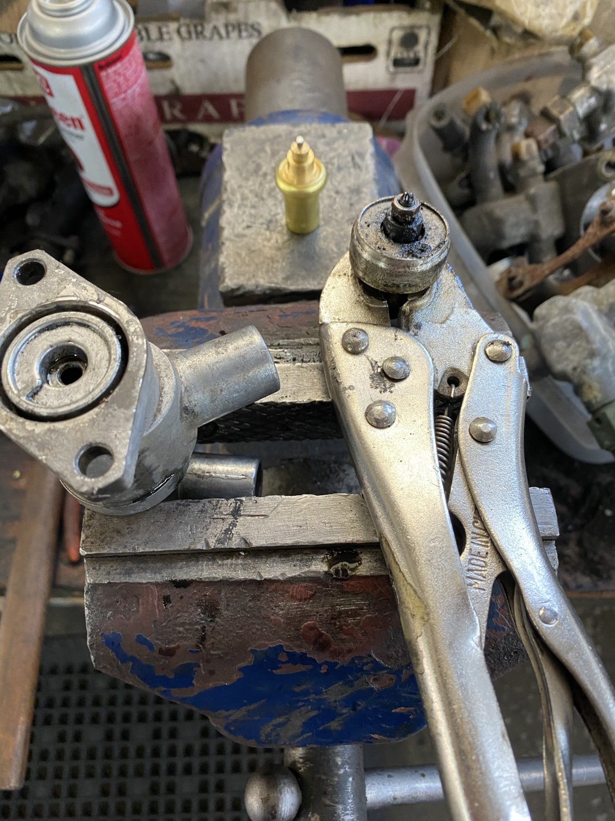

We are rebuilding AAV’s at the shop again….
LMK
Disassembled ….
