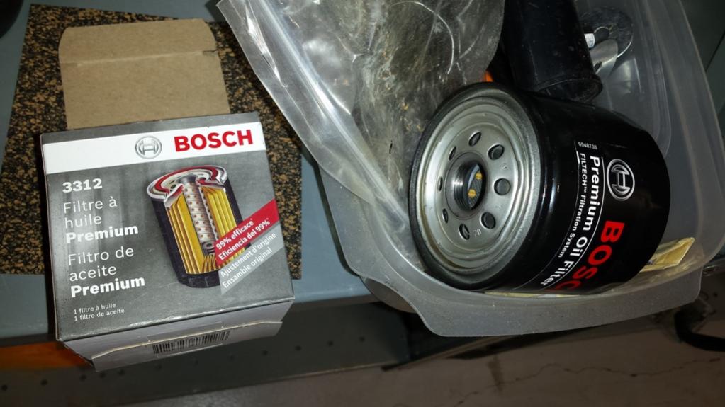

Hi Chris, if you take the sender out the gasket is probably shot. I just fixed mine with the gasket from a Volvo V70 spin on oil filter. I said I would post the exact filter (with a picture) in my thread but I'm a bum and didn't. You need to put a small film of oil on the gasket because it is a little thicker than the original but it seals much better. You should not need a new sender if I'm reading your problem correctly. Could have used that light when you came to get the car :-)

Hi Chris, this is the one I used, available from O'reily/autozone, Advance, etc. It should fit snugly around the "inner" diameter, but leaves a little space on the outer side, in other words, it is not an "exact fit", but as long as it is tight on the inside it will seal and since it is thicker you will need a very thin film of oil to get it on there but it will fit well and completely stop fuel from leaking.
Good luck :-)
