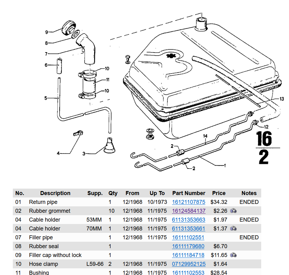

I am resurrecting this thread as I need to obtain and install a fuel line as part of my winter projects. The original line was gone when I acquired the car, and a rubber line is presently running up the drive shaft tunnel.
I attempted to order a new one, but have been told that the original BMW line is no longer available.
Do we now make our own? Is there a source for clips or were those made a part of the body or floor? Any pictures of the routing would be very helpful.
If you look up a 74 e9 BMW may still have the return line, it can easily be modified for use. It exits the forward side of spare tire well, goes to the driver rocker, clips under the rocker with tabs, turns 90 degrees at rear of front wheel well, turns 90 degrees and goes up frame rail to just inside the inner fender, fuel hose after that.
