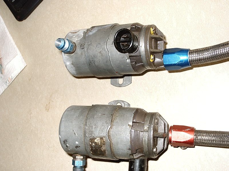

Injected, has a electric pump :
Carburator, has a mechanic pump:

Mine was not working when I got my car. I took it apart and cleaned everything inside. I carefully reassembled it (watch the rubber o ring) and it works fine. There is supposed to be a fine screen that fits in the inlet and mine does not have one.
The Bosch part # 0 580 960 007 . Djet was used on VWs and 914 Porsches and should have the same pump. Try using the Bosch part number in some of the parts suppliers search engines.
alternative fuel pump
A viable alternative to Bosch pumps is an American made pump manufactured by MSD and the part# is 2225, these are available thru Jeg's or Summit for just over $100 and that includes shipping. I was turned on to these by another board member and we are both using them on our M5 powered coupes, they also come with nice mounting brackets. Best of Luck, Leroy

If you have no pressure or the pump is dead silent, examine the pump. Make sure it is getting 12volts (sometimes the wiring is suspect). If you are getting 12Volts and do not have a substitute pump, You can whack the pump with and try to unfreeze the mechanism or remove it, put it on a bench, drench it with a light lubricant or penetrating oil and it it with a 12V source again. You may be surprised that it springs back to life.
If you really need a replacement pump, there are plenty to choose from although you may have to modify the electrical connections, especially if you opt for a newer model.

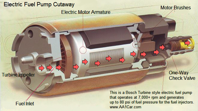

See fig 2.5 and 2.7 below:

My pump is electric from the manual in the link "no service is possible for the pump". From what I can tell it's also impossible to disassemble without destroying the pump. Think I can try putting penetrating oil thru it and see if it comes back to life. Otherwise a replacement...just not the $650 type :-D
