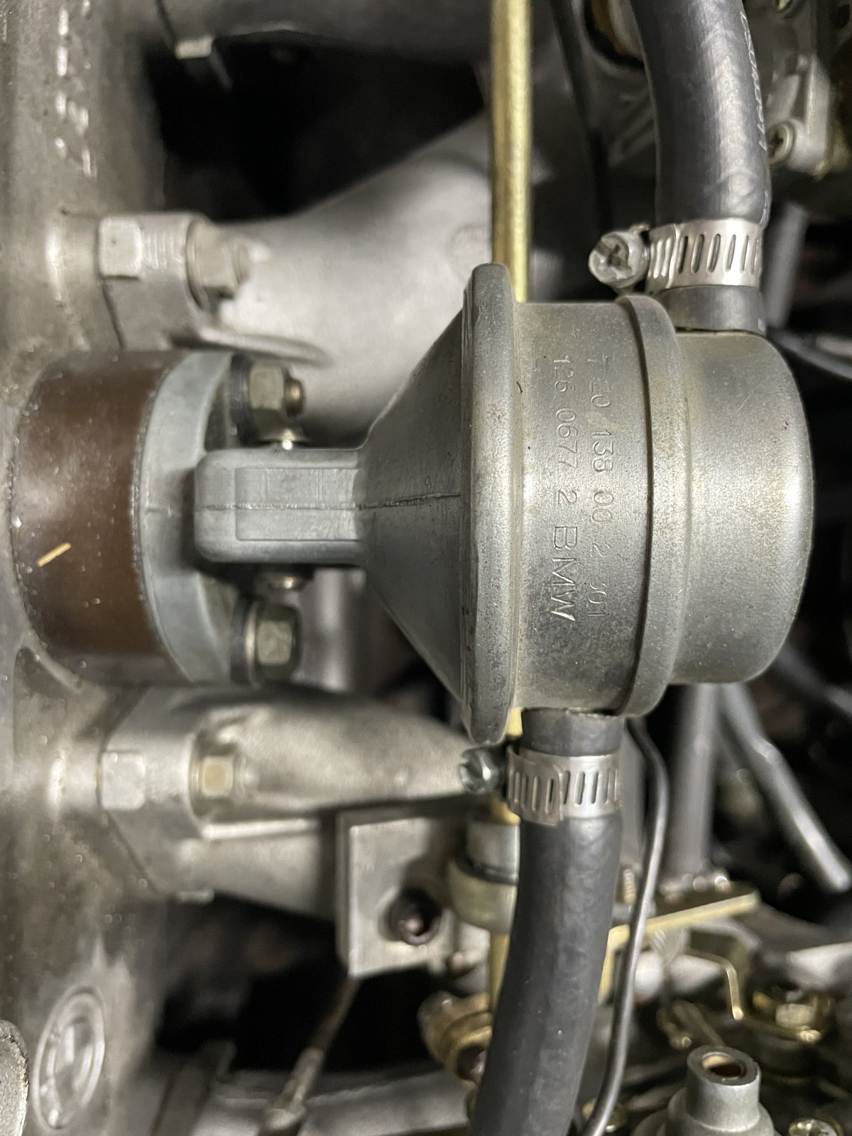

I have some more testing to do but I may need to replace my fuel pump (1972 Bavaria 3.0)
My current one looks like this...

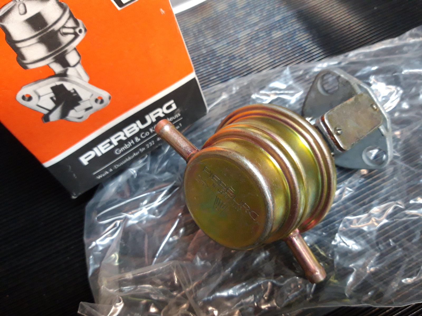

The Pierburgs I see for sale look like this...
Is my pump an original or something else?
Is the pump pictured that I see for sale the only (best?) pump available?

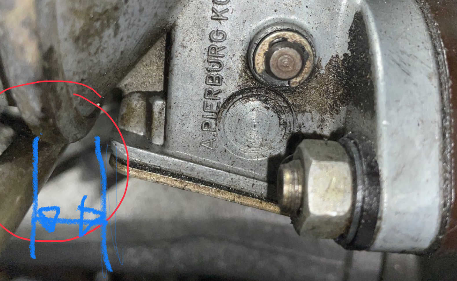

I have Weber 38/38 carbs. I have read somewhere that the Weber throttle linkage interferes with some Pierburg pumps. True? My pump clears the throttle linkage by a miniscule amount.

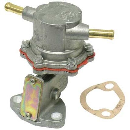

Recommendations if I need to replace my pump? (it does not look like it is serviceable as opposed the the pump in the last picture)

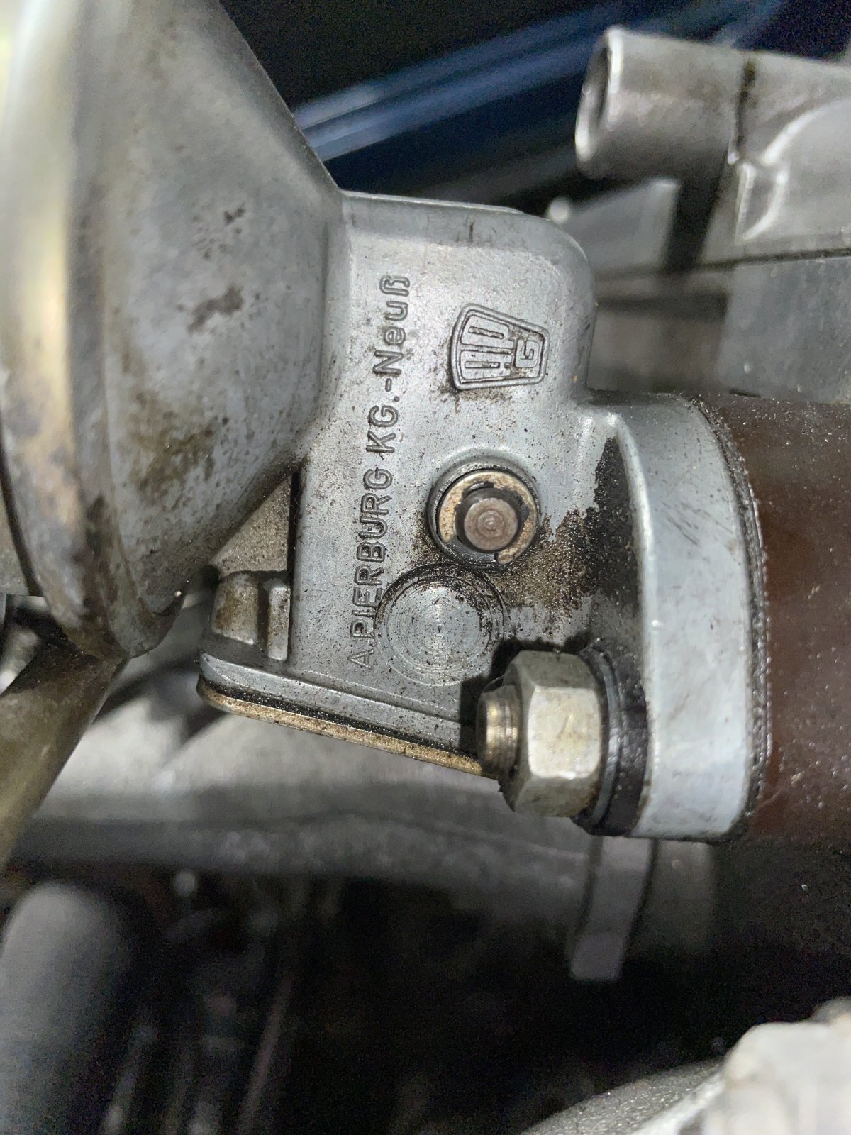

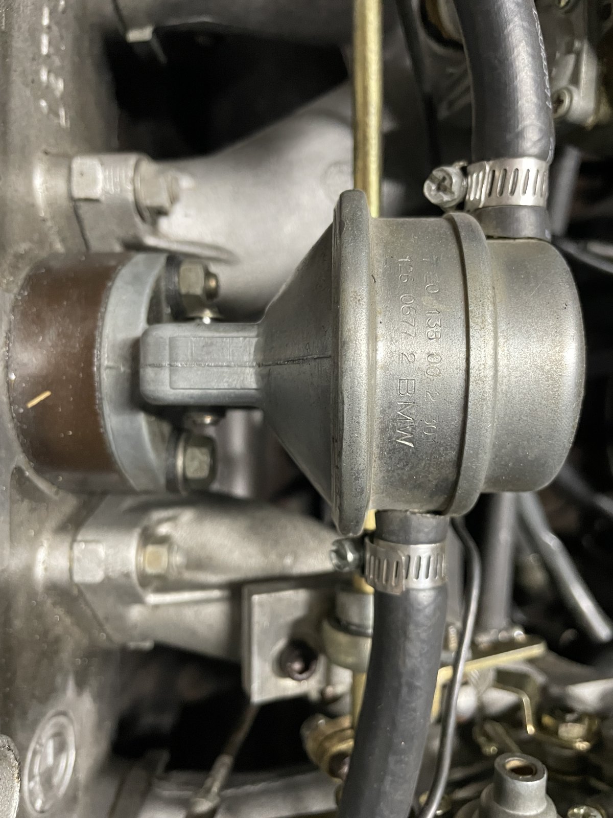

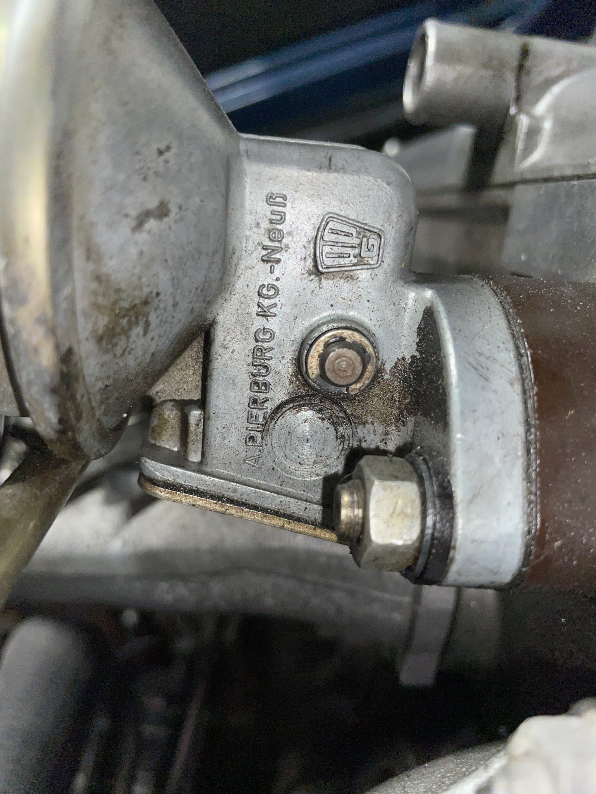

View attachment 164597View attachment 164596

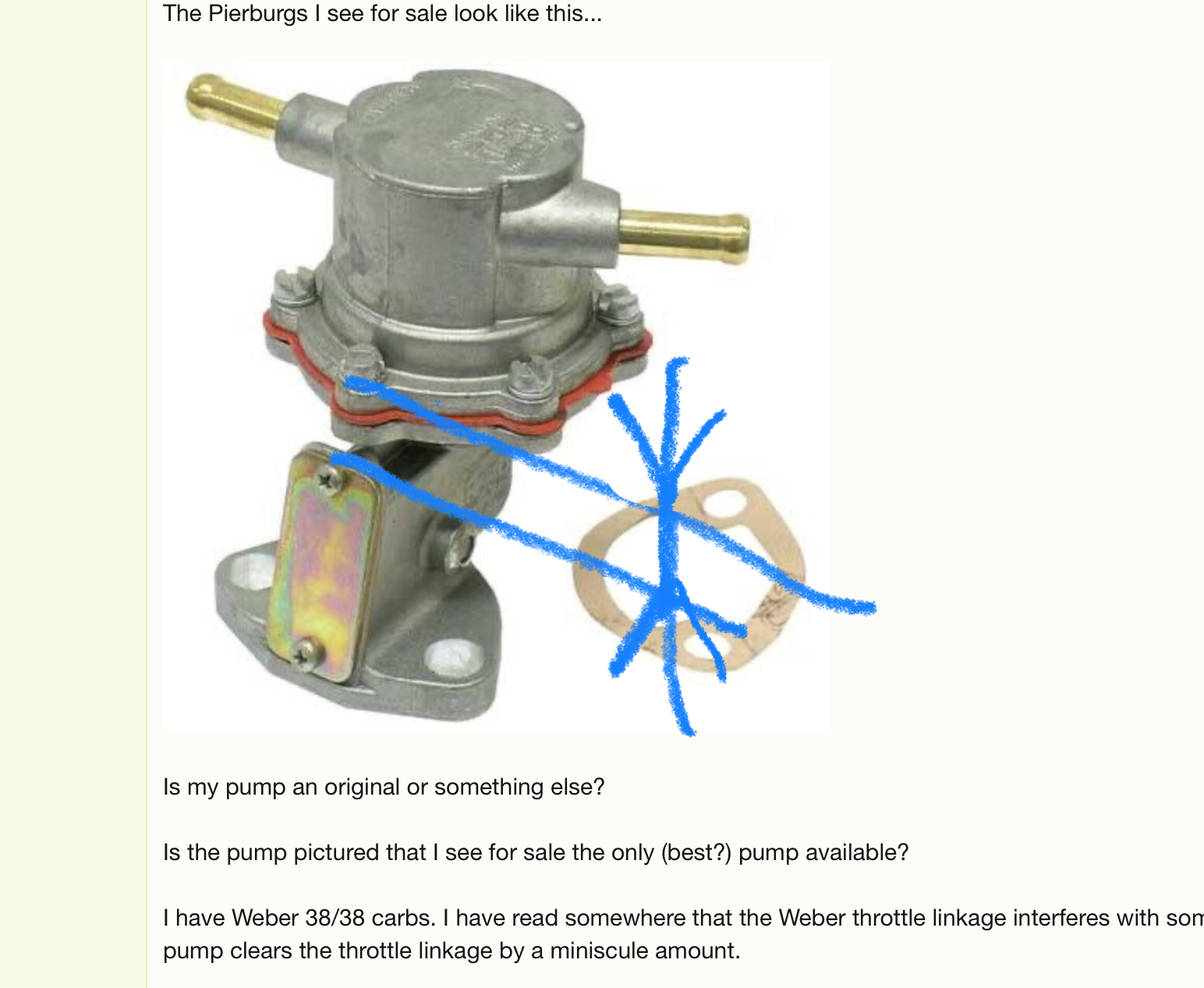

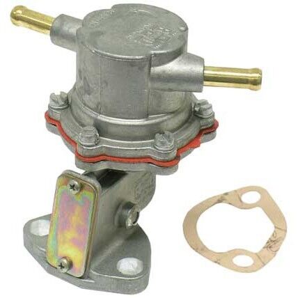

hi, mech pumps offer 0,21 to 0,25 bar pressure
check if this is what webers require
your pump is one of the original types, it seems a sealed one with metal membrane, yes, and i can see how tight is the linkage rod
the one you pictured is rubber membrane based, usually sold as pierburg, but really an Italian brand that is erased from the aluminium body
based on your setup you will have interference issues with this pump for sure,
I just installed the newer Pierburg to replace a pump same as @Dick Steinkamp had.
With the dual Webers, it will interfere with the linkage and per a comment on the forum I had to grind a little material off the new pump to clear the linkage.

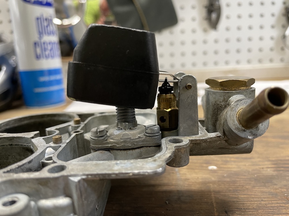

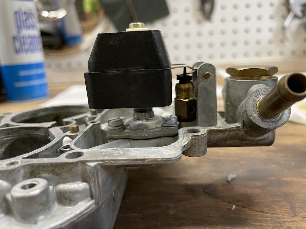

I pulled the tops off the carbs (Weber 38 DGASM) and found this...
Front carb...
Rear carb...
The little spring loaded ball bearing in the rear carb needle had frozen in the up position. This has the effect of extending the needle by about a centimeter which lowers the gas in the float bowl substantially. It also only allows the needle to drop about a centimeter instead of the desired 2 cm. So the float bowl did not have much gas in it at any time AND filled slower than normal. Neither the mechanical pump nor the electric could keep the gas level over the jets in the bottom of the bowl at full throttle. At least this is my theory. Waiting on a new needle and seat to reassemble the carbs.
