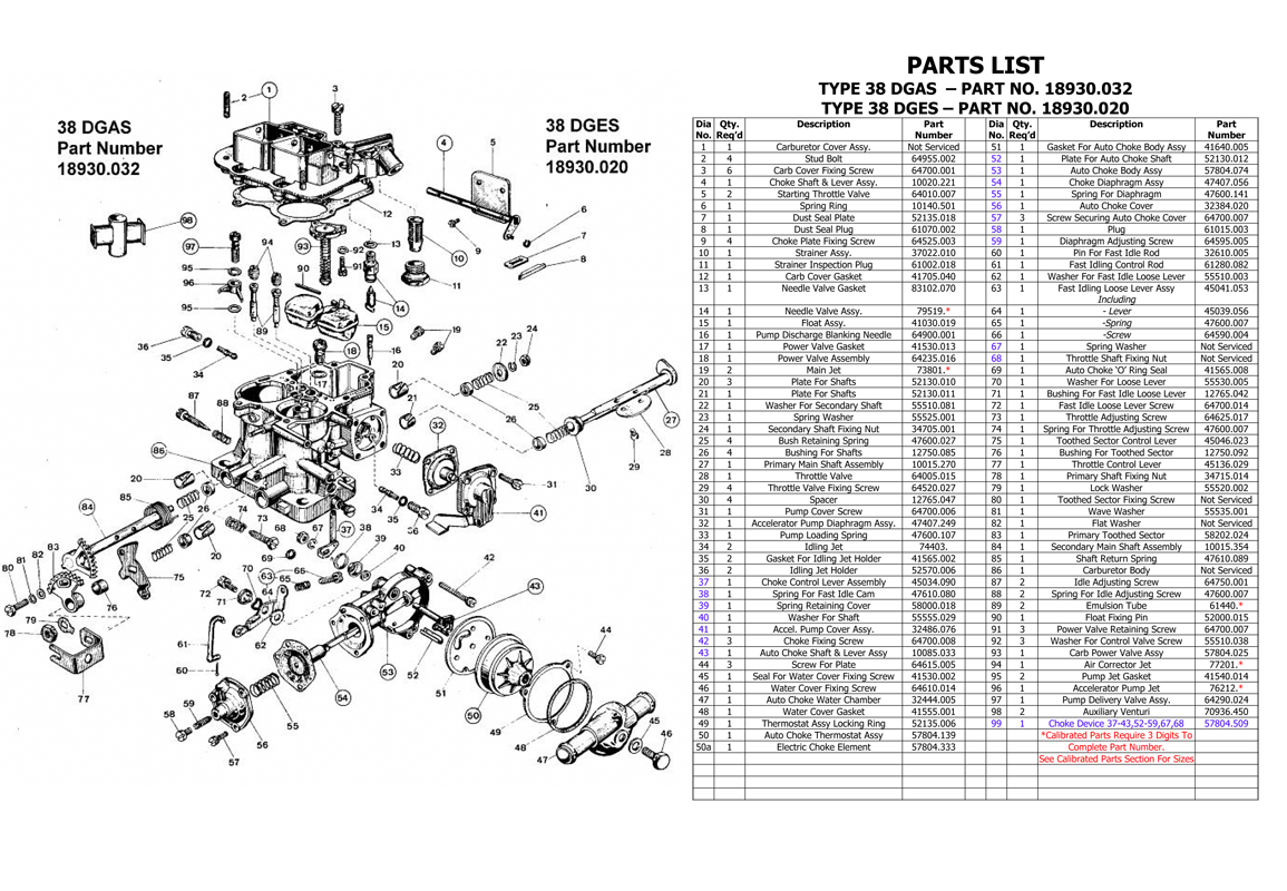

Thanks for the comments MM.
Yep, they are the idle jets (part #34) - still learning the pieces and parts of the carbs.
The idle jets fit perfectly into the ends of the solenoids and by design, if the solenoid plungers retract as they appear to on the bench test, they should not be limiting the proper function of the jets.
The idle jets have all holes visible (including the hole in the tip) so I dont think there is any damage to them or problems otherwise.
I guess I am just wondering if anybody else had experienced challenges with the solenoids or had to change the idle jet size to accomodate their function.

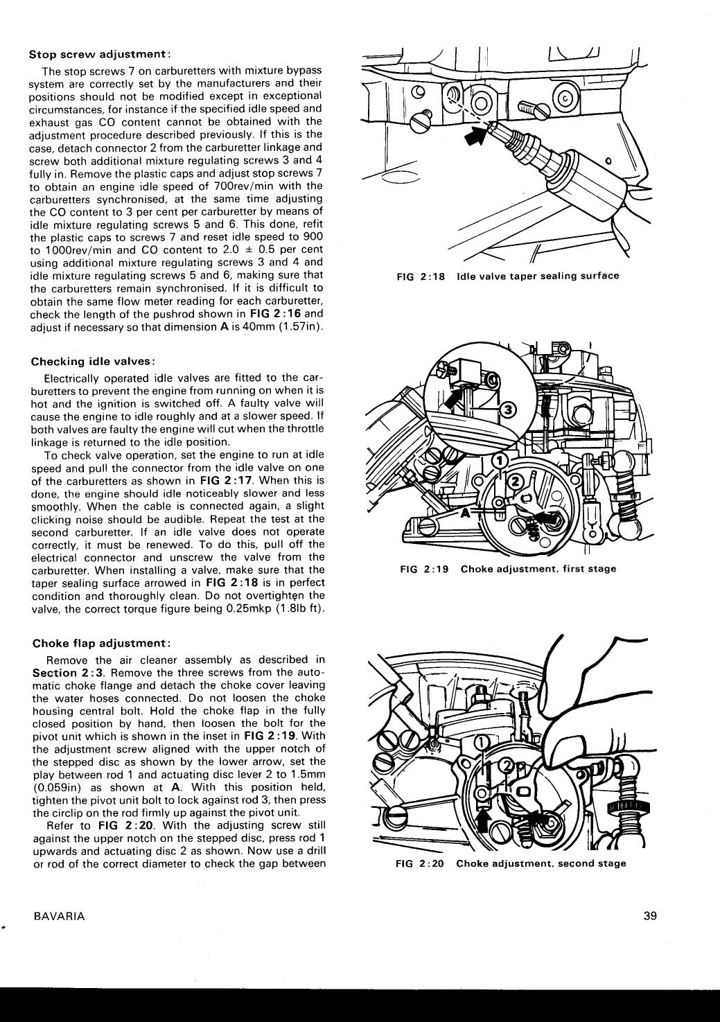

The following may be for Zenith carbs, but the advice is fairly fundamental and may offer more food for thought.
hth
