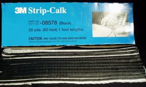

I can tell you what I used,
The correct material is the part # 16111117053 which is supplied by BMW. This is a foam weather strip with an adhesive backing. Unfortunately this material is the reason that so many tanks fail at the seems. The foam doesn't create a perfect seal and retains water which causes the tank to rust.
I used 3m Strip Caulk which is easy to work with and spreads out once you tighten down the bolts that hold the tank in place.
Make sure you have your charcoal canister hooked up and the plastic line from the tank neck to the canister is intact. This is a cause of gas smell in the cabin.
The ice shield is nothing more than the 3M strip caulk on steroids. I do love the strip caulk and use it on everything else....it's next to my bottle of Frank's Red Hot. Yea, the original BMW sponge was a major design flaw. I had to rebuild the entire trunk flange even before I put in a refurbished tank.

Thanks for your insights Bavbob and OCCoupe... yeah, the open-cell foam seemed like a bad idea to me when I last had the tank out (~1987???) and I went with some manner of solid rubber extrusion... the 3M caulk strip looks like a cool thang, will need to try that.
