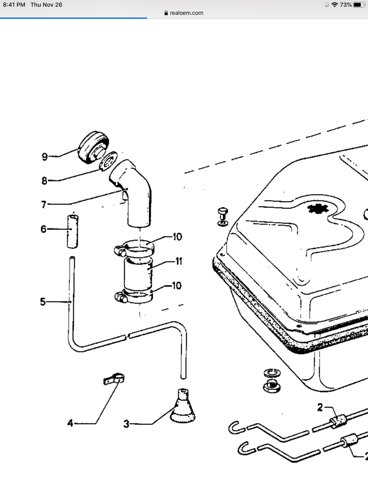

There’s no need for a vented cap. All tanks have a vent on the filler neck.

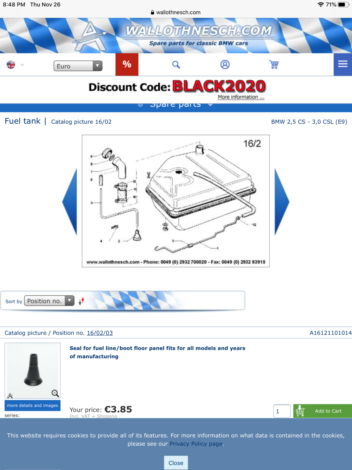

Erik has noted in Europe the tank vents to the back of the car.
looks like something i need to get. i may put the tank back in but i just assume run the hose out the bottom as the hose that ran to the front of the car is long gone.

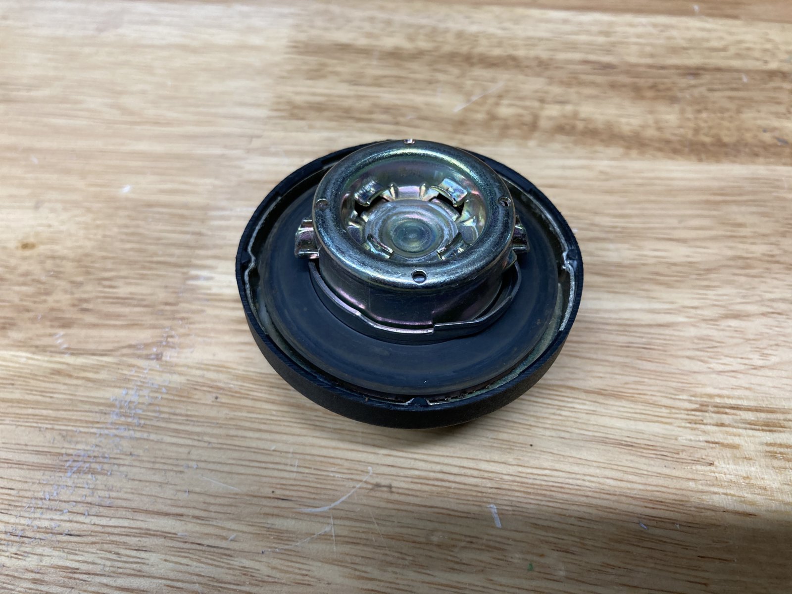

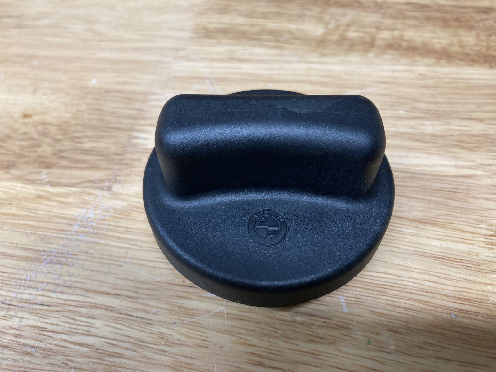

What does your gas cap look like?
Here are shots of the cap. After looking at the art Don sent, I just wonder if the vent pipe is disconnected or blocked. Won't be going into the shop on Monday, as snow is forecasted, and I'm sure the roads will be brined. Might poke around myself and see if I can find anything.

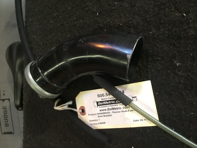

Belmetric has the hose

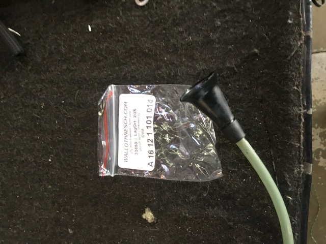

Walloth has the rubber fitting
your car has 10’ of the blue pipe
It starts at the tank and goes through the car, through the firewall and around to below the battery tray.
It's the evap hose on a USA car.
I believe your vent hose goes into the tank on the passenger side of the trunk wheel well. But if it is vented to the trunk bottom and you need the bell-shaped rubber fitting,let me know. I bought it from W&N thinking I needed it only to find otherwise. I still have a slight gas smell in my trunk when it's opened and I have checked everything.
