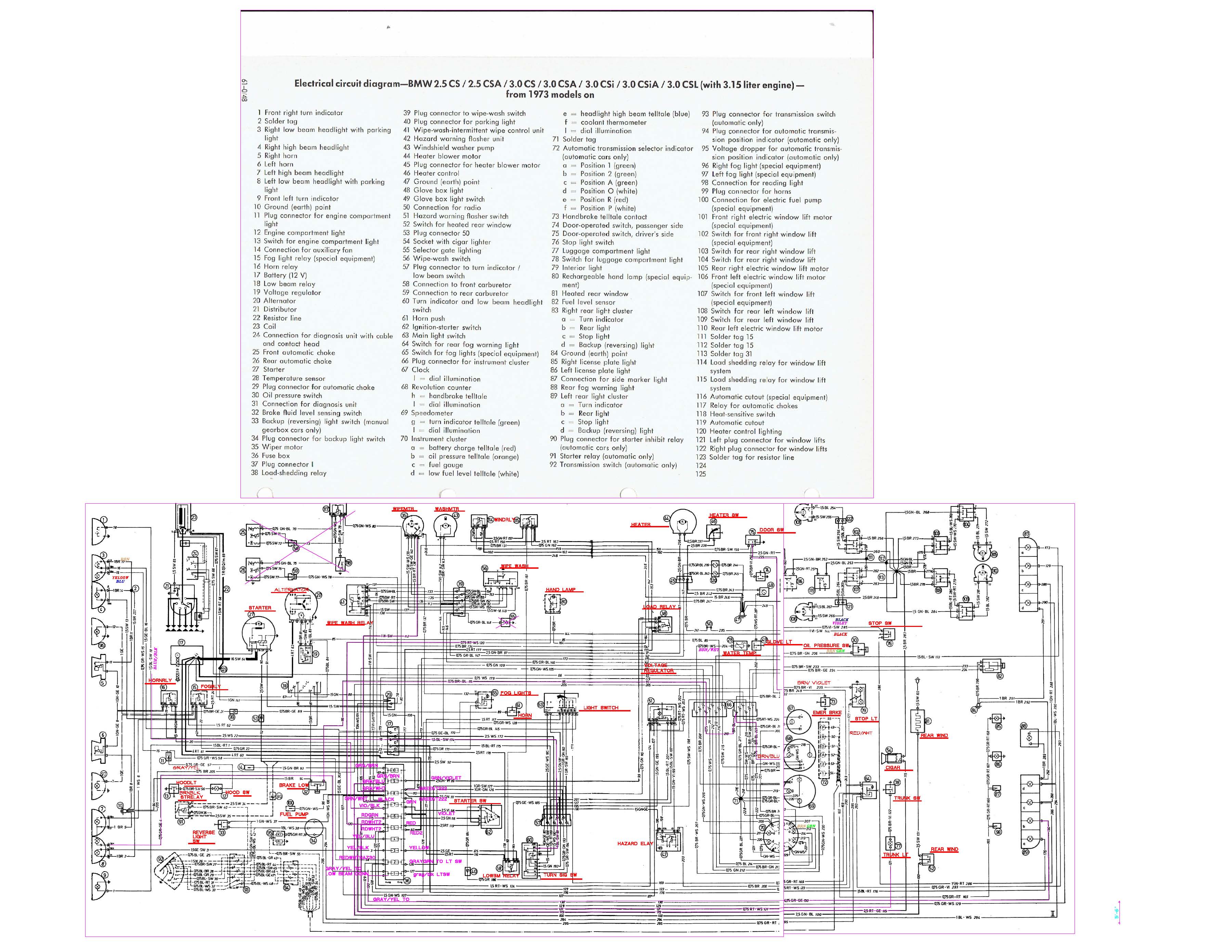

I am having some problems with windows on right side? They stoped working at same time (3 days after I cleaned and greased motors) so I would like to check fuses before removing door panels again...
MAYBE THIS WILL HELP
FROM THE 74
