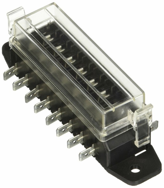

Yes, the Porsche-style holders have grub screws that attach to bare wire. For e9's a simpler (and cheaper) solution would be to use a universal Hella fuse holder like the one pictured below. These only cost ~$10 and come in different # fuse and terminal orientation configurations. Just don't let those pesky concours judges open your under-dash access door!
