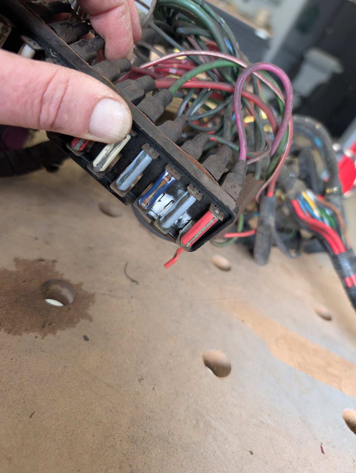

So says the electrical issue that went on with mine and the melted defroster vent that went with it. Not under my watch mind you and who knows what the heck the PO did to cause this.
There’s the reason the old style fuses were discontinued in modern automotive manufacturing.
